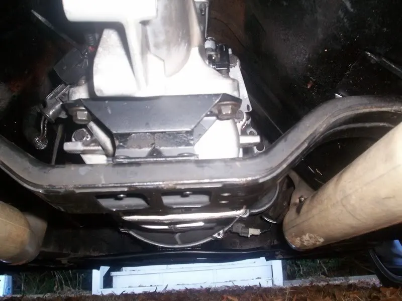

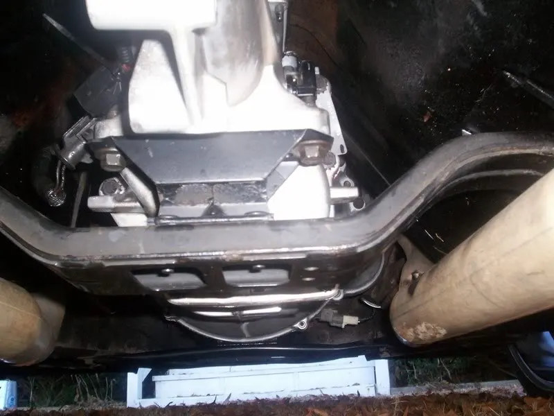

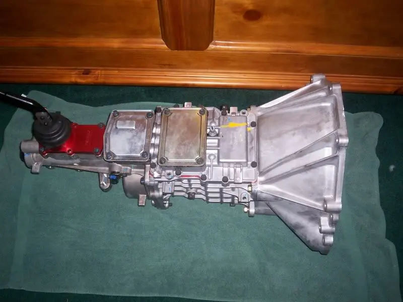

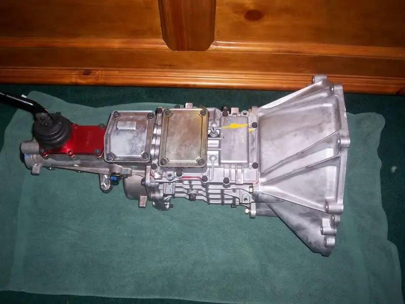

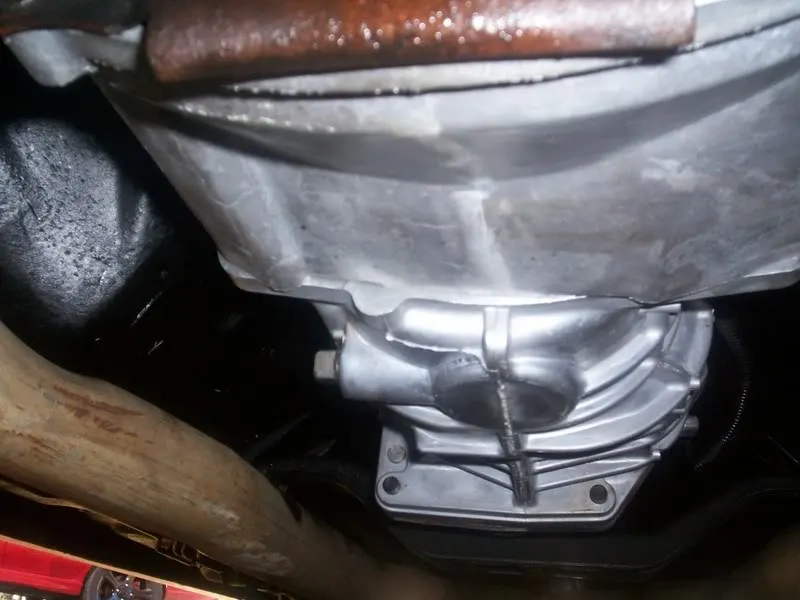

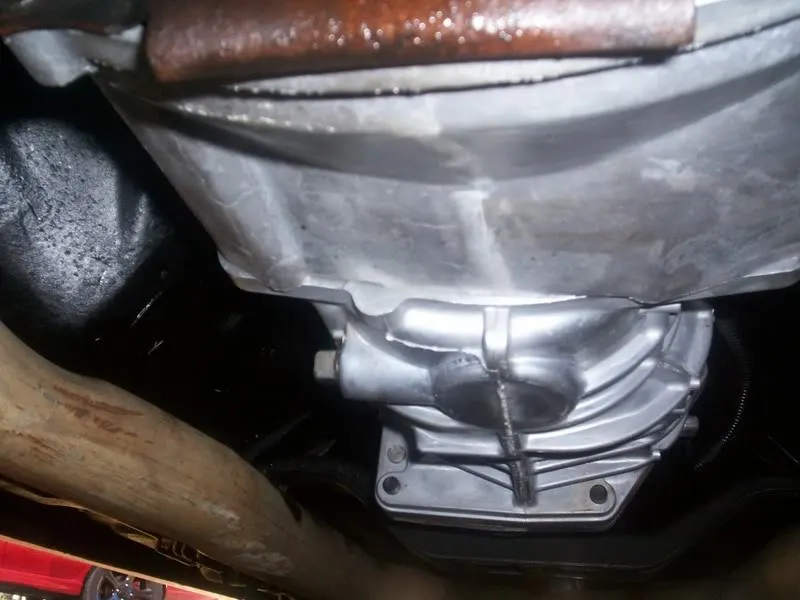

heres what you need i have seen some good prices on tko 500s on ebay... heres one click on link its at $1500 now at $2000 this is a good deal http://cgi.ebay.com/ebaymotors/Trem...4QQihZ010QQcategoryZ33733QQrdZ1QQcmdZViewItem
installed it last week....

I am running the tremec aluminium bellhousing. I wish I had the money for a Mcleod or something steel but for my power. The AL one is just fine. Your friends are pushing some serious power so for an SAE rated one indexing is very important.
Kevin
