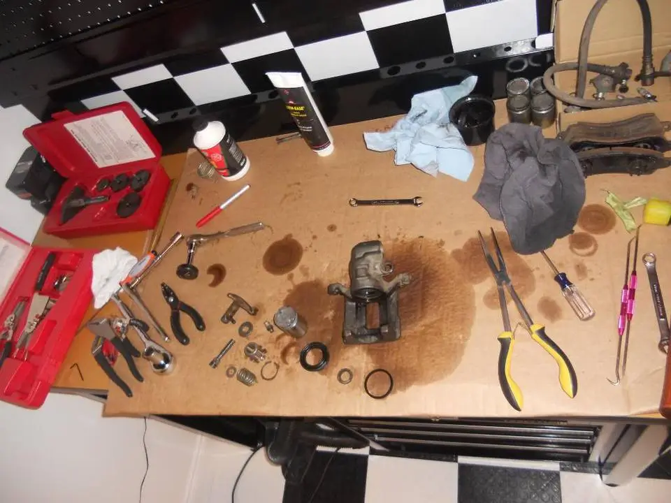

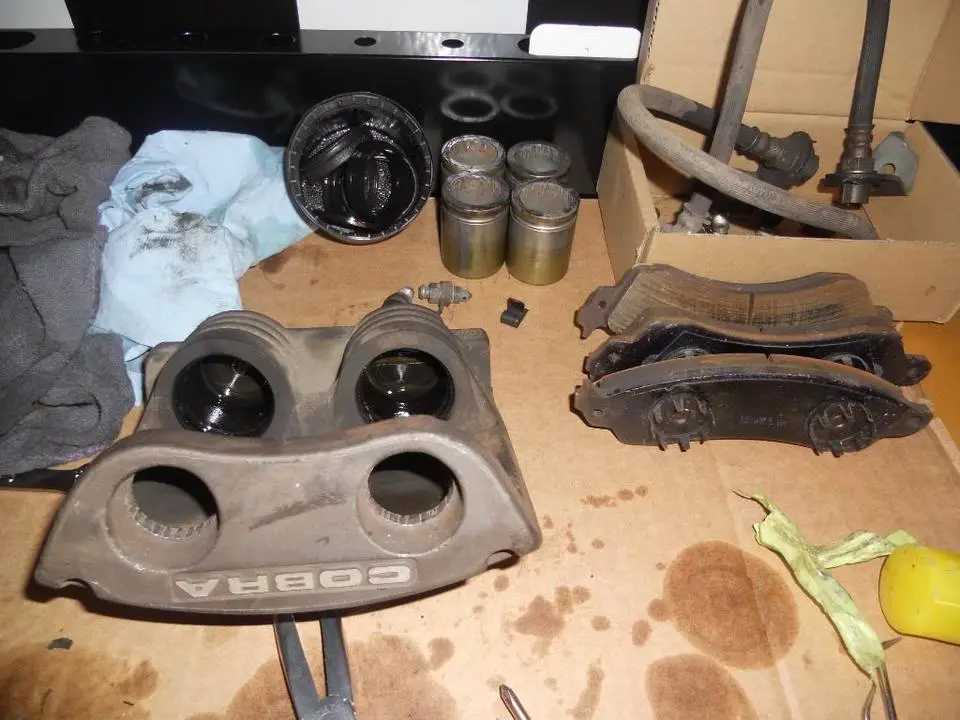

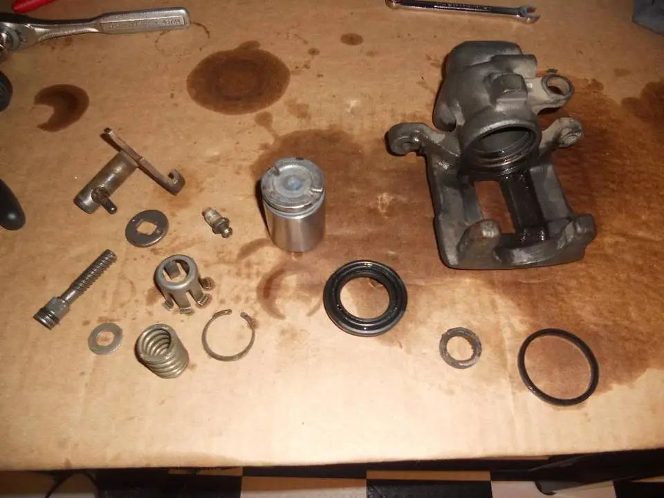

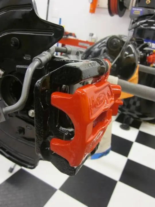

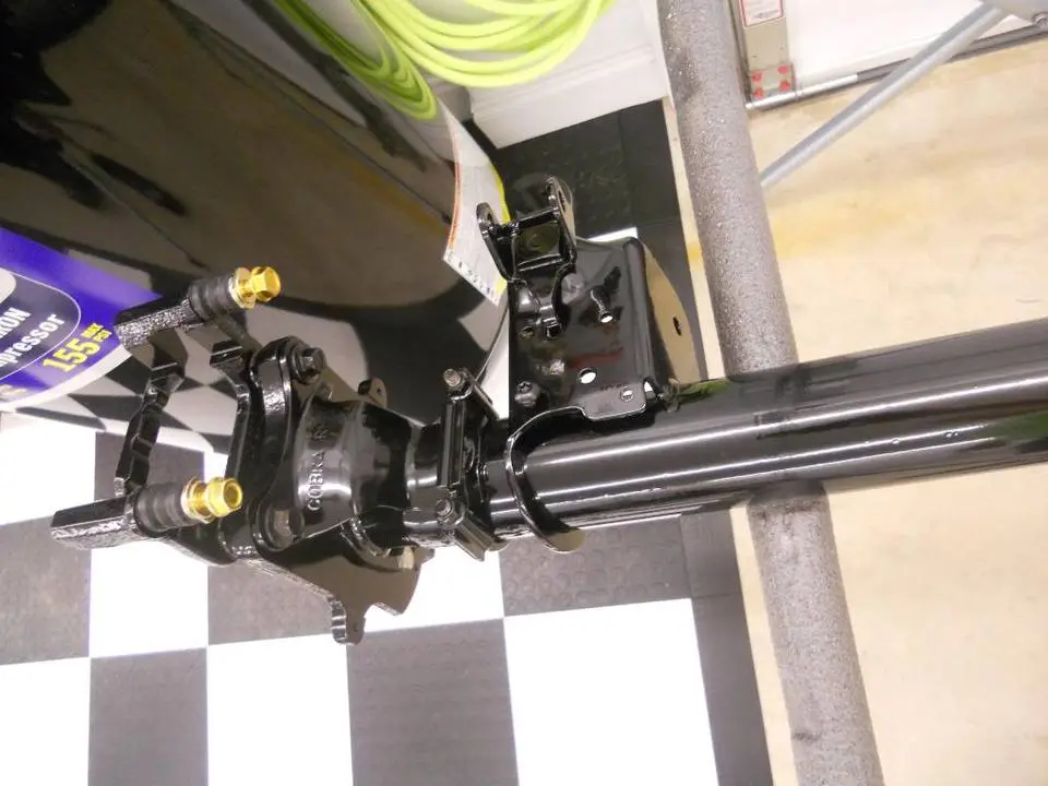

I started back on the 94 working on the brakes today. I disassembled the
front and rear cobra brakes in preparation of powder coating, rebuilding and replacing seals. Its hard to believe there are some many little parts making up the rears.
Fronts ready for blasting.

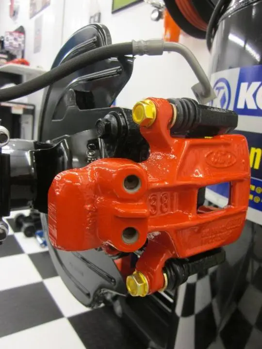

While I was at it, I went ahead and rebuilt the 10th anniversary calipers off my old car that I had powder coated a couple months ago.

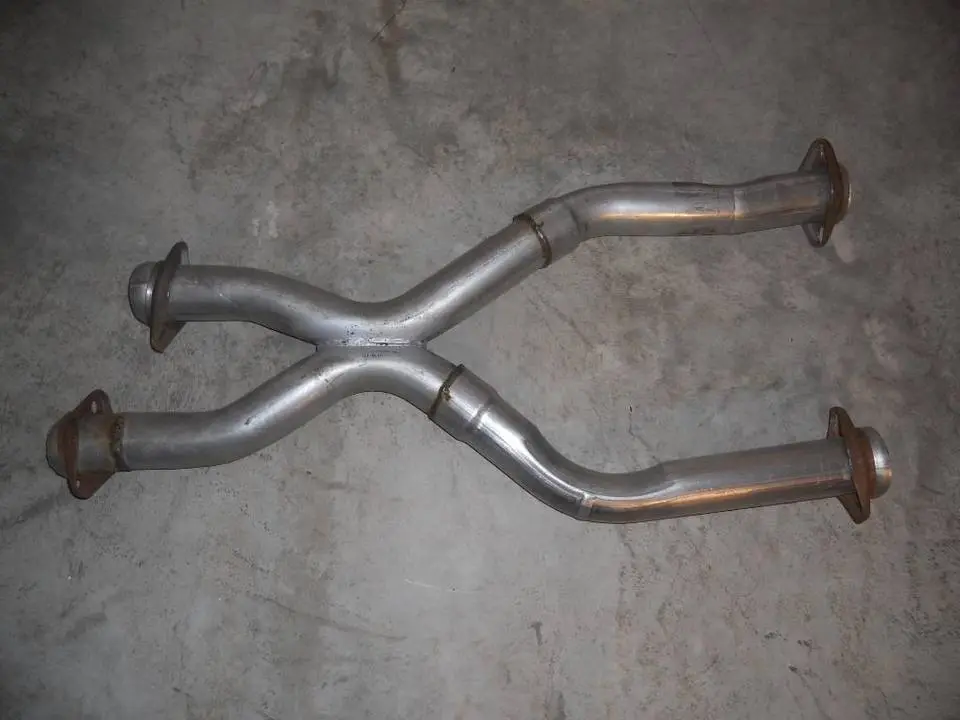

And finally... I had to try out my new pipe bender with a short pipe. I didn't spend a lot of time on it since I will have to modify it once my torque arm is in anyway. But it will work to bolt on for engine break in.
Pipe bender, I'm jealous. I just spent the weekend piecing together an H pipe out of exhaust pipe pieces from the auto parts store.
Kurt
Thanks!
Pipe bender that's sweet! Wish I lived closer haha
Thanks, hopefully it will pay for itself in the long run.

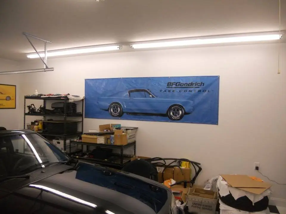

I did however replace one of the banners I lost in the fire. Put it the exact same spot on the wall as before.

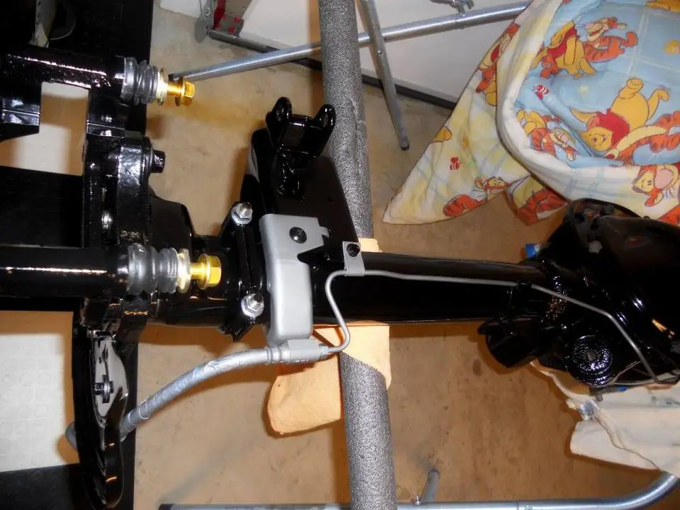

I also started mocking some of my brake stuff back up.

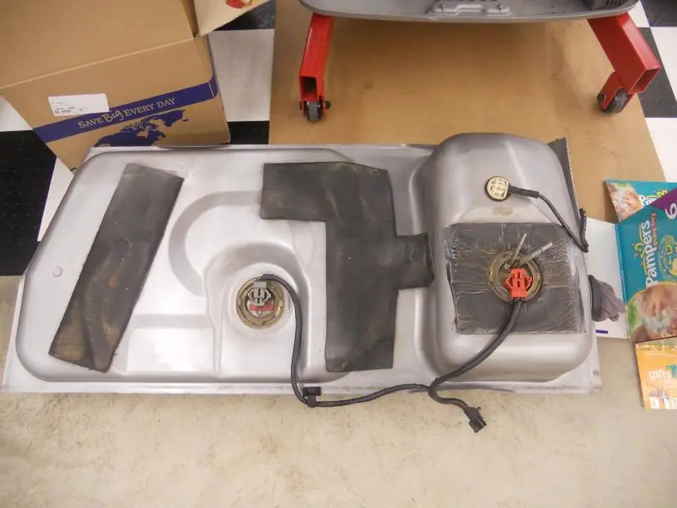

Wire brushed the gas tank and put some paint on it. Installed new gasket and 255 pump.

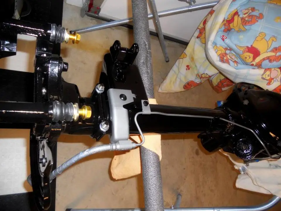

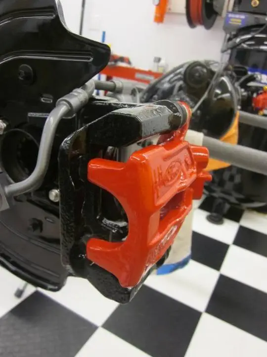

Played with a new hammered powder coat that I wanted to use on the brake lines. I want to be able to drive the car, so no polished lines this time. If I get caught in rain I can just hose the grime off now. I'm going to use this on all my brake lines.

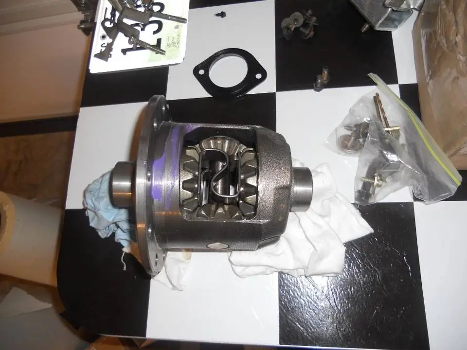

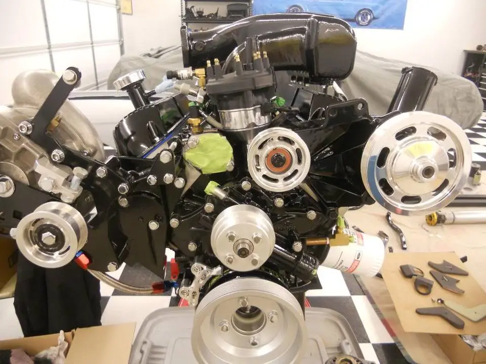

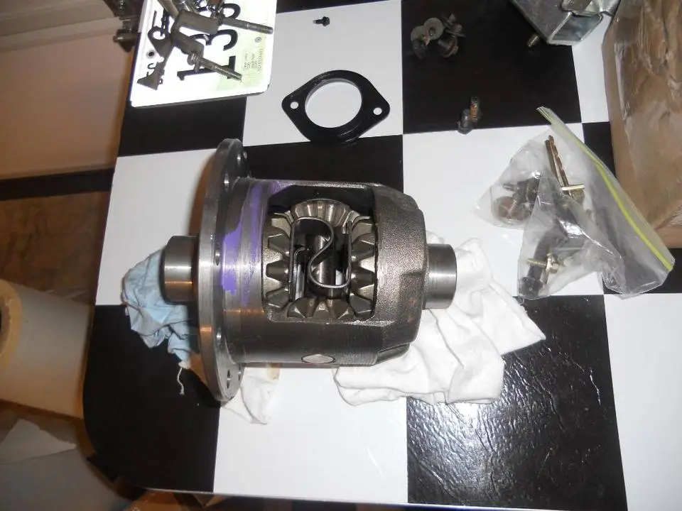

Got my 31 spline Ford Racing T-loc.

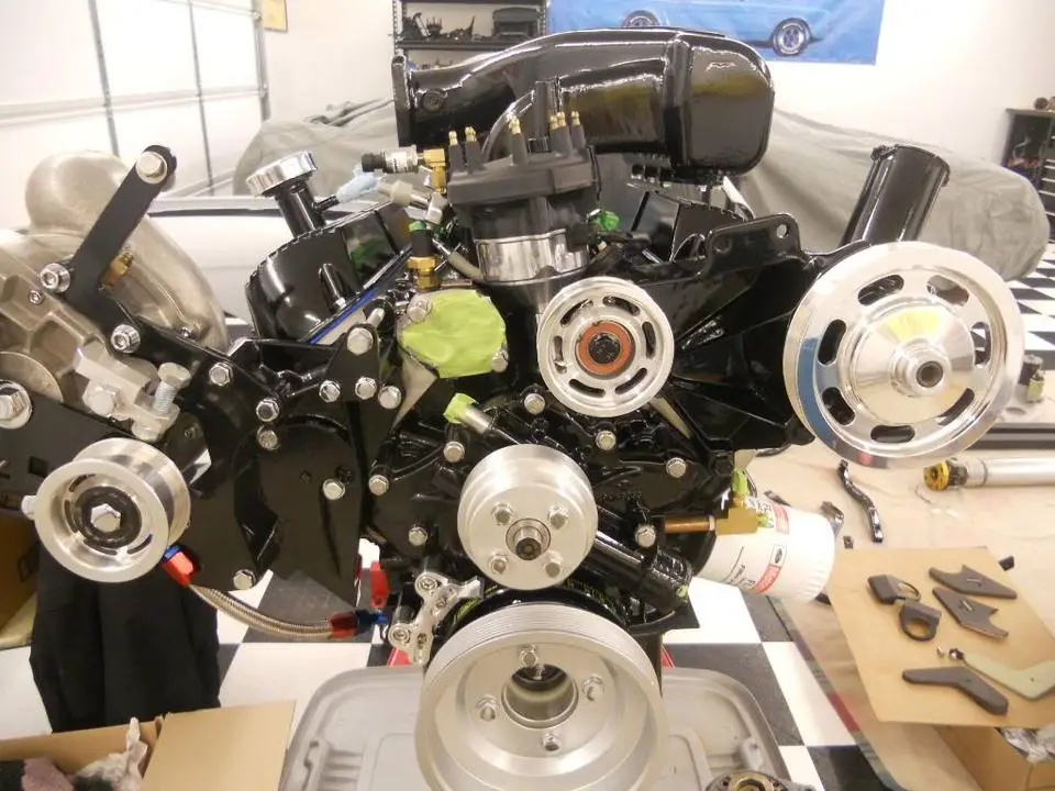

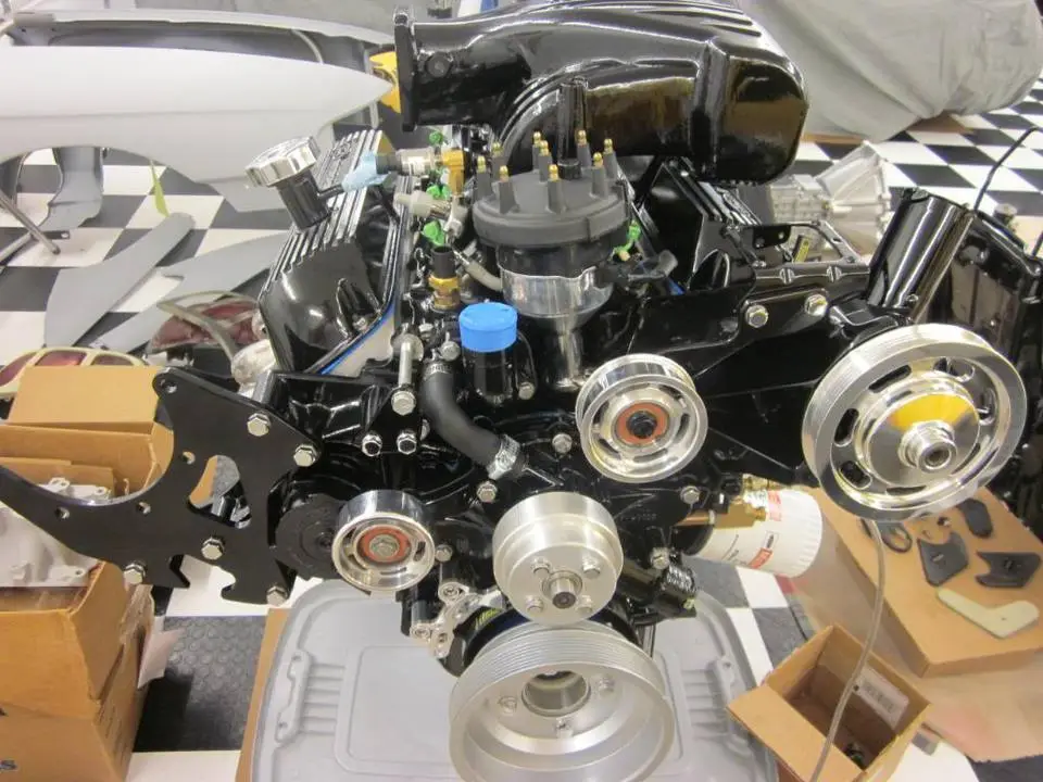

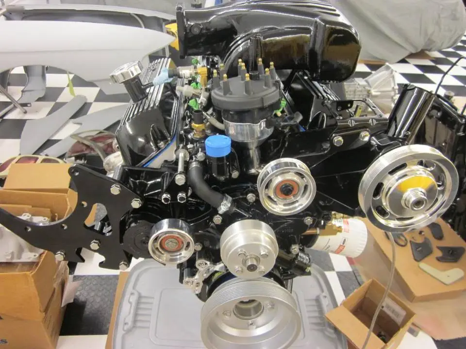

Also got four Wazee pullies (alternator, tensioner, ps pump, idler) in. I am powdercoating the alternator black and the tensioner black and when done, will put those pulleys on. In the mean time, I got the new power steering pump painted and pulley on and idler pulley installed.

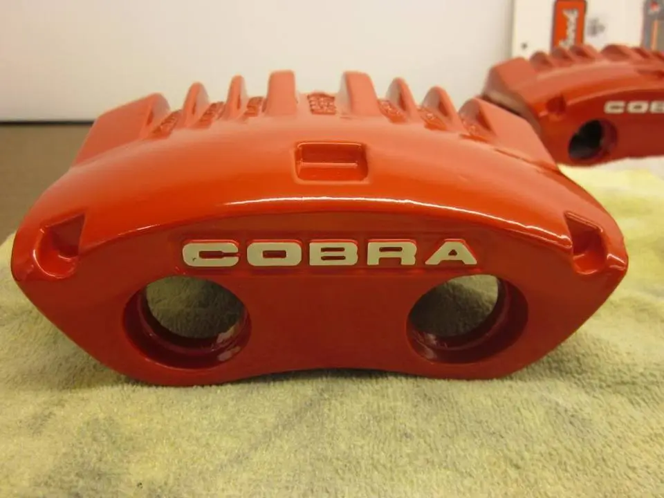

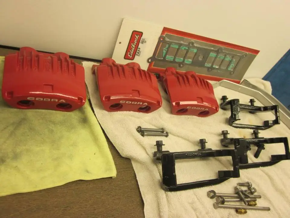

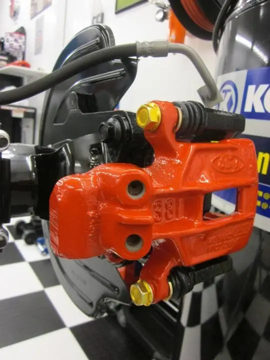

Got some more pieces done on the 94.

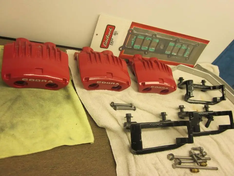

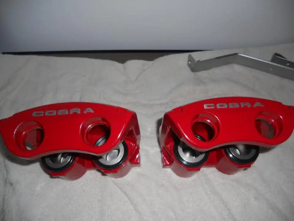

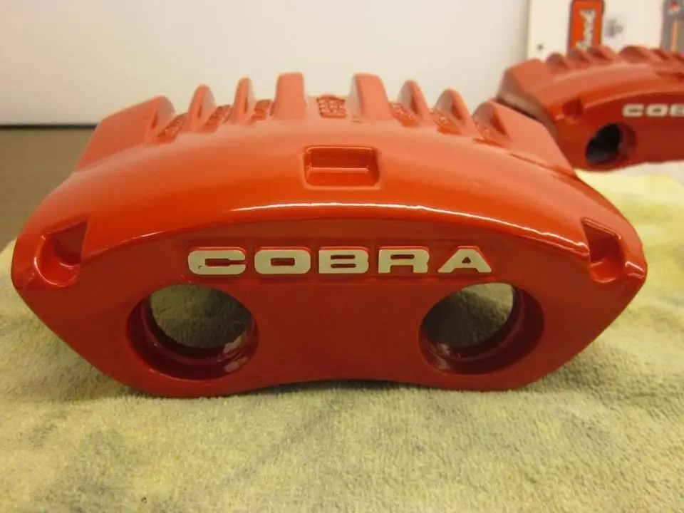

Rear Cobra calipers powder coated but still waiting for the rebuild kit to get here before I can put them back together.
Front calipers done
Looks like I'm starting a collection of red calipers

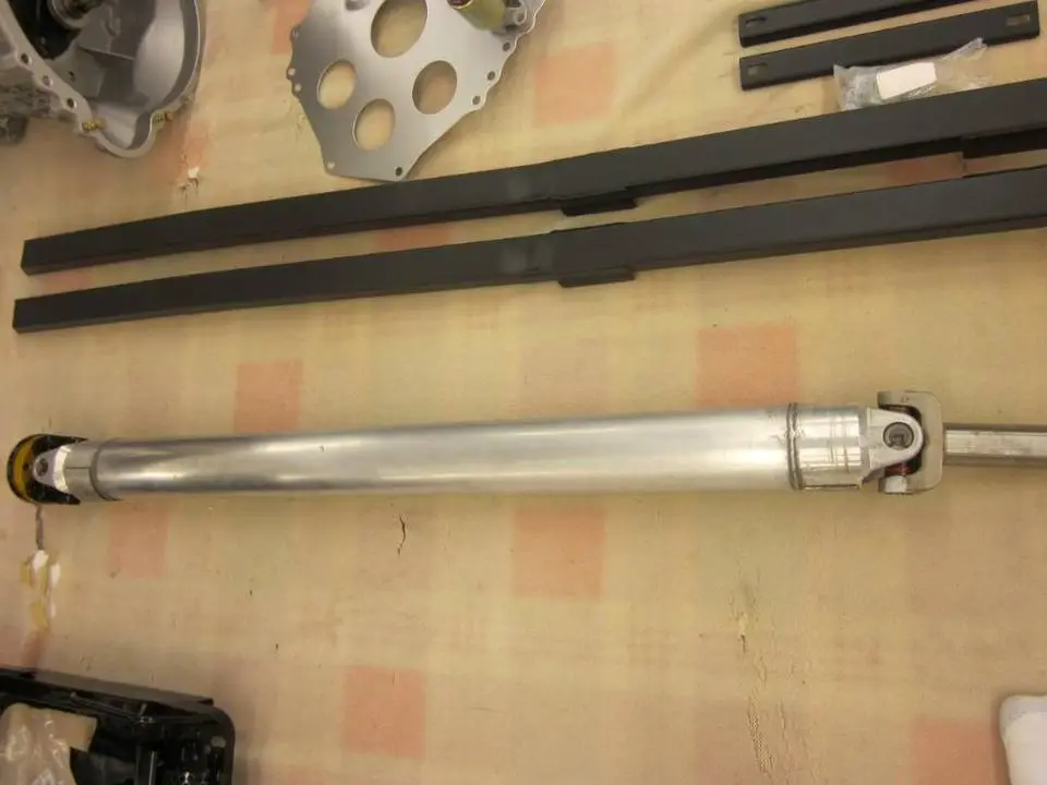

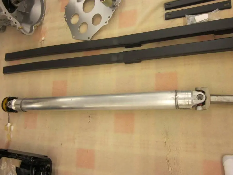

Got all the new parts for the drive shaft and it put together.

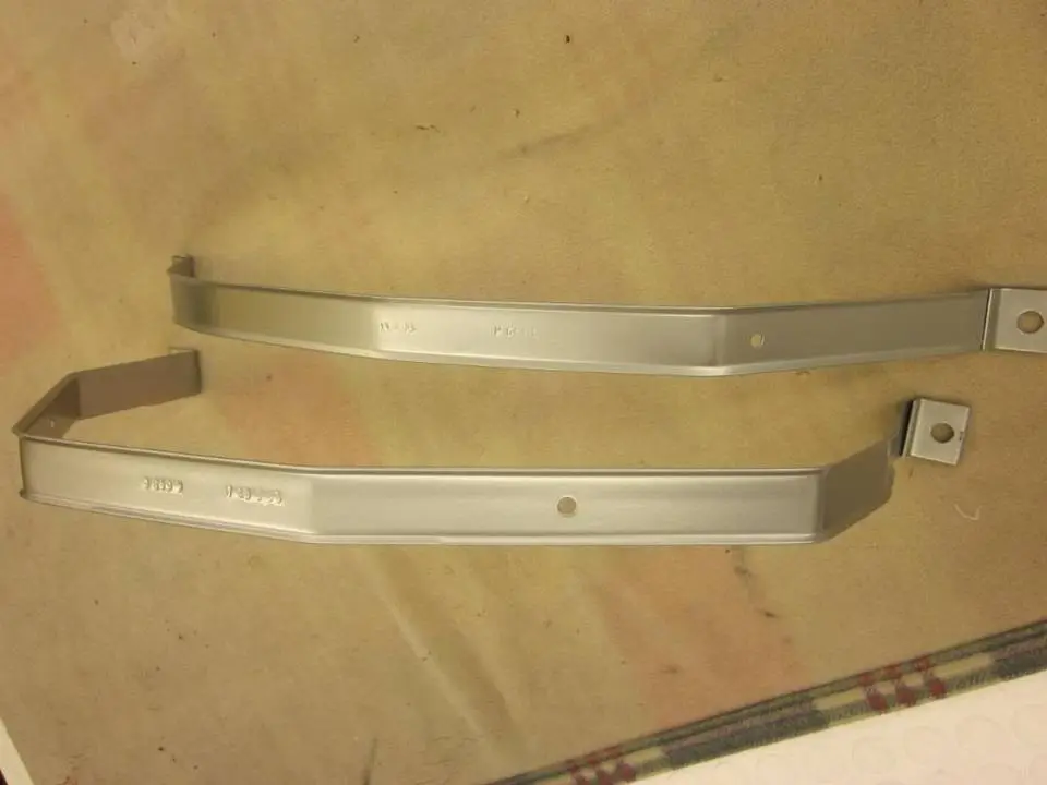

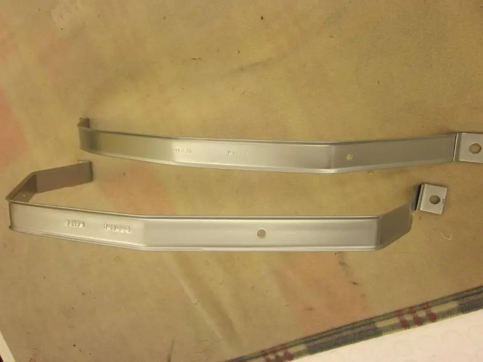

Blasted and powder coated gas tank straps

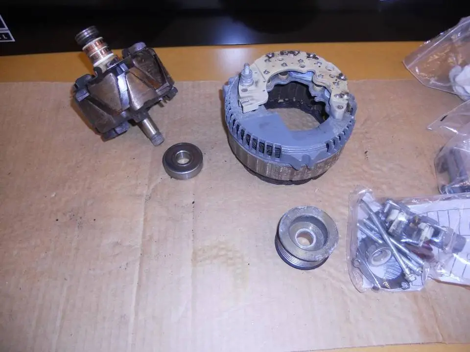

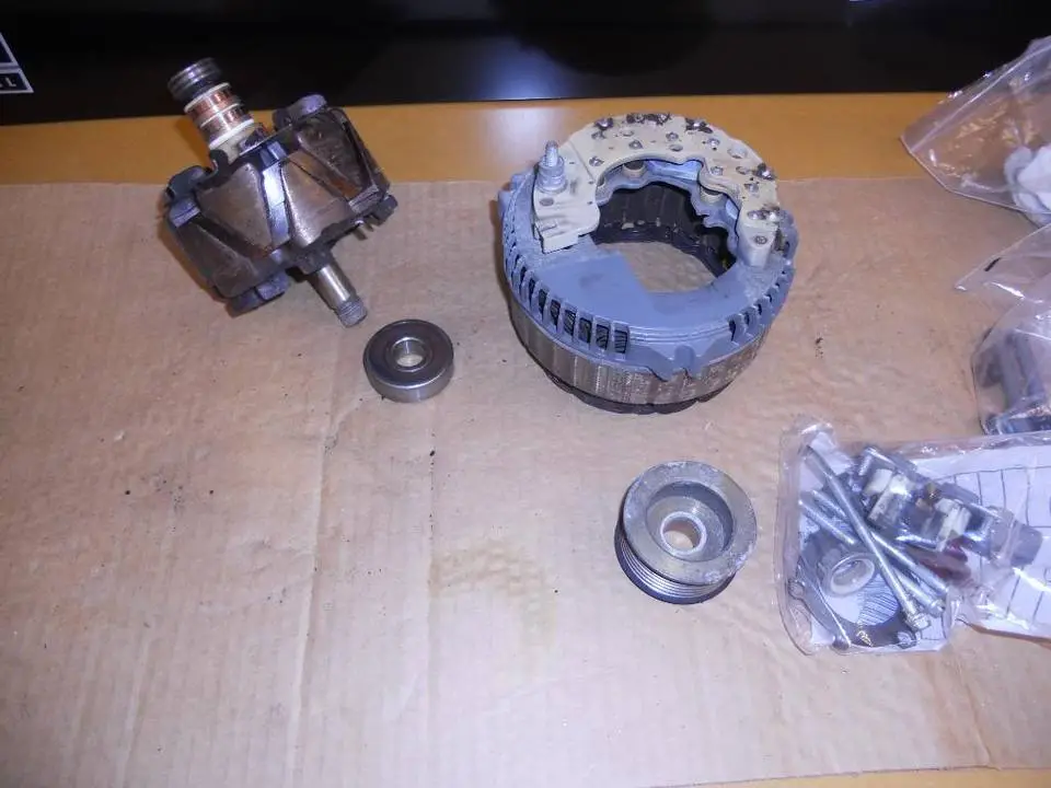

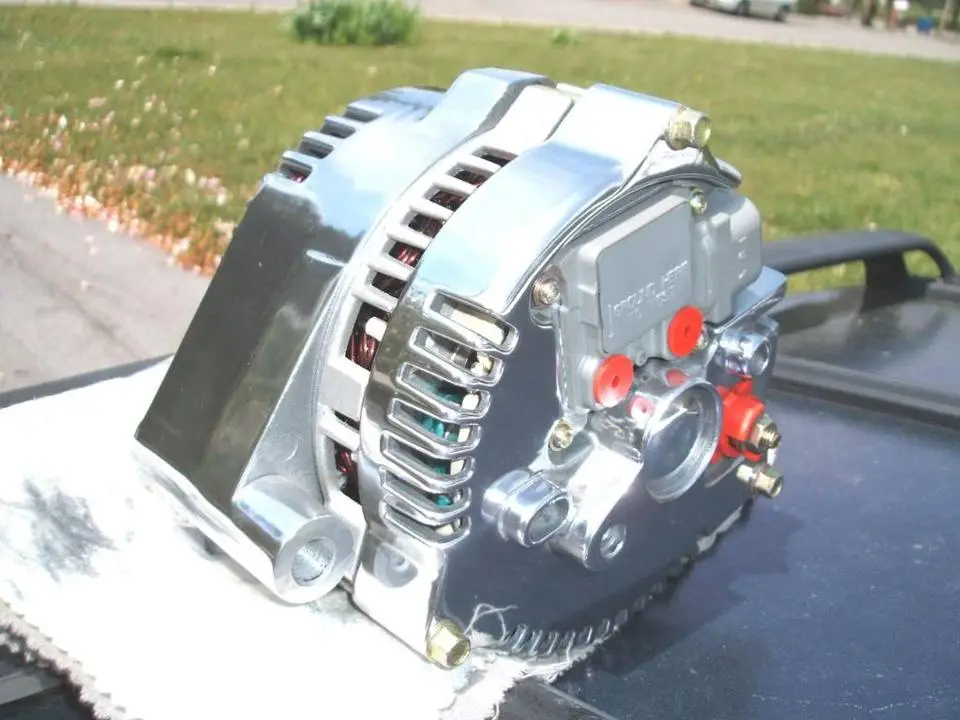

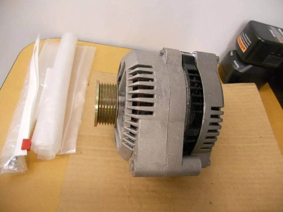

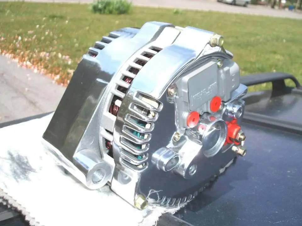

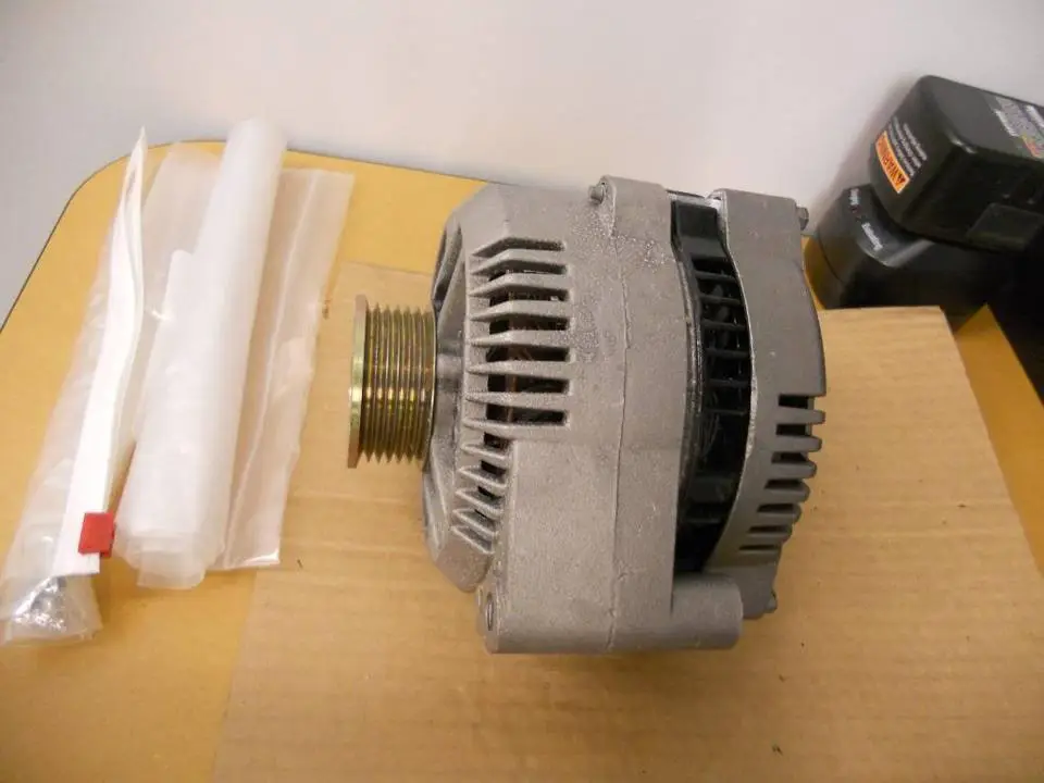

Knocked out the alternator tonight with a teardown, polishing and reassembly with new parts.
Tear down
Reassembled and polished

That alternator is amazing. What do you polish your parts with? Sorry, new to a lot of this area of building
Thanks! I media blasted it to begin with, then just start working my way up with sandpaper 100, 220, 400, 600, 1000, 1500 then hit it with jeweler's rouge and a buffing wheel on a die grinder.
Polishing an alternator . . . that takes some serious patience.
Thanks! I'll be missing the alternator when I start polishing the vortech.
