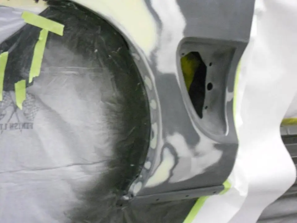

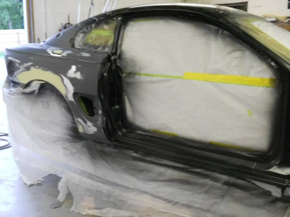

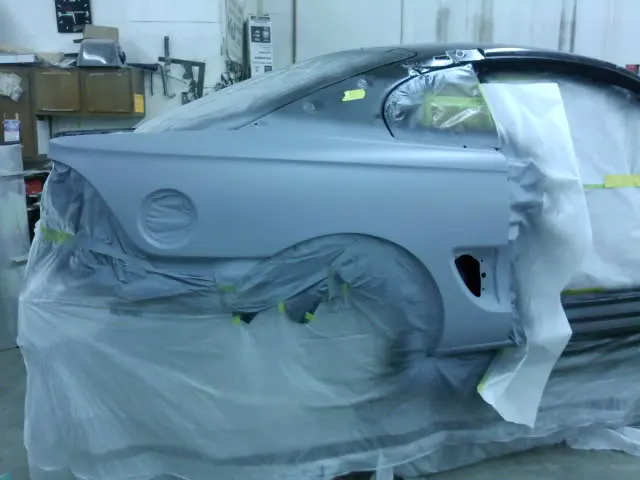

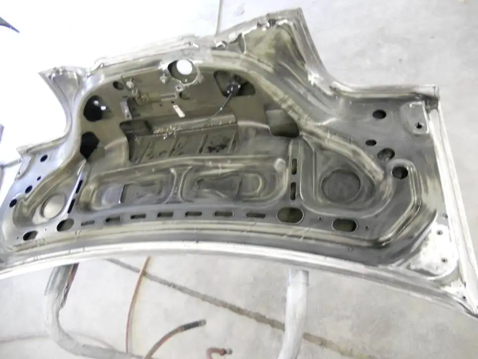

Got a lot done on the Mustang yesterday
Stripped the underside of the trunk including Ford's gobs of seam sealer. Under the seam sealer was some surface rust that had started to form. That's all gone now.
2 coats of SPI Epoxy applied to seal and will come back with neat bead of seam sealer prior to paint

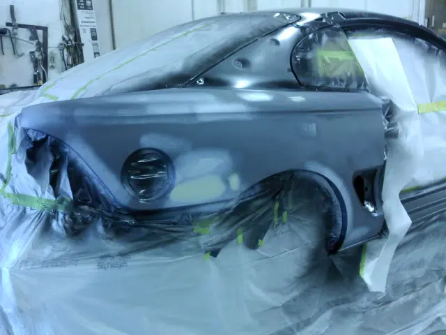

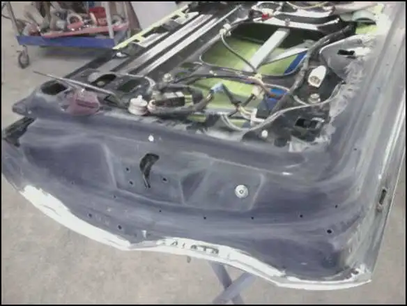

Body work started on the passenger side quarter. A lot of the work was just fixing Ford's stamping flaws.
Its all in the details..body work continues into the wheel wells to smooth out the spot welds and make this area just as slick as the rest of the car. I already rolled the fenders and line x ed in there.
2 more coats of Epoxy primer.

Anymore detail on "stamping flaws"? I don't have an eye for that so I'd love a tip. Is it that area above the wheel well on the fender? Just not perfectly smooth?
95steedamustang
I tend to be on the ocd side…
SN Certified Technician
Apr 22, 2009
3,219
6,503
174
East TN
Oct 6, 2011
#385
  • Oct 6, 2011
  • #385
Sure the typical areas on the SN95 body are tops of quarters where it meets trunk, above wheel wells(ALWAYS) in front of the brake duct on quarter where door meets, around door handles and locks, fender and door edges.
The best way to identify the waive areas is with a coat of primer and a good block. The high and low spots will reveal while blocking.

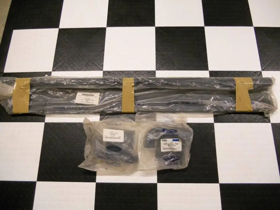

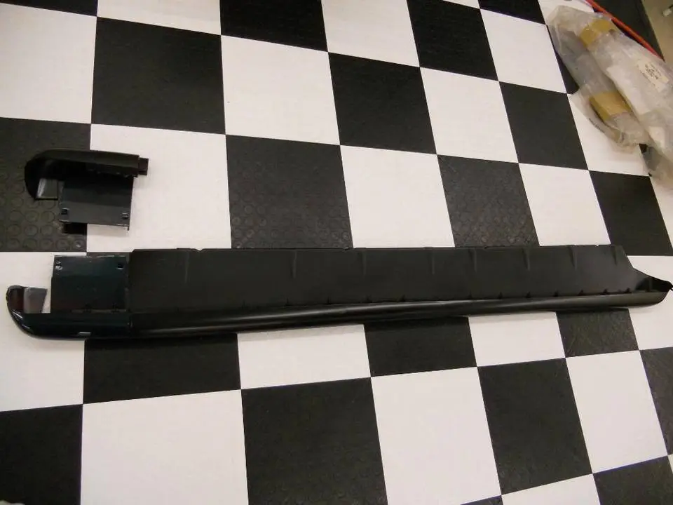

I bought these OEM Ford side skirts off ebay about a year for $40 bucks. I drug them out of my attic to start prepping them. I still need to find a passenger side. I have a couple of good used ones that I could strip but I really don't want to.
The one's on the car were hammered where they used the wrong jacking points. They were bent back along with the metal. I fixed the metal but the original side skirts were trash.

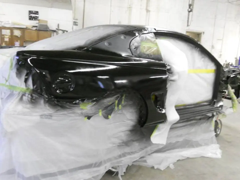

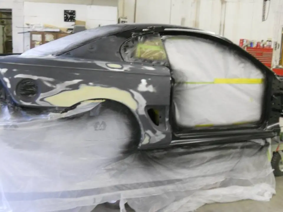

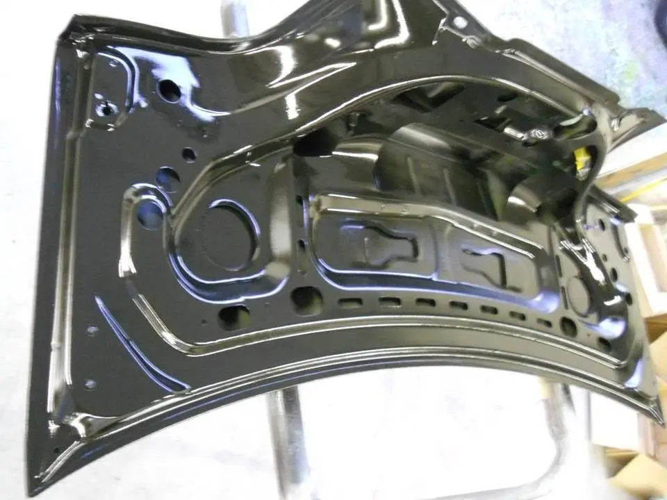

Got some more work done on the Mustang.
More blocking and primer on the quarter

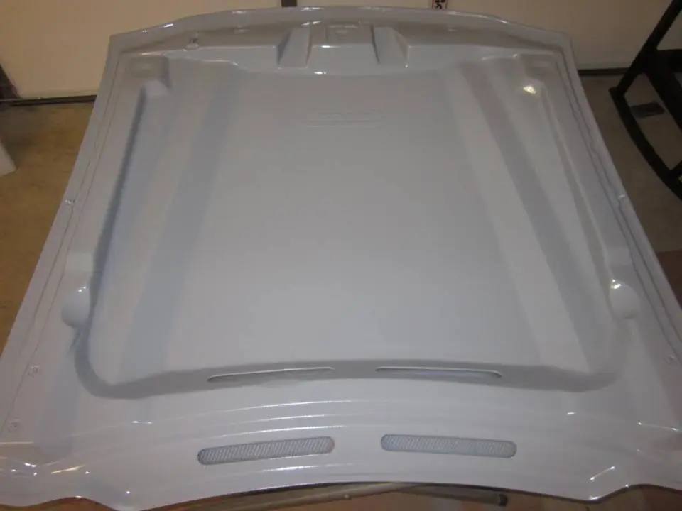

Got some work done on the underside of the hood and put some epoxy primer on it.

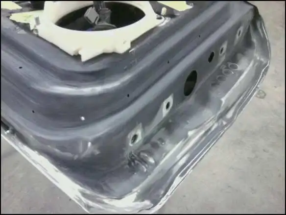

Doors stripped of seam sealer. Found some surface rust starting to form under the sealer. Thats all gone now!

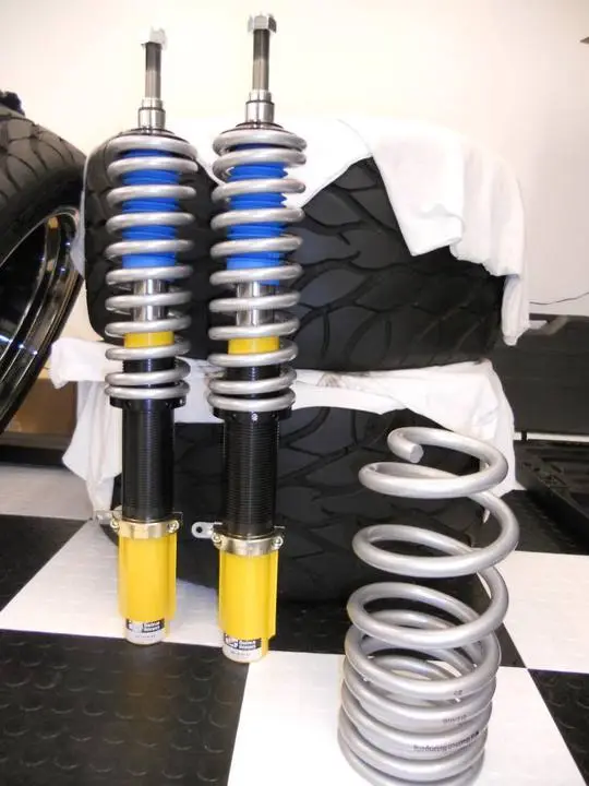

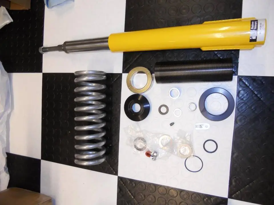

Maximum Motorsports deal of the day is back, so I'm hoping to get the rest of the suspension parts for this project.
Starting with these MM sport dampers along with the springs and coilover kit I bought last year. The springs are 10-350 s that I powdercoated silver to match my rear springs.
Put them together... ready to go on the car.
I'm going to go ahead and buy some 375lb and 400lb springs since I can switch out easily.

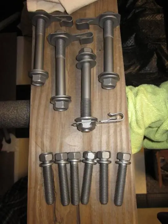

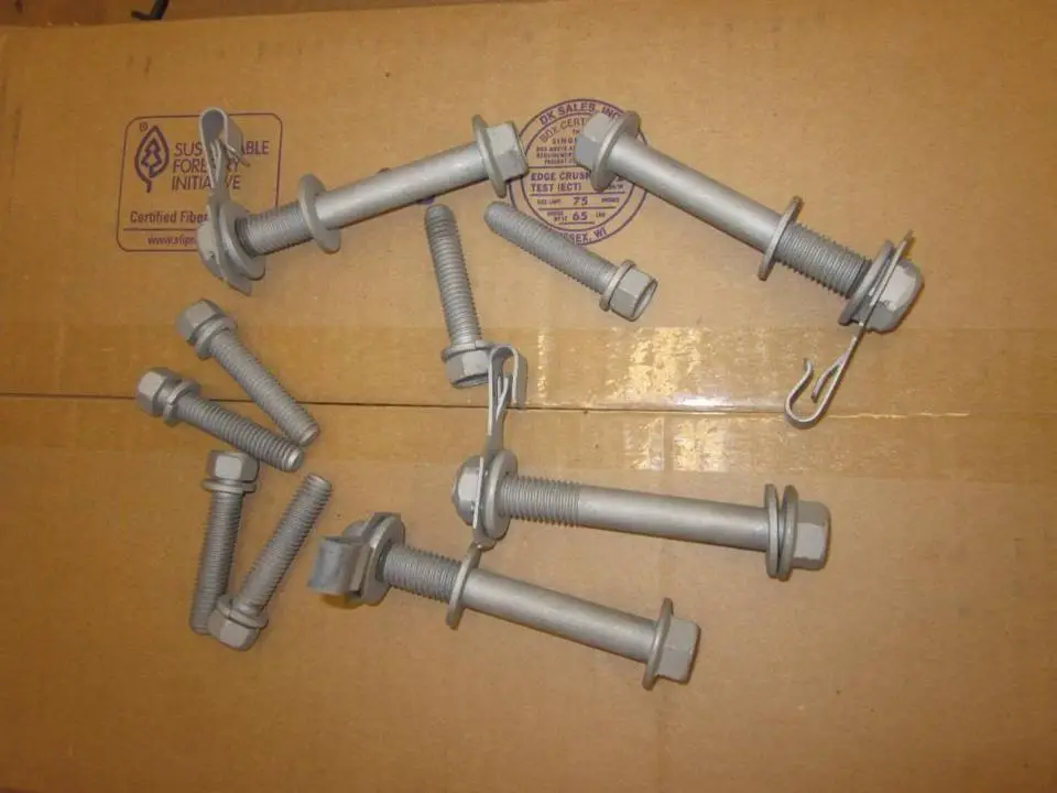

I went ahead and got all my bolts taken care of for when I'm ready to put this thing back together.
Glass beaded
Powdercoated
The threads are just coated with a dusting of spray bomb because you dont want any powder in your threads. Its a real pain to get off.

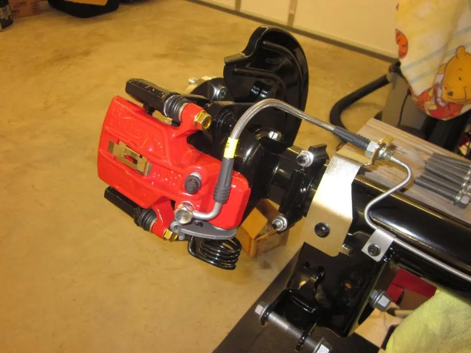

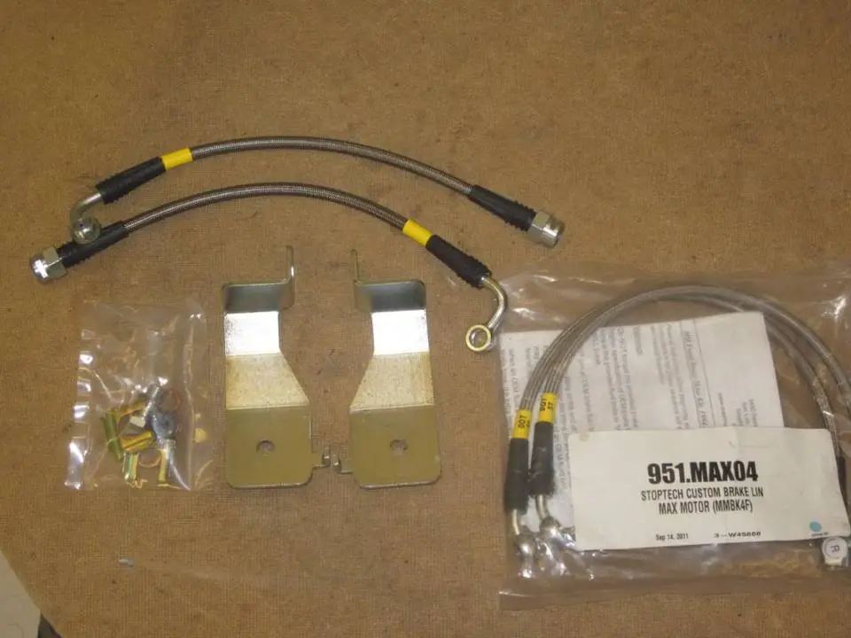

Ordered my Maximum motorsports front and rear Stainless brake lines.
And installed on the rear. I'll do the fronts when I bolt everything up. I just love all of their stuff. Definitely worth the money.

  • #396
I bought a set of Russell Stainless Steel brake lines rather then the Max Motorsports ones only because it comes with the a 5th brake line for the center rear. Plus the the price of the set was less!
I'm sure the max motorsports one is better quality though! I'm totally on a budget!!!
Looks great! I'm loving the progress!

Back when I bought mine, they didn't even offer a 5 piece kit. You could only get the 2 front and the one center, so I'm stuck with the stock lines going to the back calipers.
Thanks man! Maximum now sells a kit with the fifth line in it but I didn't order it. I actually have the Russell Stainless center line left over from the previous one. I had ordered it a couple of days before the fire. It showed up the day after. So I have had it two years. I'll use it on this car.
