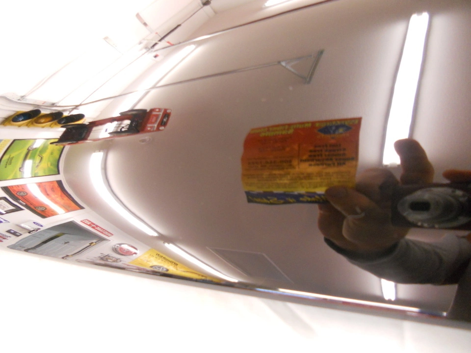

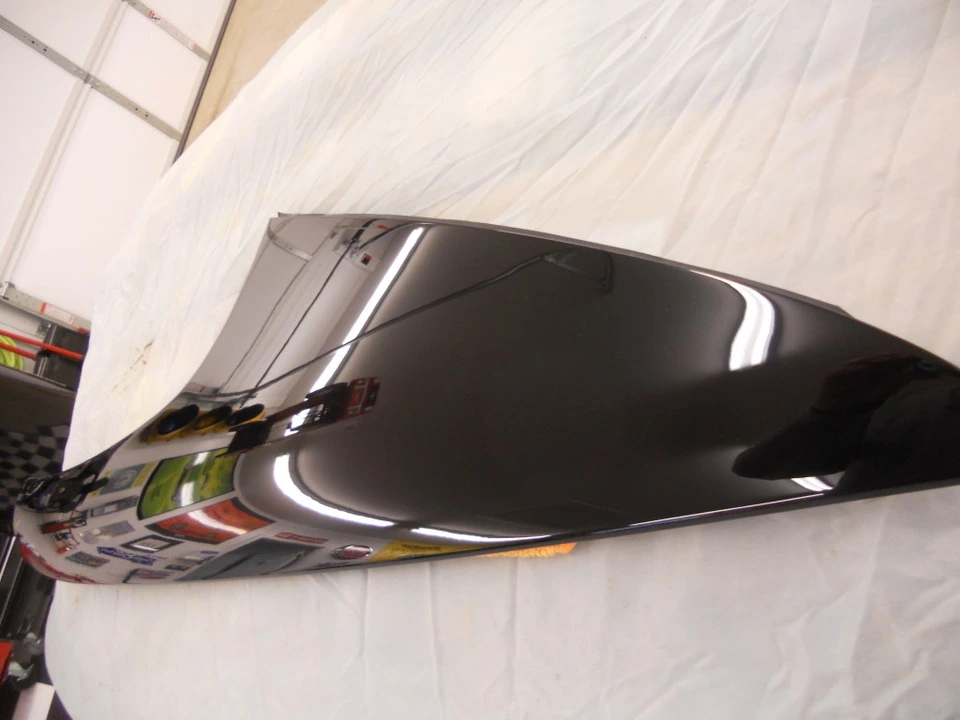

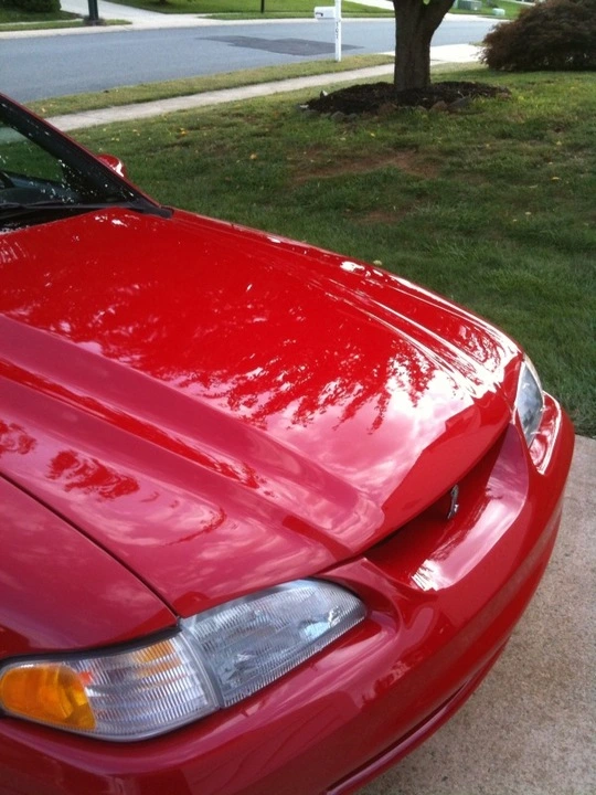

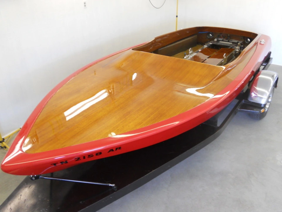

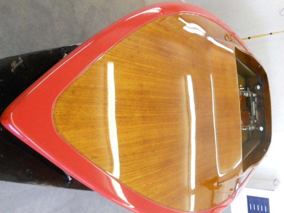

I don't have any paint on this car, but in my defense, I have painted a bunch of cars since I started this project. Here is my latest.

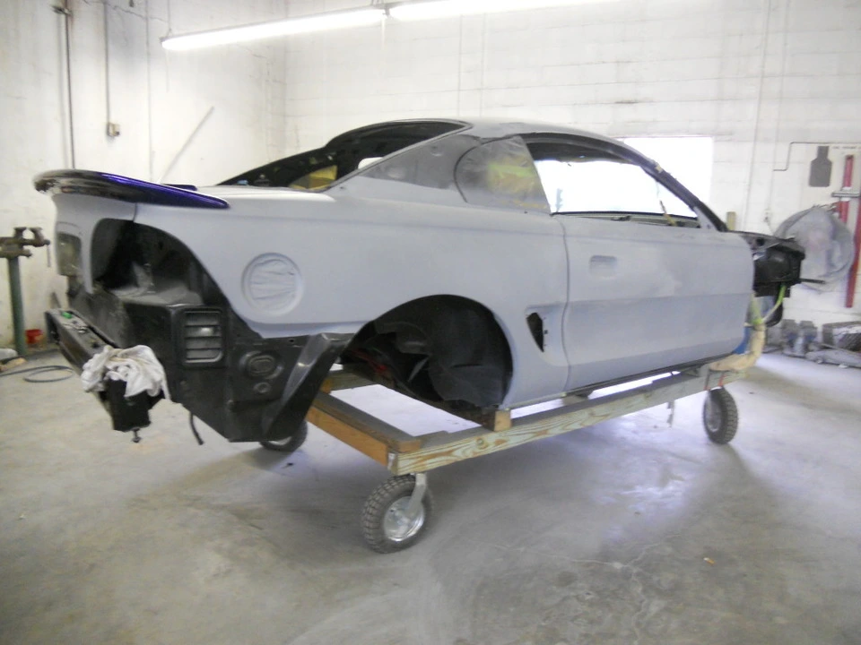

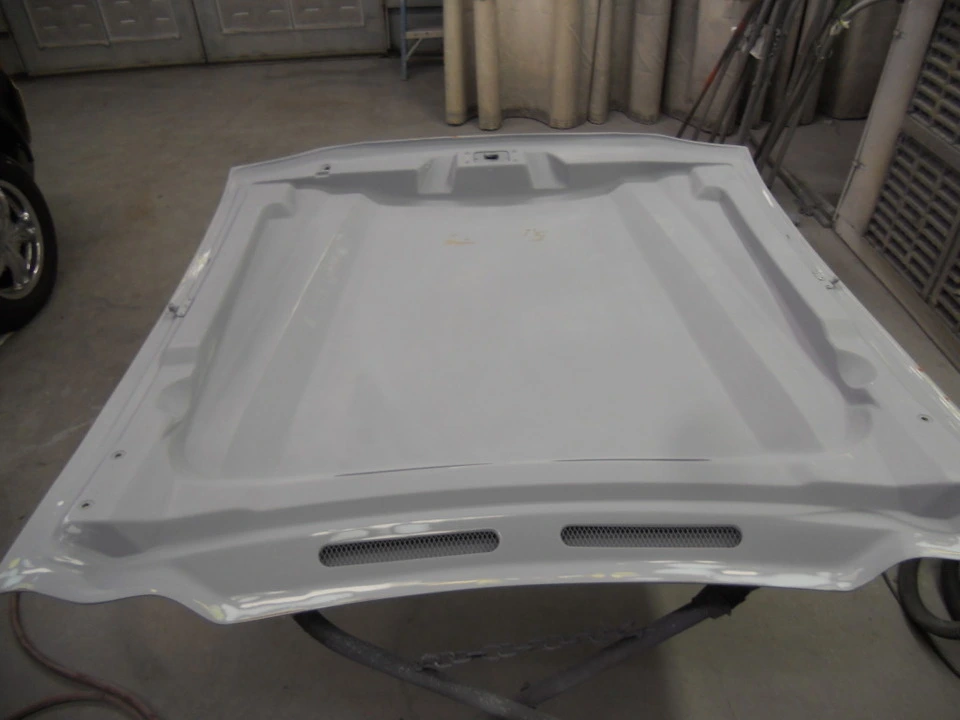

Some progress for the week.

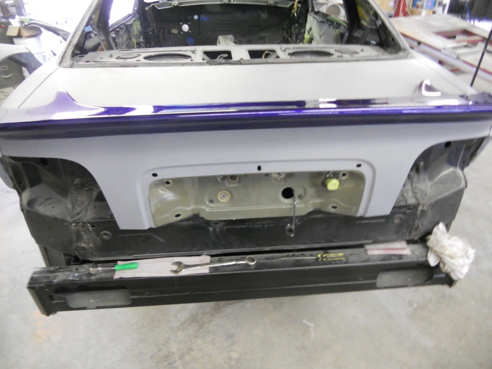

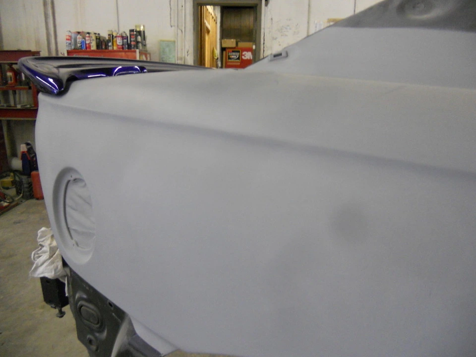

The trunk lid is now lined up and the quarters and the driver's quarter saw the BFH to get the gap right on both sides. The spoiler from my old car was dusted off and fitted back on the lid.

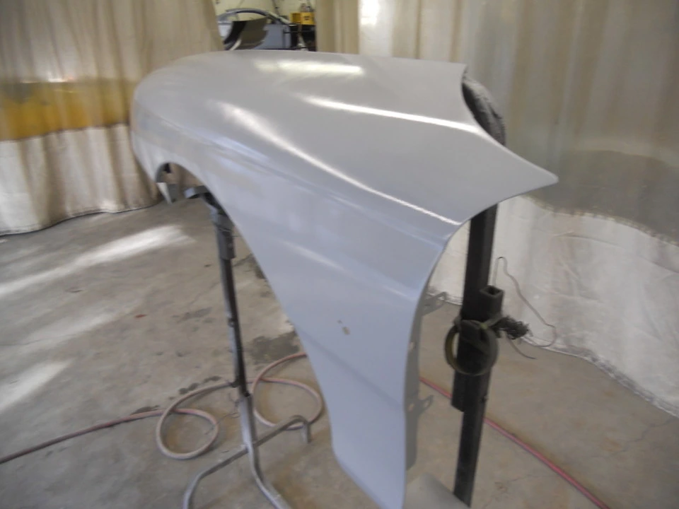

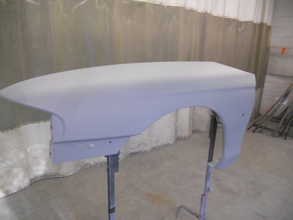

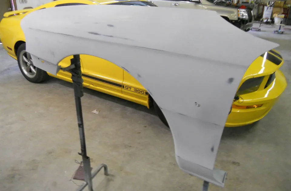

Finished blocking the driver's fender again and got it in more primer. I think it almost there
wet primer

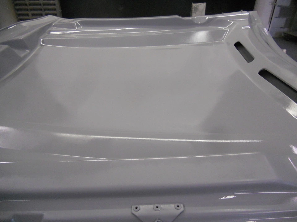

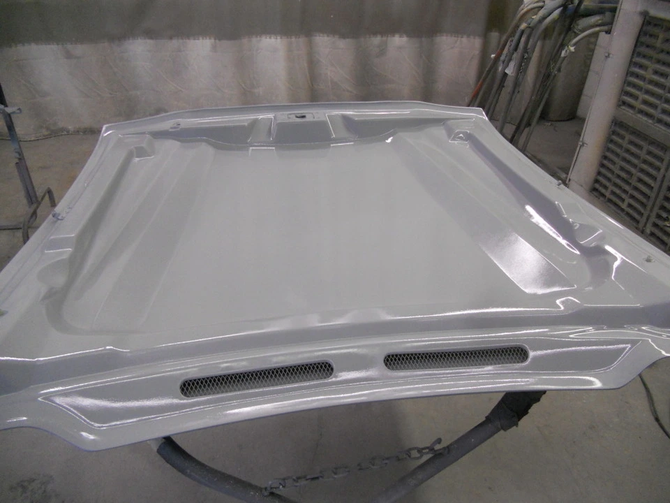

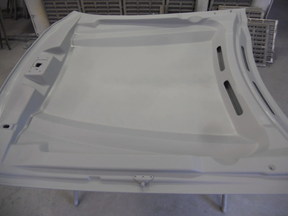

Blocked the underside of the hood again and it saw coats 4,5 and 6 of primer. It needs one more blocking and a couple more coats of primer to be perfect.
wet primer

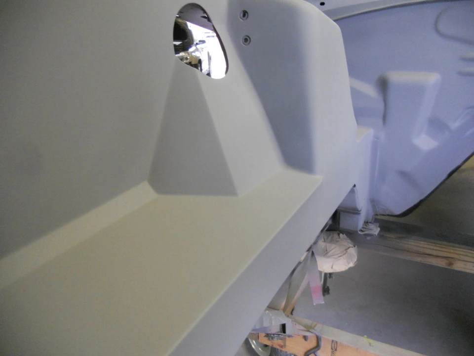

Quick once over on the engine bay

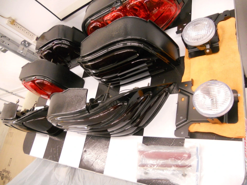

Got some NOS Cobra fog lights and side markers to add to my growing collection of taillights for this car.
Sorry.... still no paint

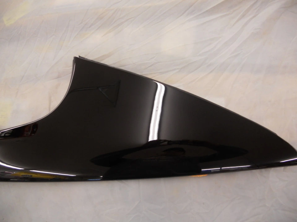

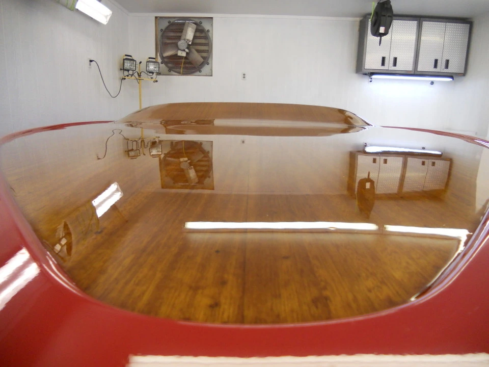

I have a couple of painted pieces done. The sail panels have been wet sanded with 1500, 2000, 2500 and 3000, then buffed out.
Just gotta be patient and the rest of the car should look similar.
