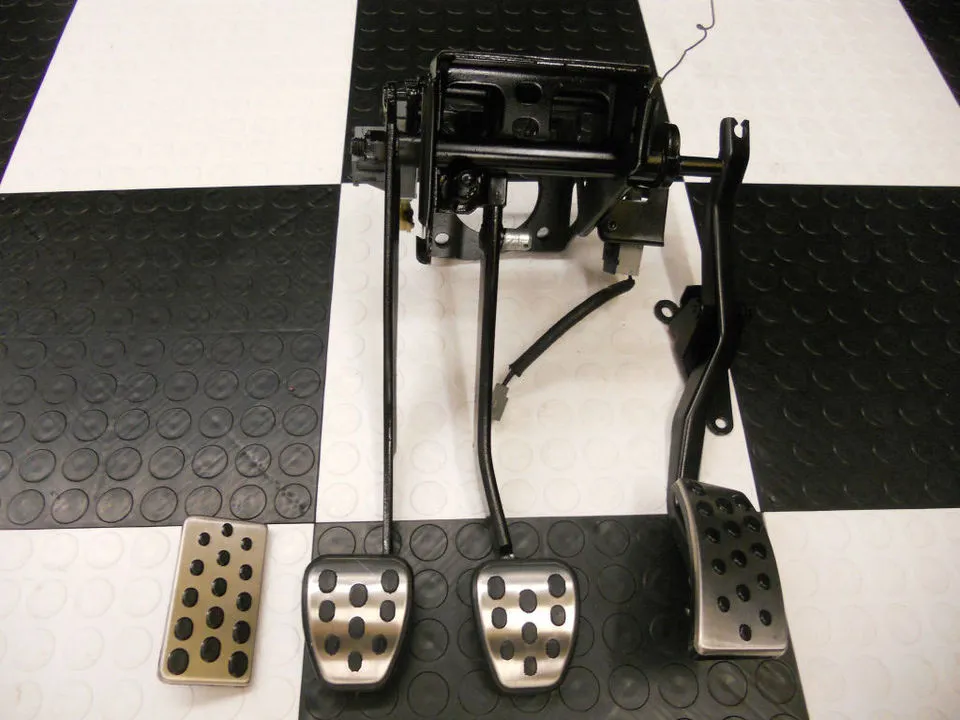

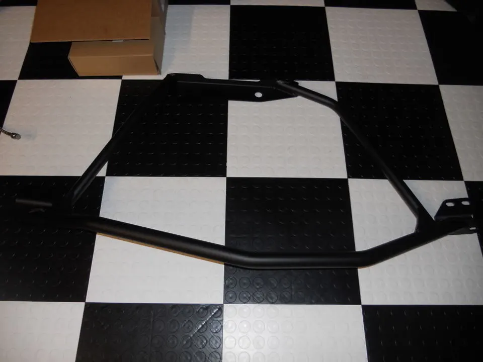

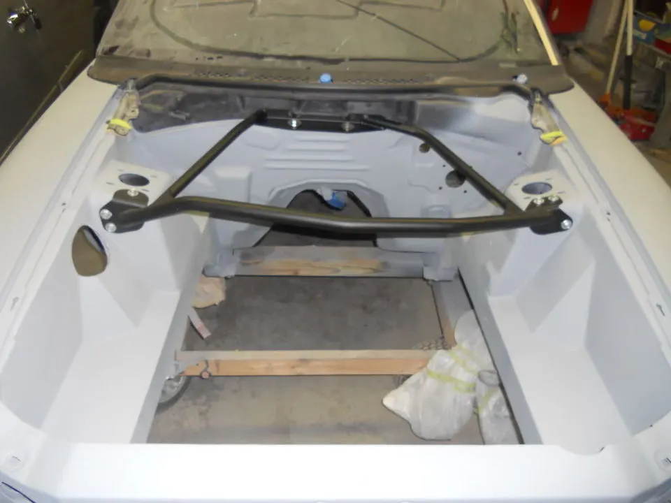

Got the pedal brackets powder coated and new pedals installed. Another small piece done and ready to go back in.

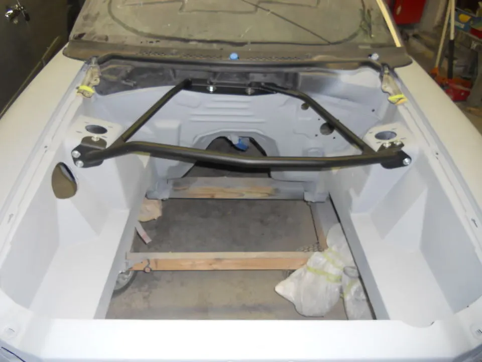

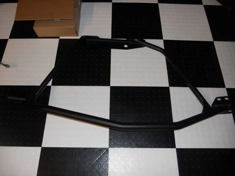

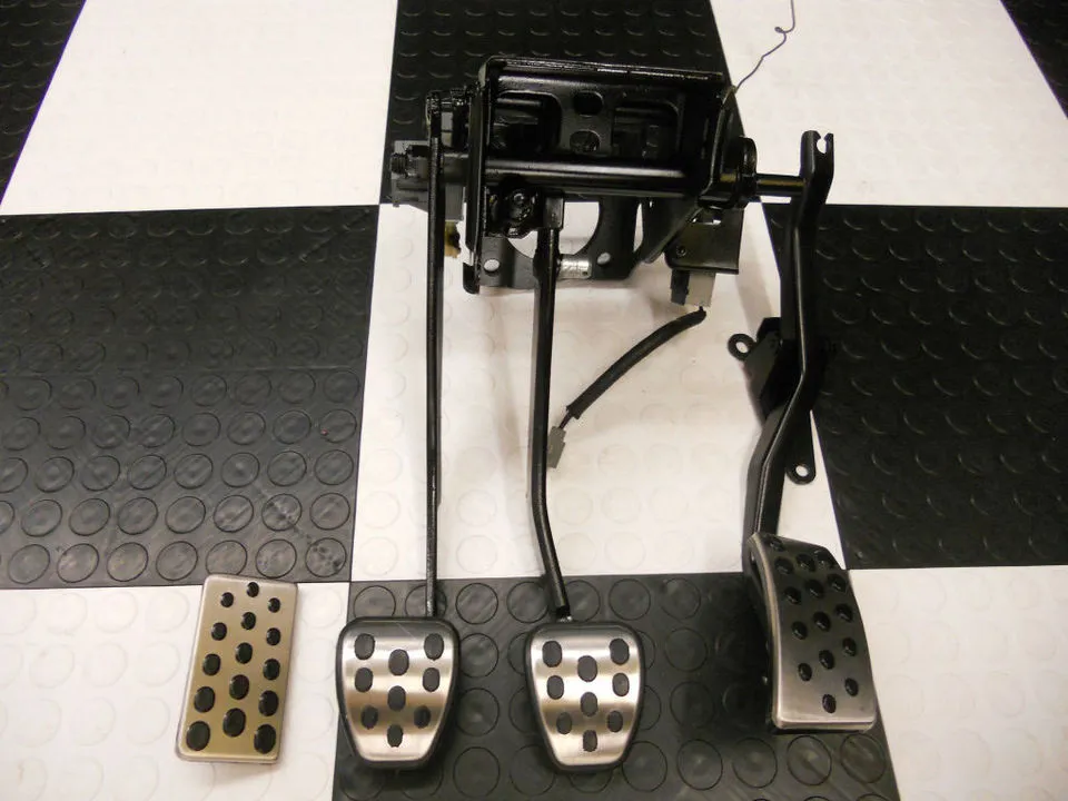

Also after mocking up the strut tower brace, I decided it needed to be powdercoated Black.

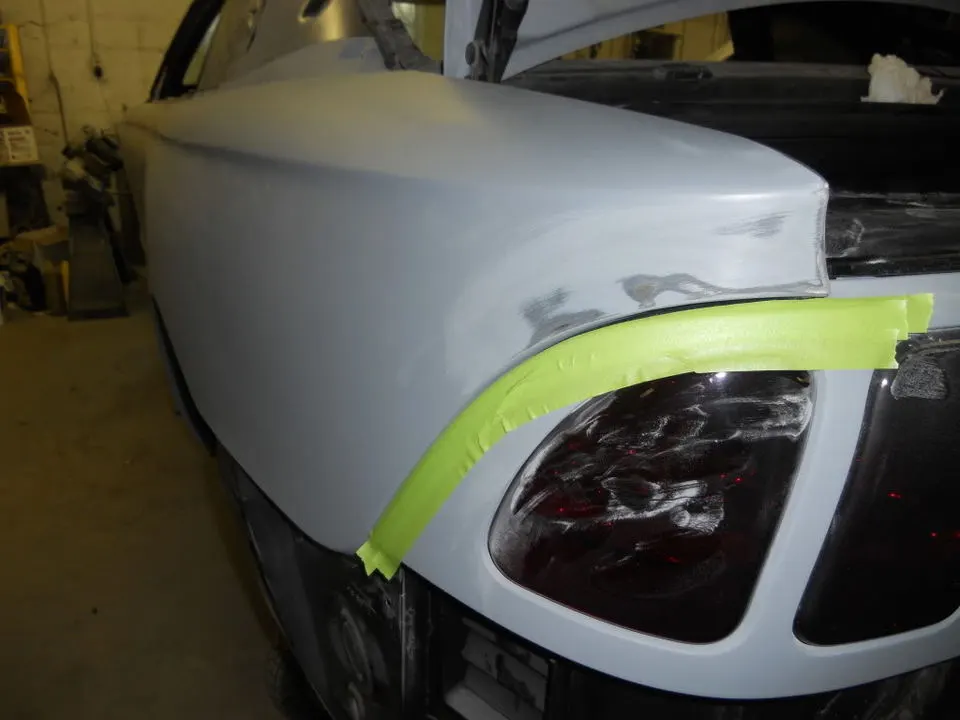

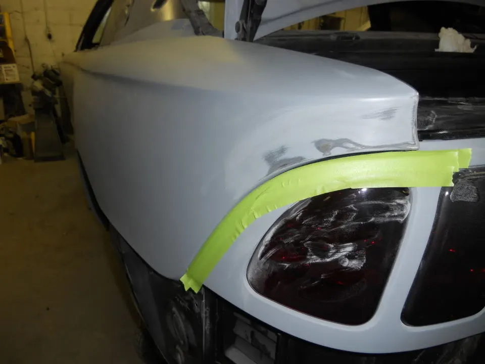

To get the gap right on the trunk lid the quarter saw a little hammer action. SO now it needs a little more work.

Haha, poor Troy. One poorly worded post that will never be forgotten! Pretty impressive that you took a hammer to that trunk line on the quarter, and the rounding of it is still so smooth. When I take a hammer to something, it turns to junk covered in divets.
I believe the hammer work. My trunk lid and every other trunk lid I have seen on an SN isn't even close.
Kurt
Yeah, that's exactly the problem. They were never even close from the factory. This trunk saw a the BFH, prybars and other assorted manipulation tools. Its been pulled and stretched and massaged every way possible. I know I put the taillight in 40 times trying to get it all lined out.

Your attention to detail is amazing. My trunk lid must be 3/4" off. It's not even close. I have never looked at it and said, I will get around to fixing that eventually. It has never even crossed my mind.

Yeah...its a snowball effect, once you start correcting and fine tuning...you start to notice things everywhere. I spent countless hours getting the bottom of the trunklid flush with the taillights. If you put a ruler on any sn95...the bottom of the tail light and trunk lid are off 1/2 to 3/4 of an inch. Then you got to keep the other side of the taillight flush with the quarter. Its a constant battle.

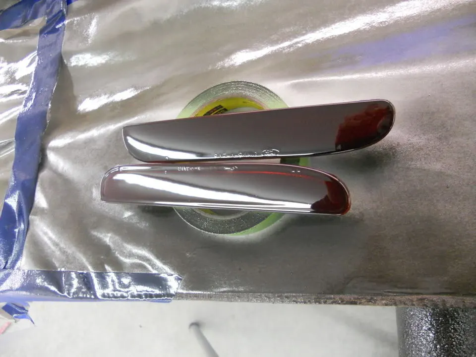

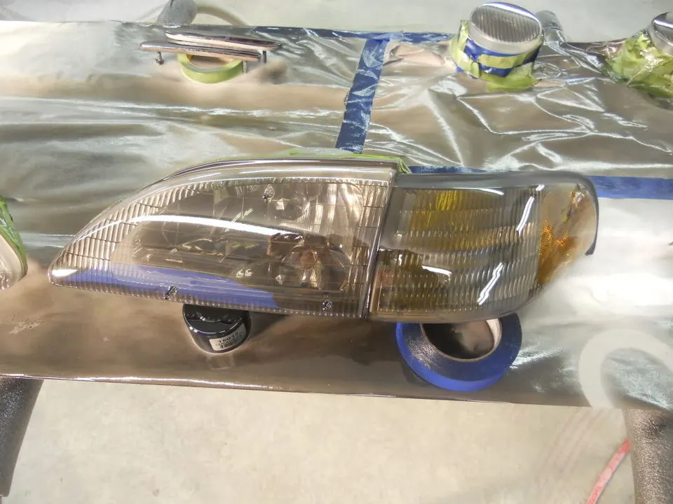

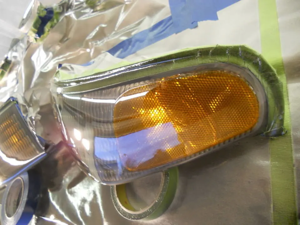

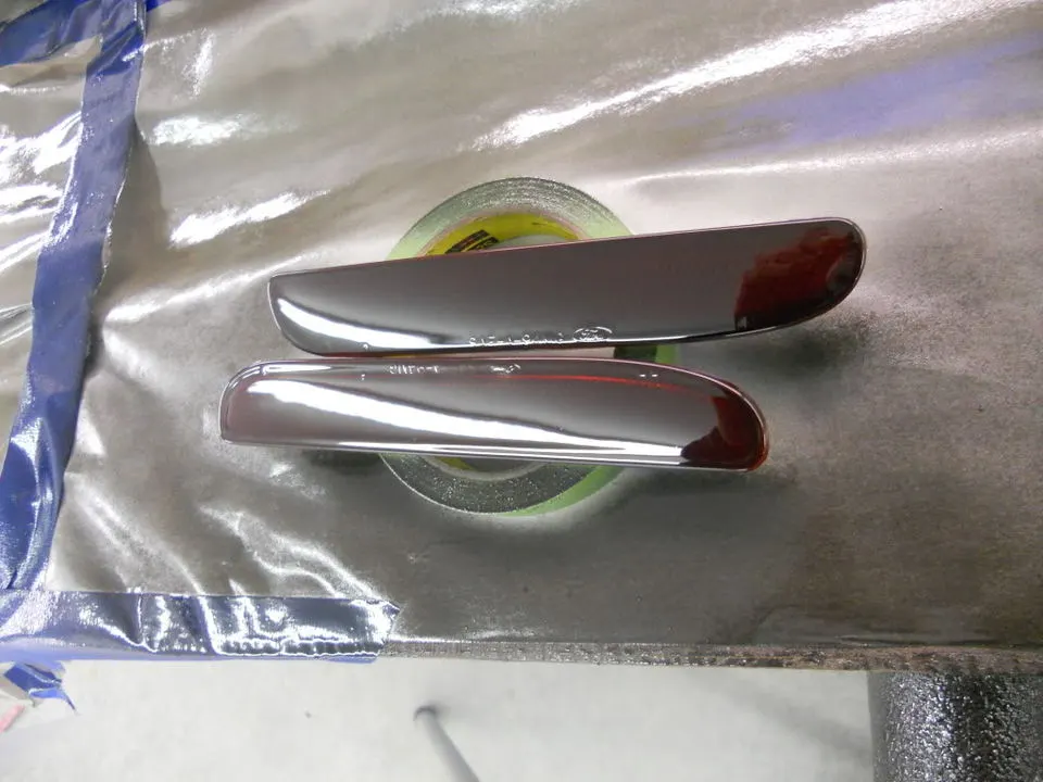

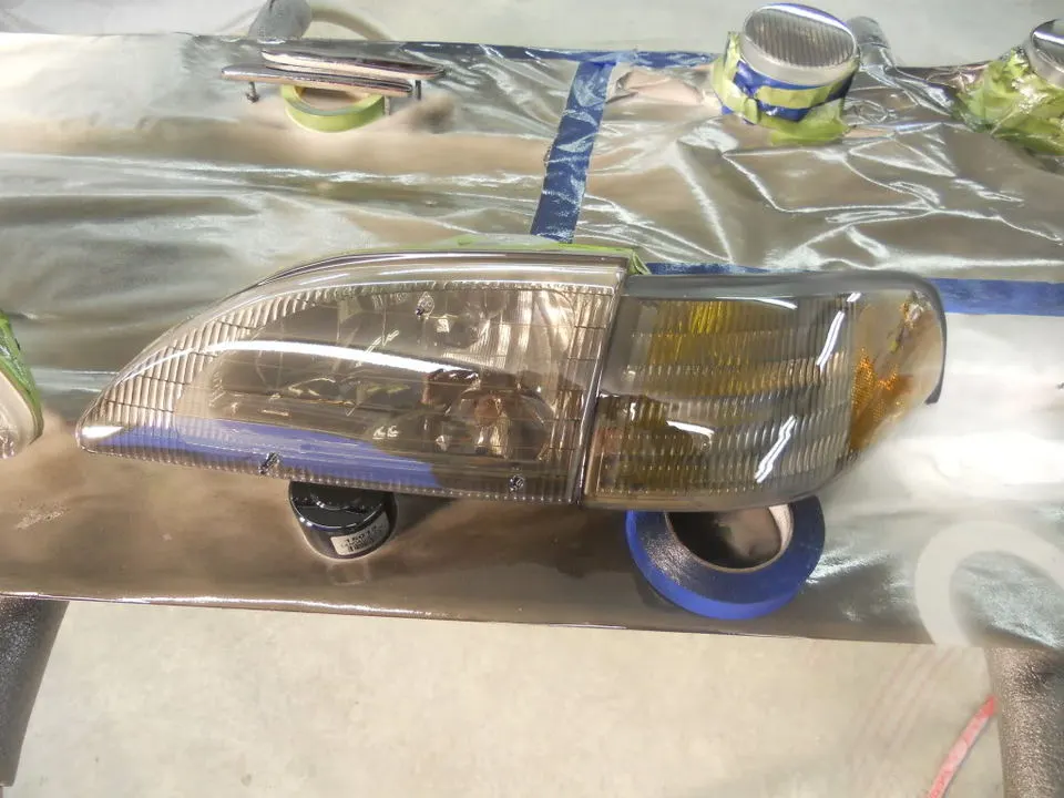

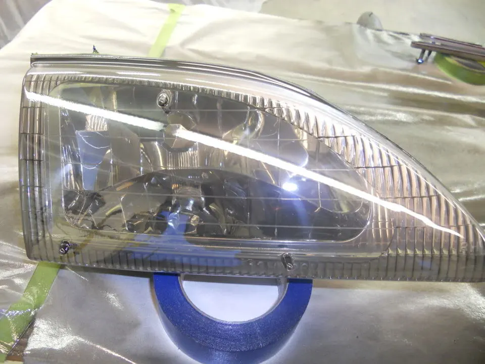

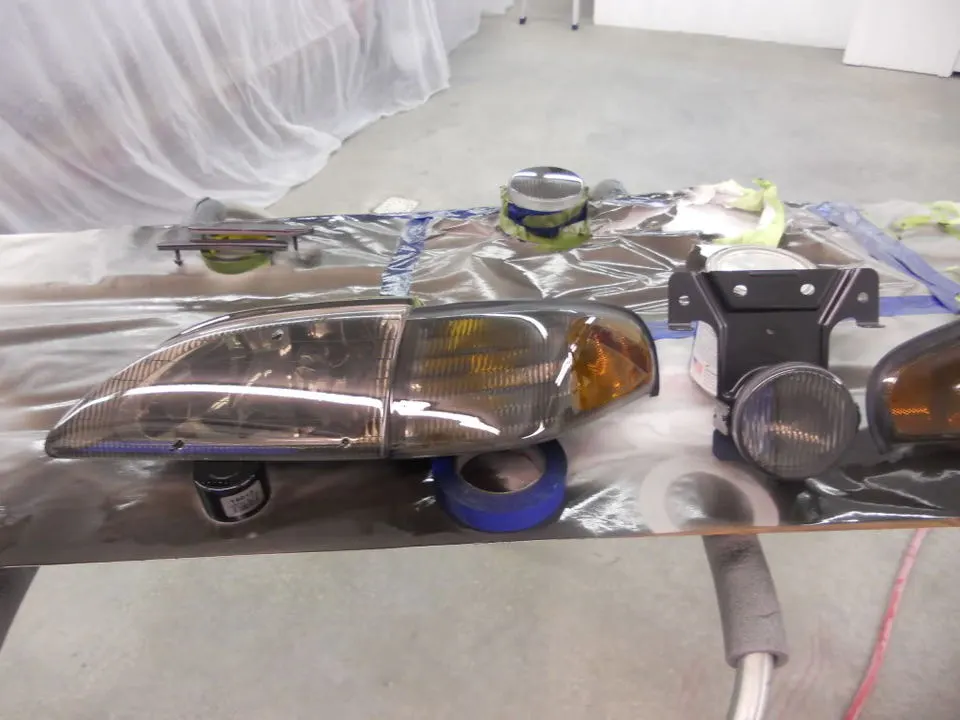

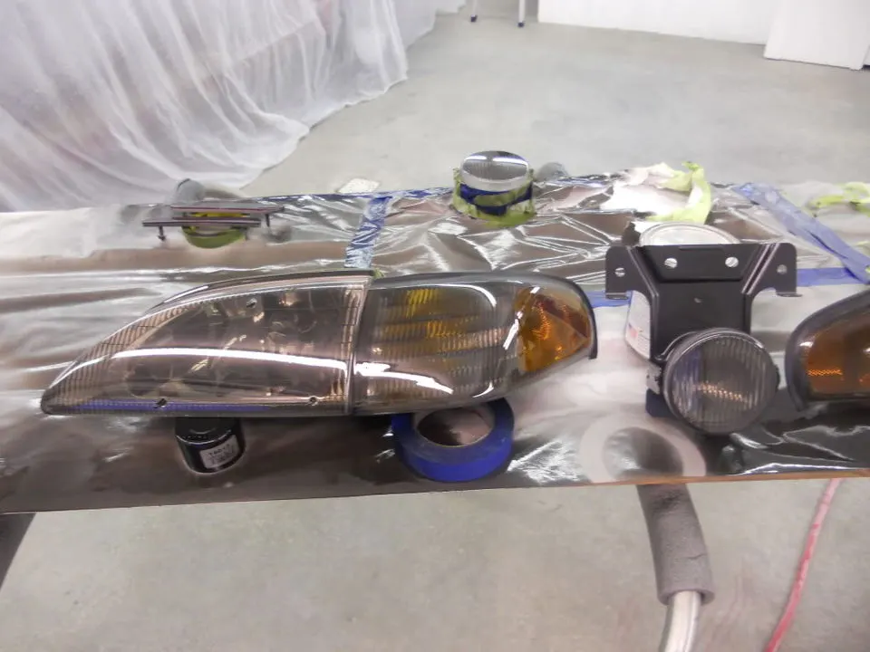

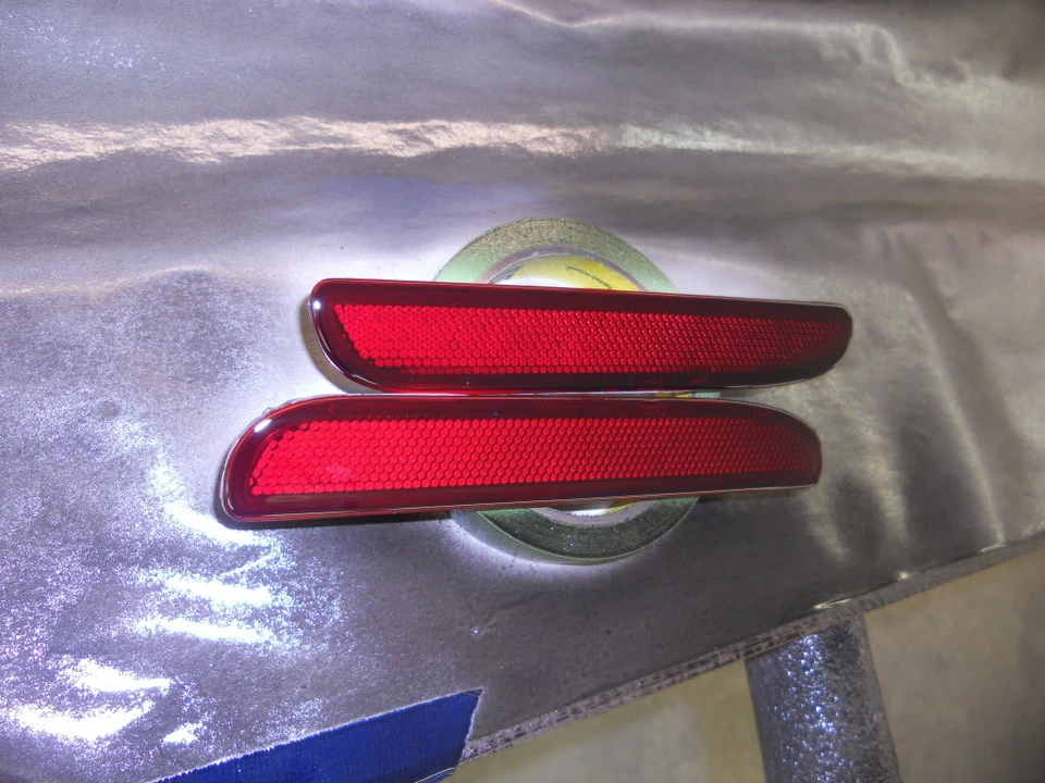

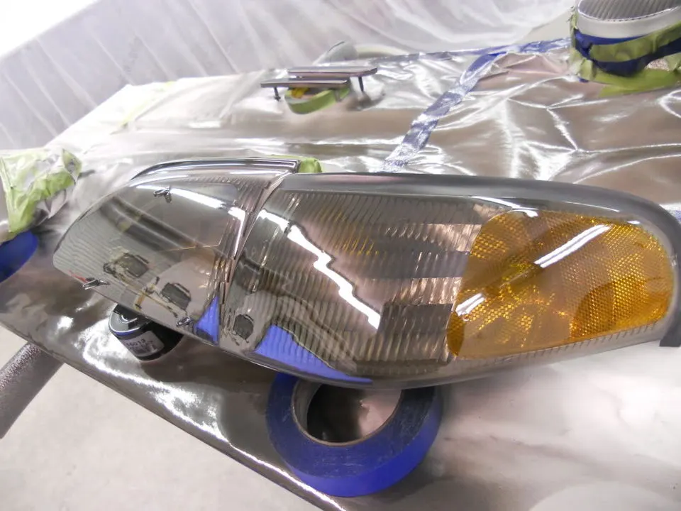

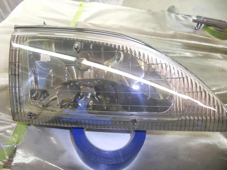

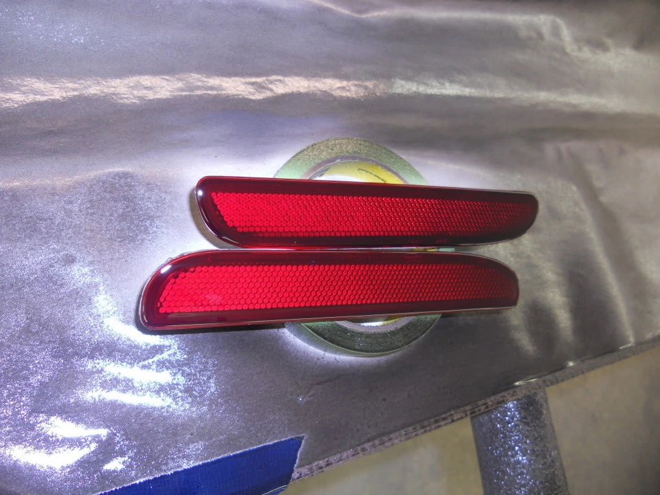

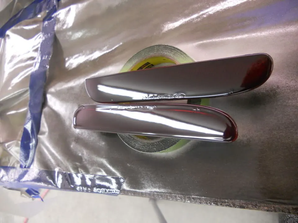

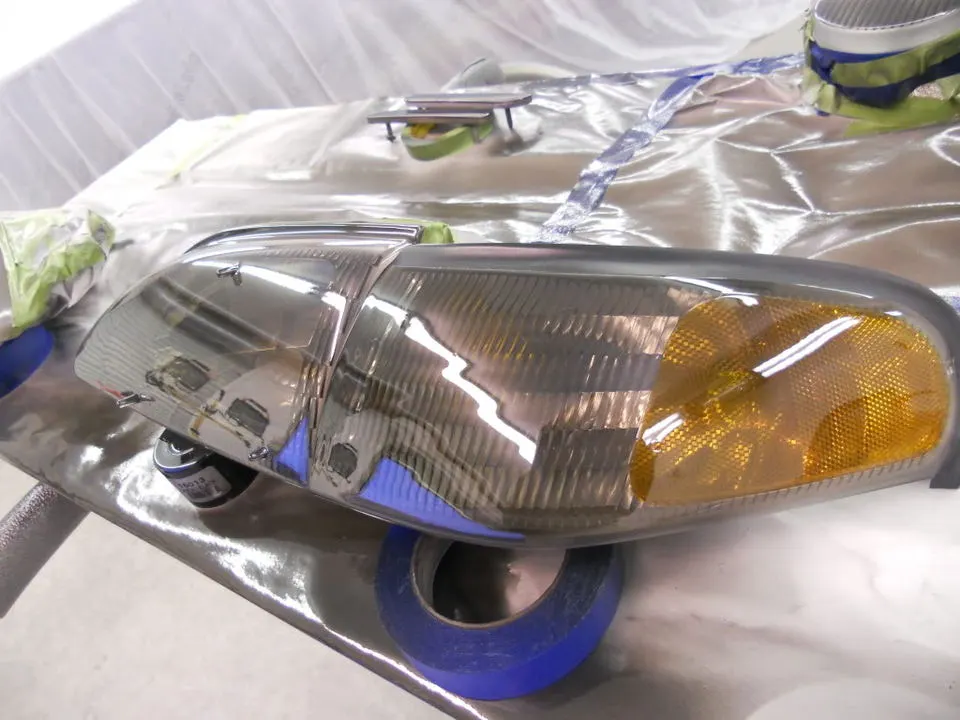

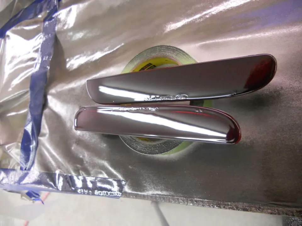

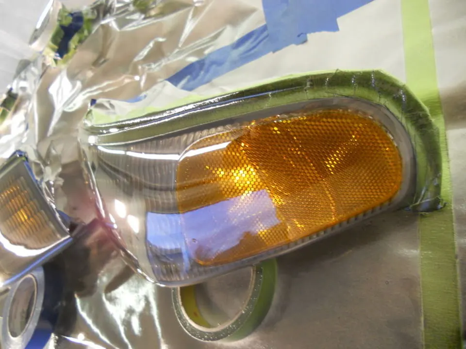

Headlights fog lights and reflectors are done. I found NOS Ford Cobra headlights and fog lights and reflectors then proceeded to sand them down and smoke them to match my taillights. This way I can have factory fit with a little better finish.
with the flash on
