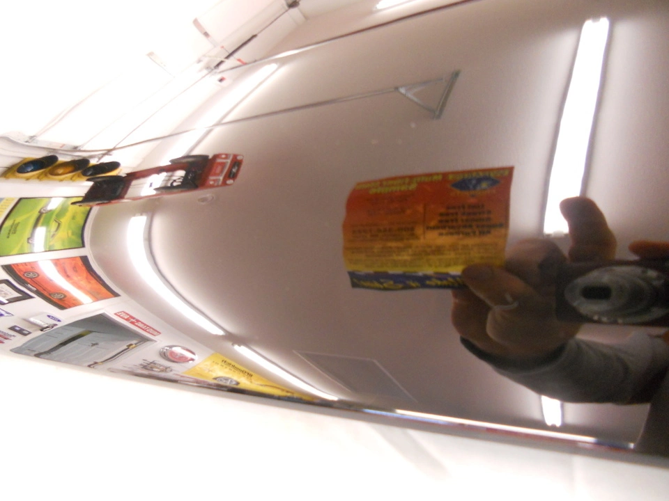

Damn, Gina! Your car is going to look sick. Most of the time anyone buffs black, all you see are the swirls.

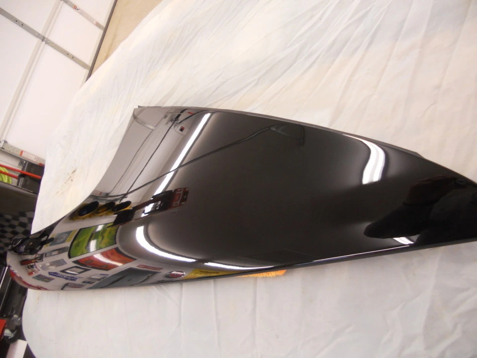

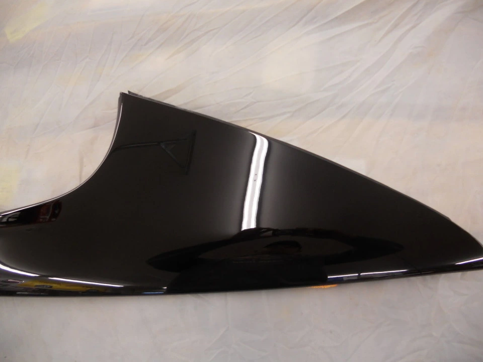

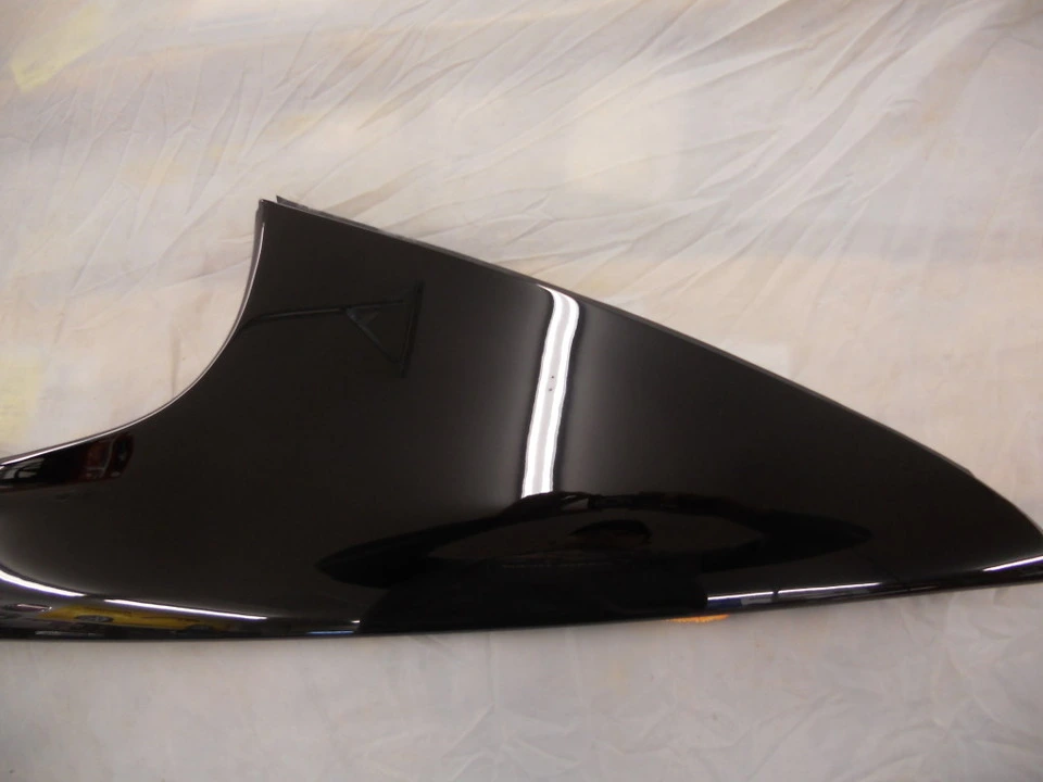

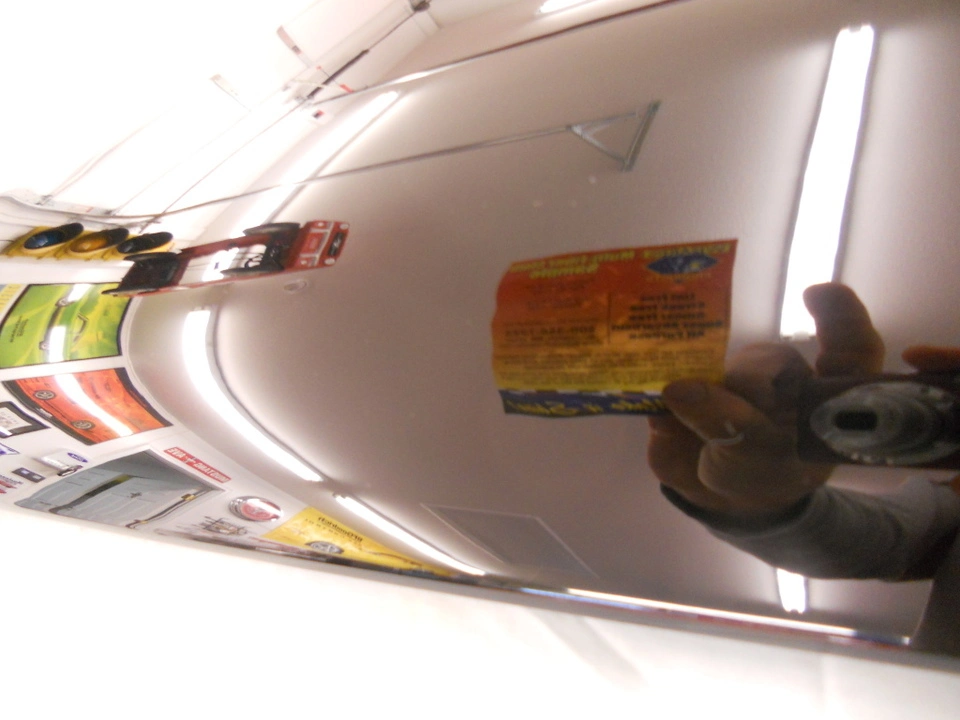

I have a couple of painted pieces done. The sail panels have been wet sanded with 1500, 2000, 2500 and 3000, then buffed out.
Just gotta be patient and the rest of the car should look similar.

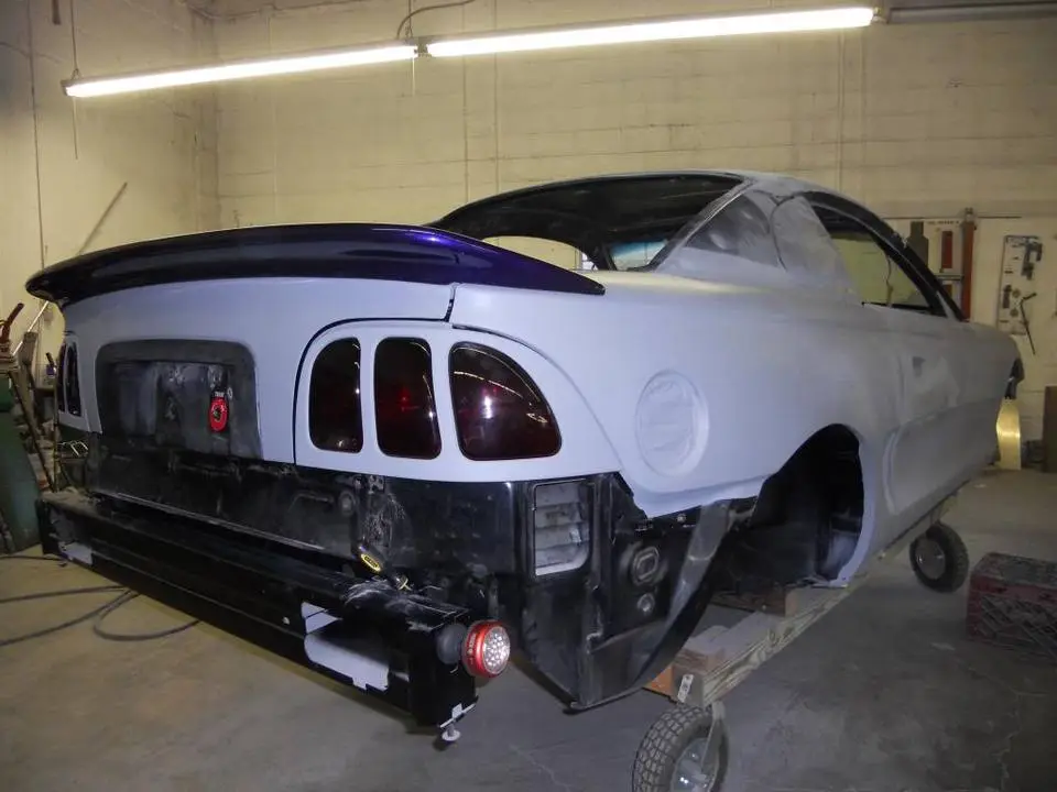

Thanks for the praise.

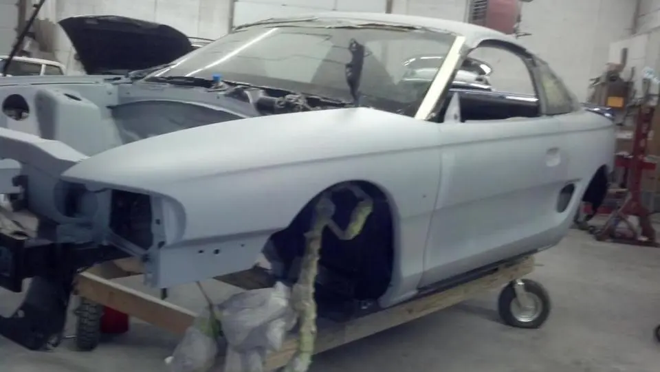

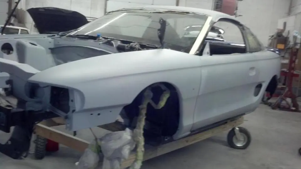

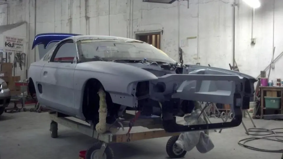

The fenders are primed again and bolted back on the car. Could be ready for a final blocking...we shall see.
Since its been off the road for two years on this build...I guess the Chevy windshield art is fitting.

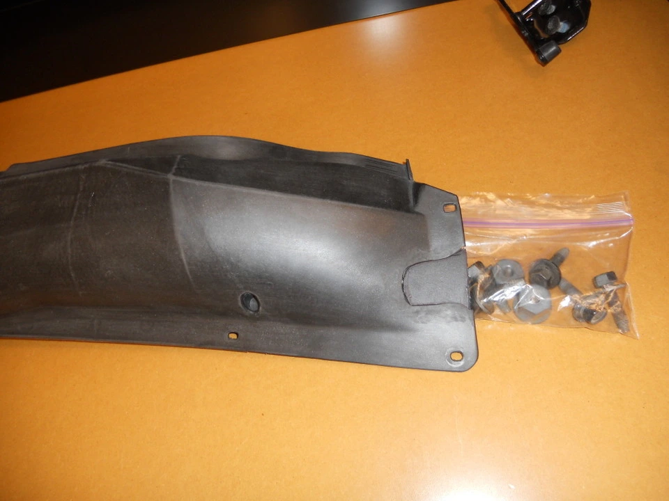

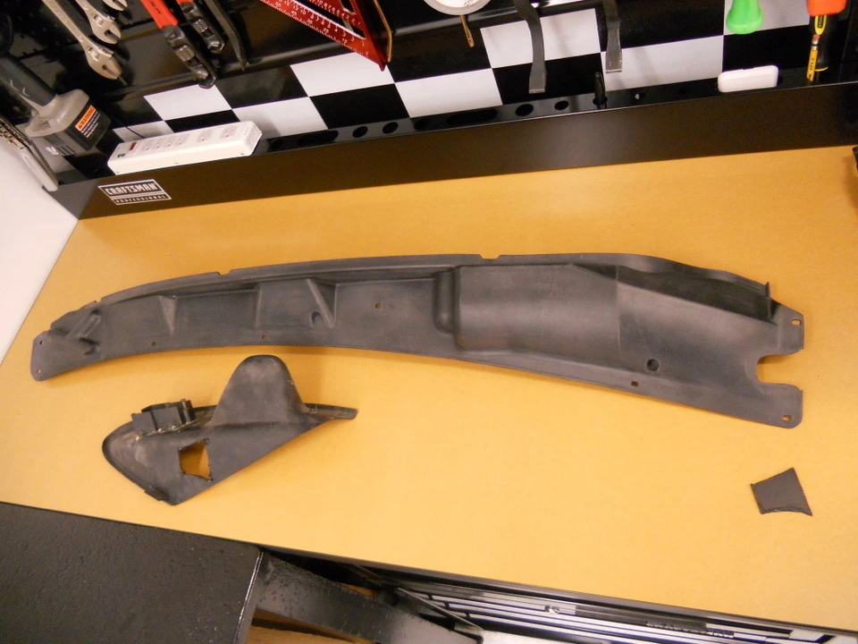

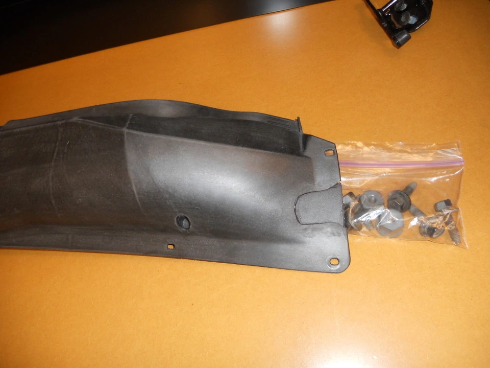

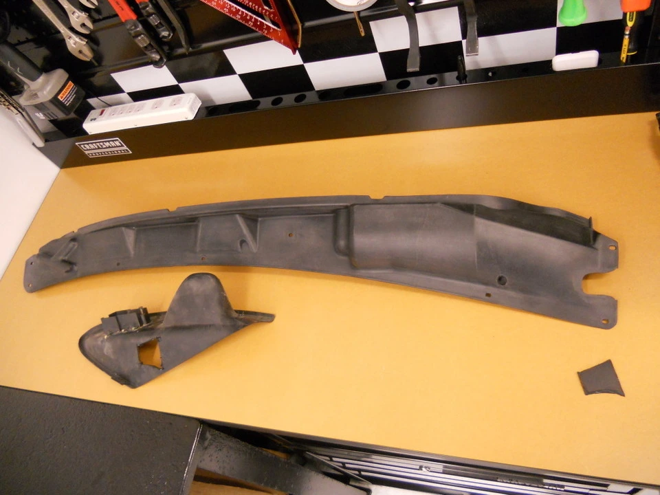

I hid all the wiring running through the wiper motor cover and into the fender well. I need to properly deleted that bulge. Something that I should have done on the last car. Here is the start of that.

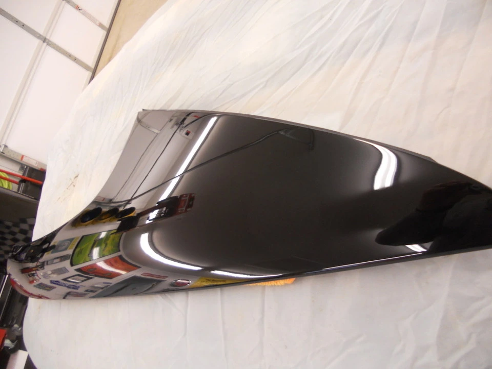

looks like it was sprayed w/ chrome....good god lol
Thanks man! That's what I was going for.
are you going to paint that piece ?
Yep...Got in melted solid, then lots of sanding and then more sanding. Just got some primer on it.

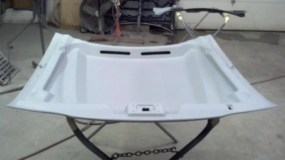

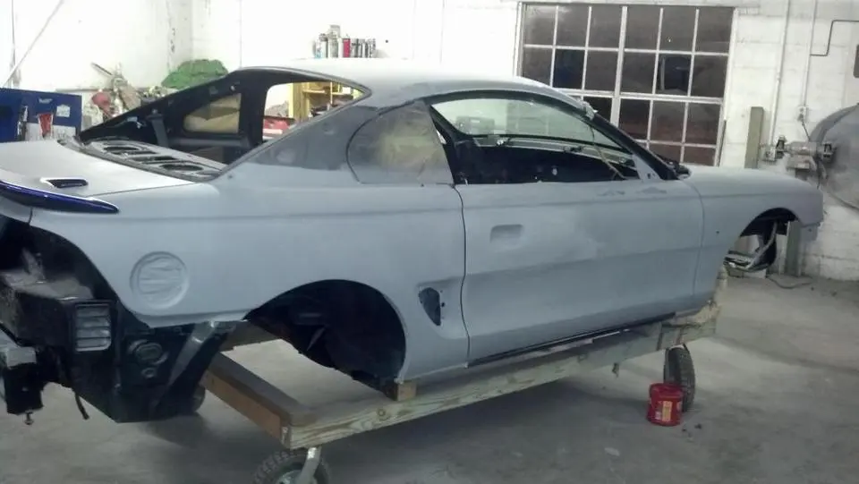

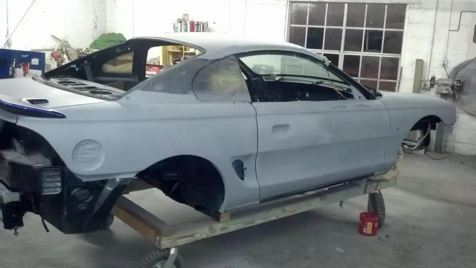

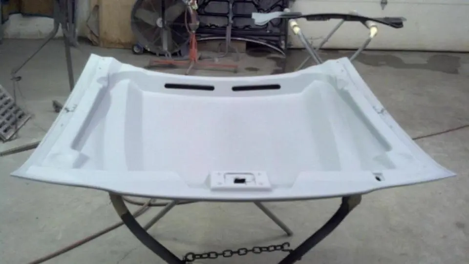

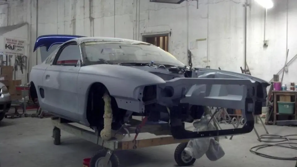

After a 3rd blocking and the fourth round of primer on the under side of the hood. Its finally coming around
Its all starting to come together. I will be bolting some more pieces up toward week end and making sure everything fits like it needs to.

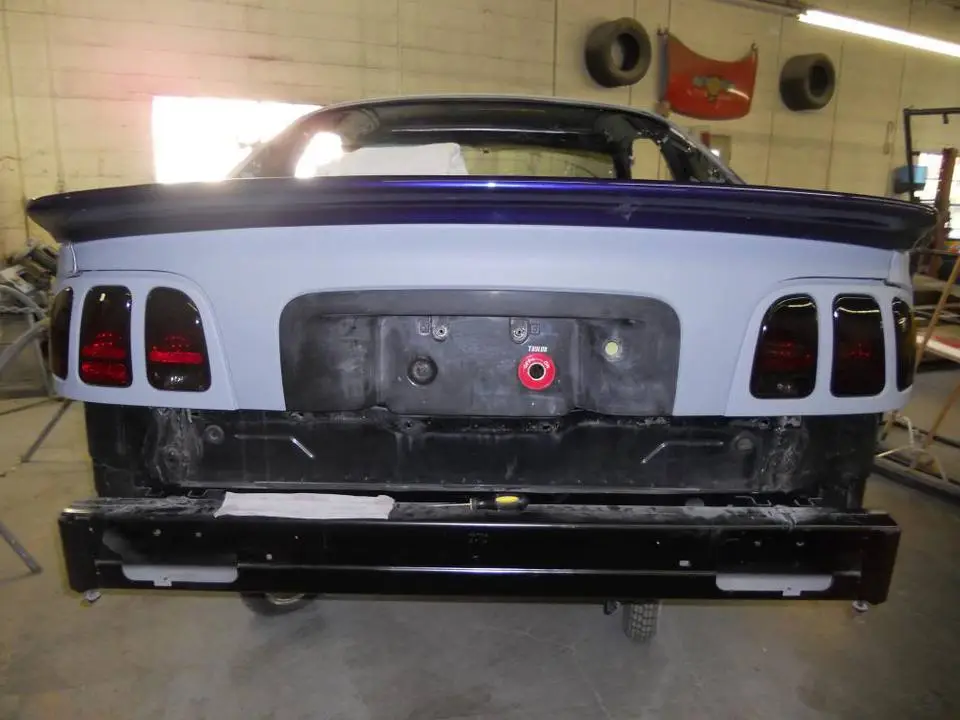

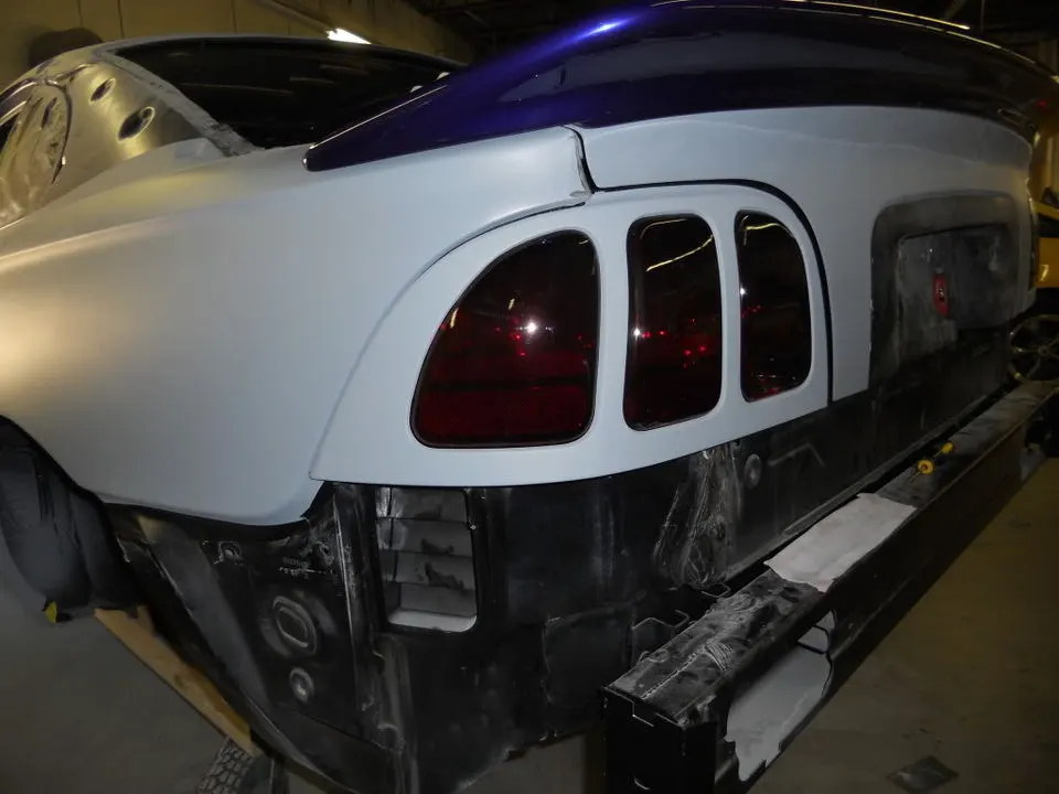

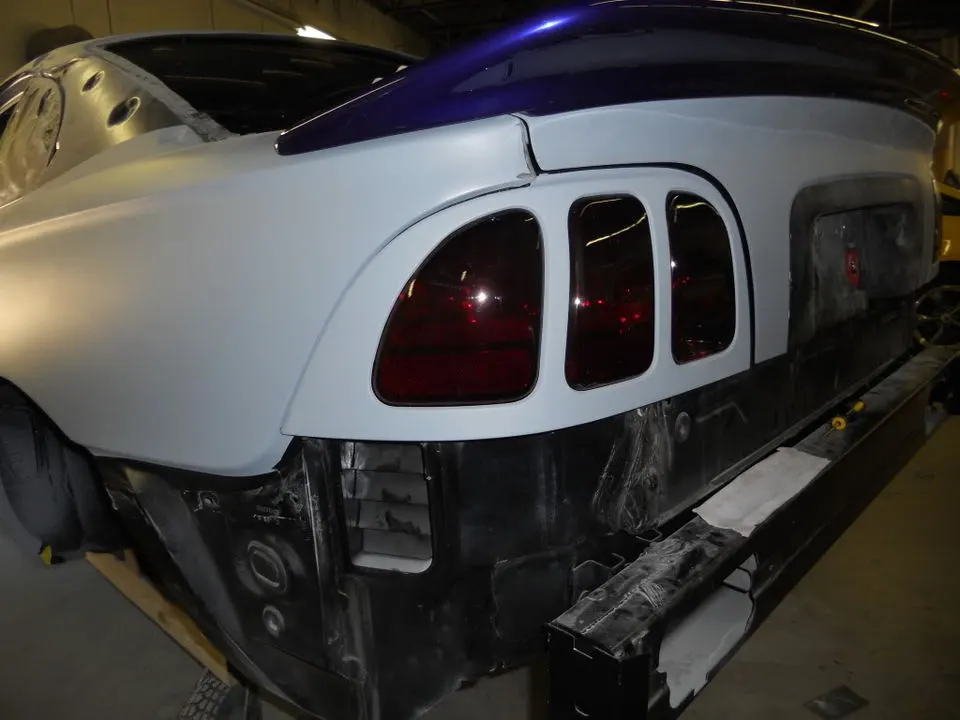

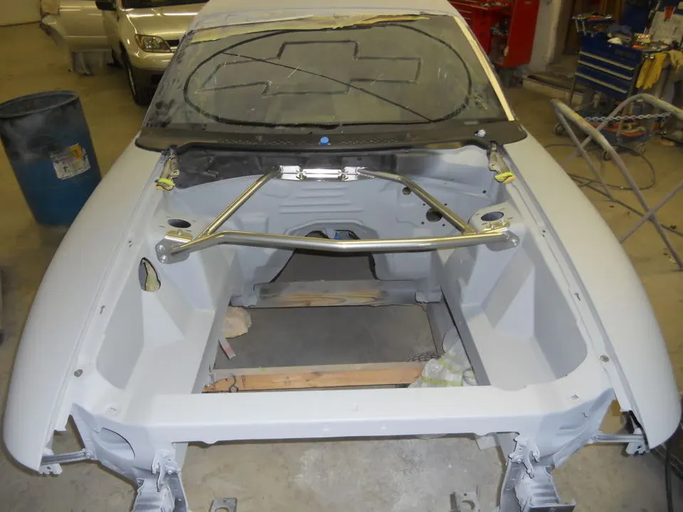

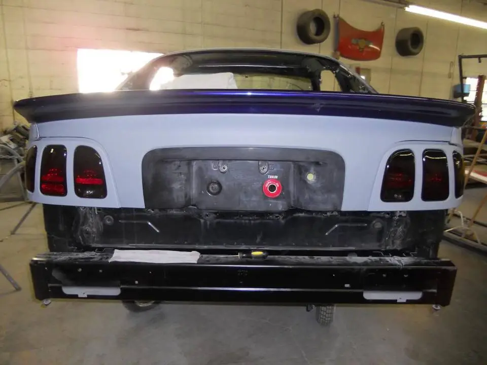

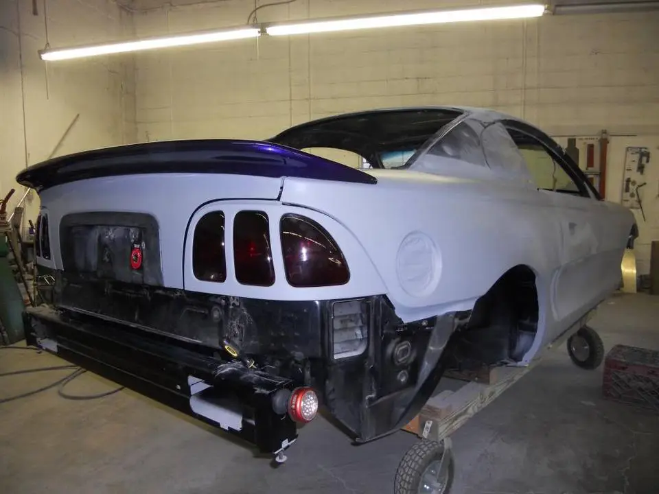

Got the trunk lid aligned yesterday by bolting up one of my taillight sets. Don't worry 94/95 tail light fans... I have those too.
Underside of the hood is ready for paint.

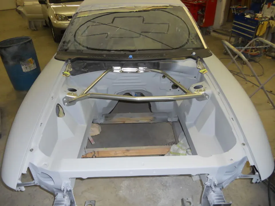

Also got my reworked wiper motor cover bolted back up and mocked up a strut tower brace. All went well.
