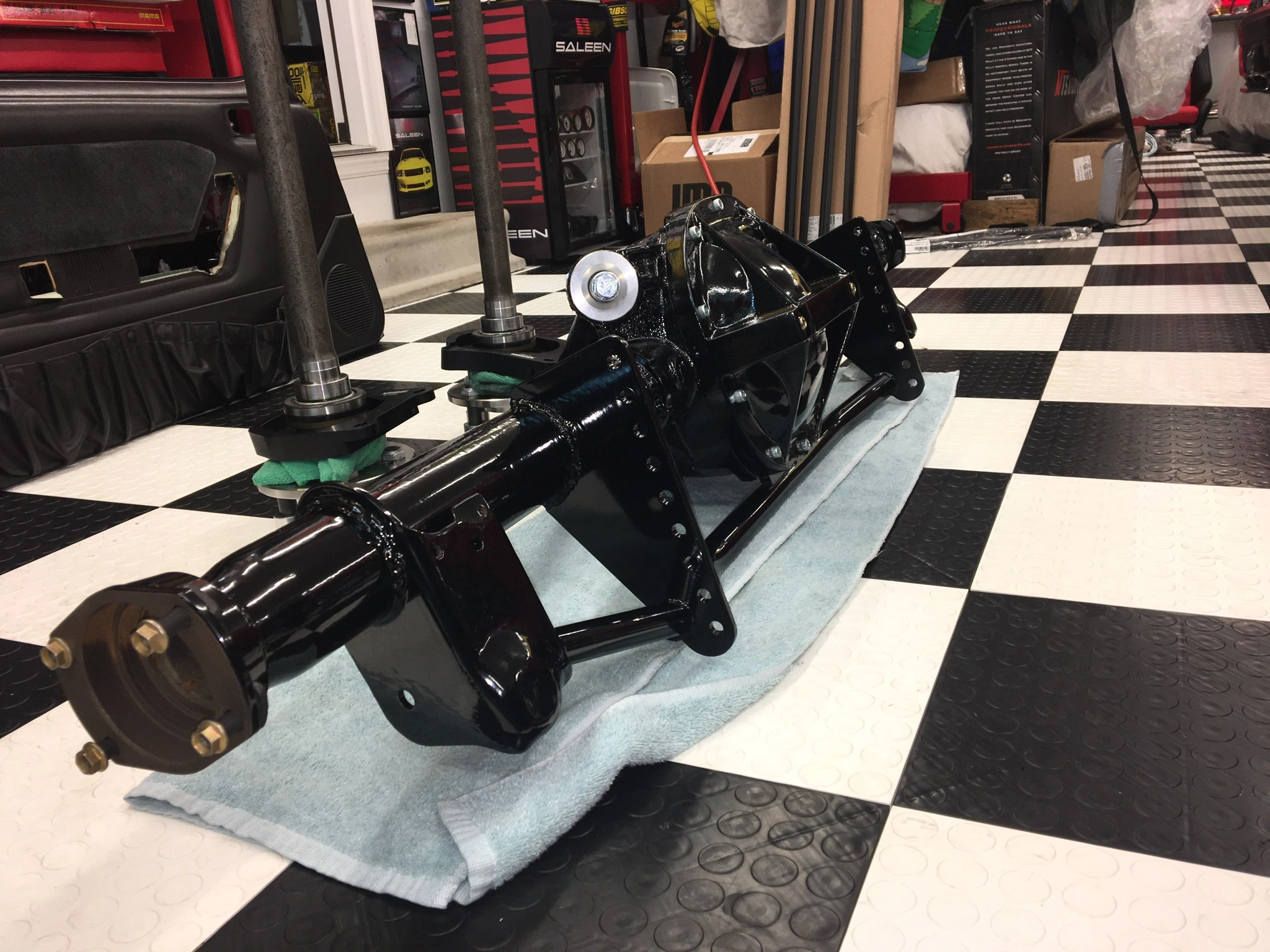

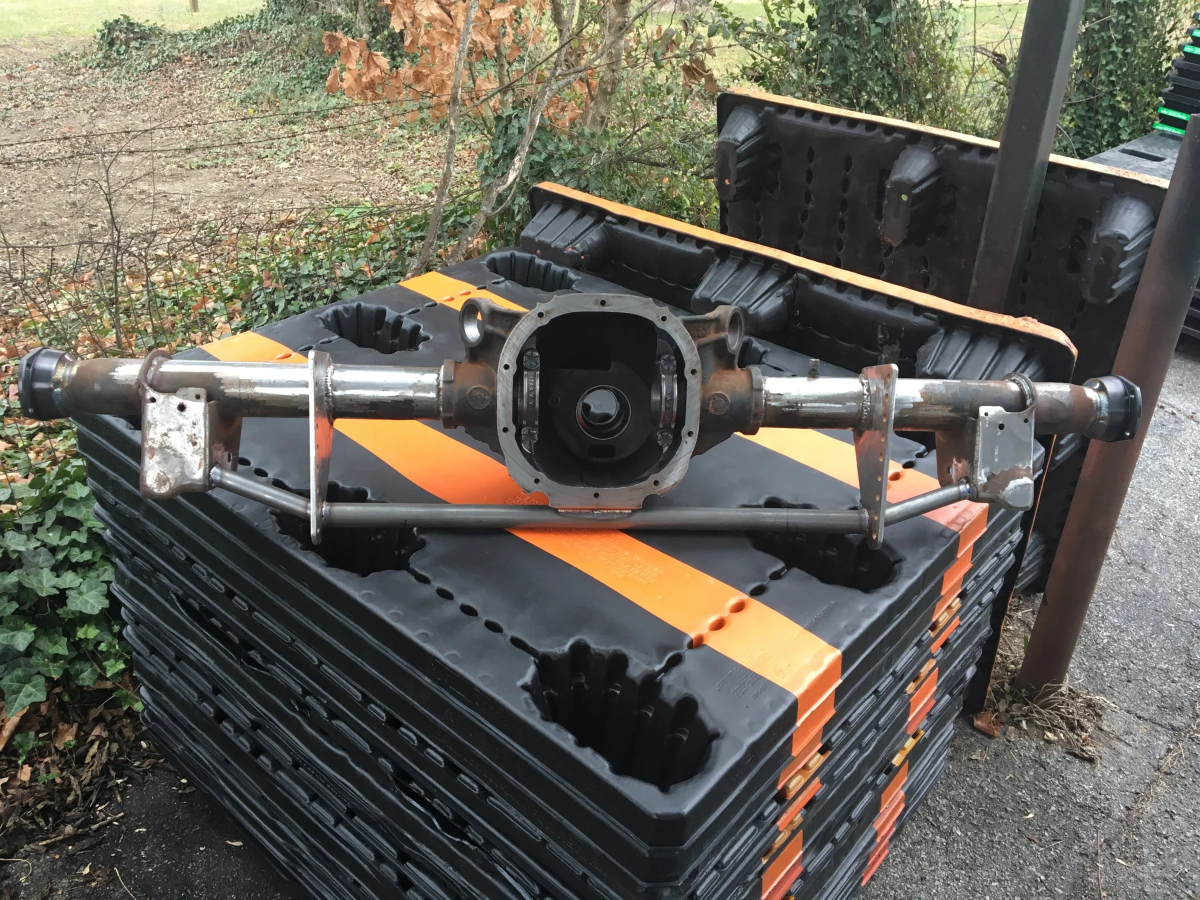

Dec 15, 2017
#1,307
  • Dec 15, 2017
  • #1,307

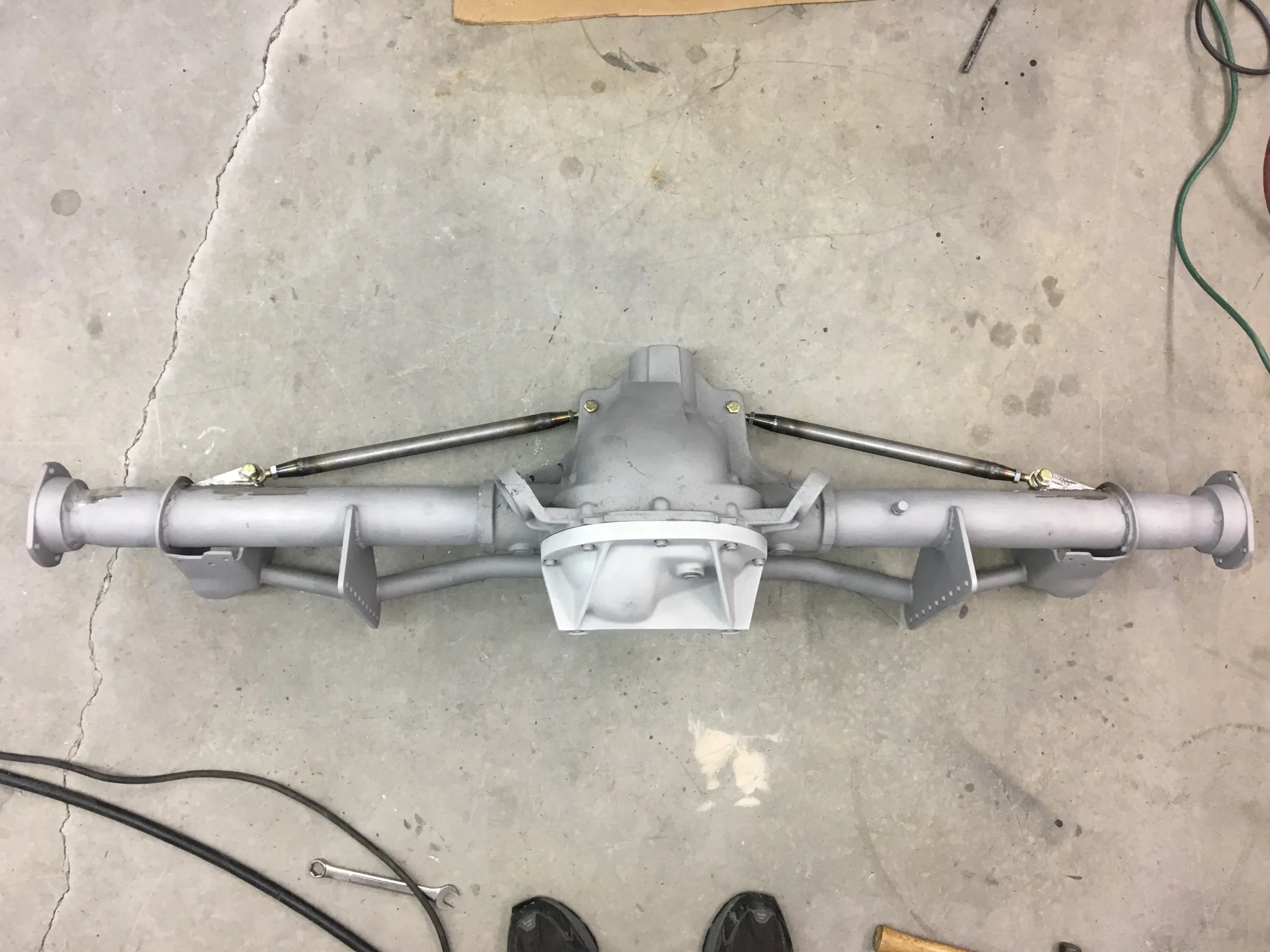

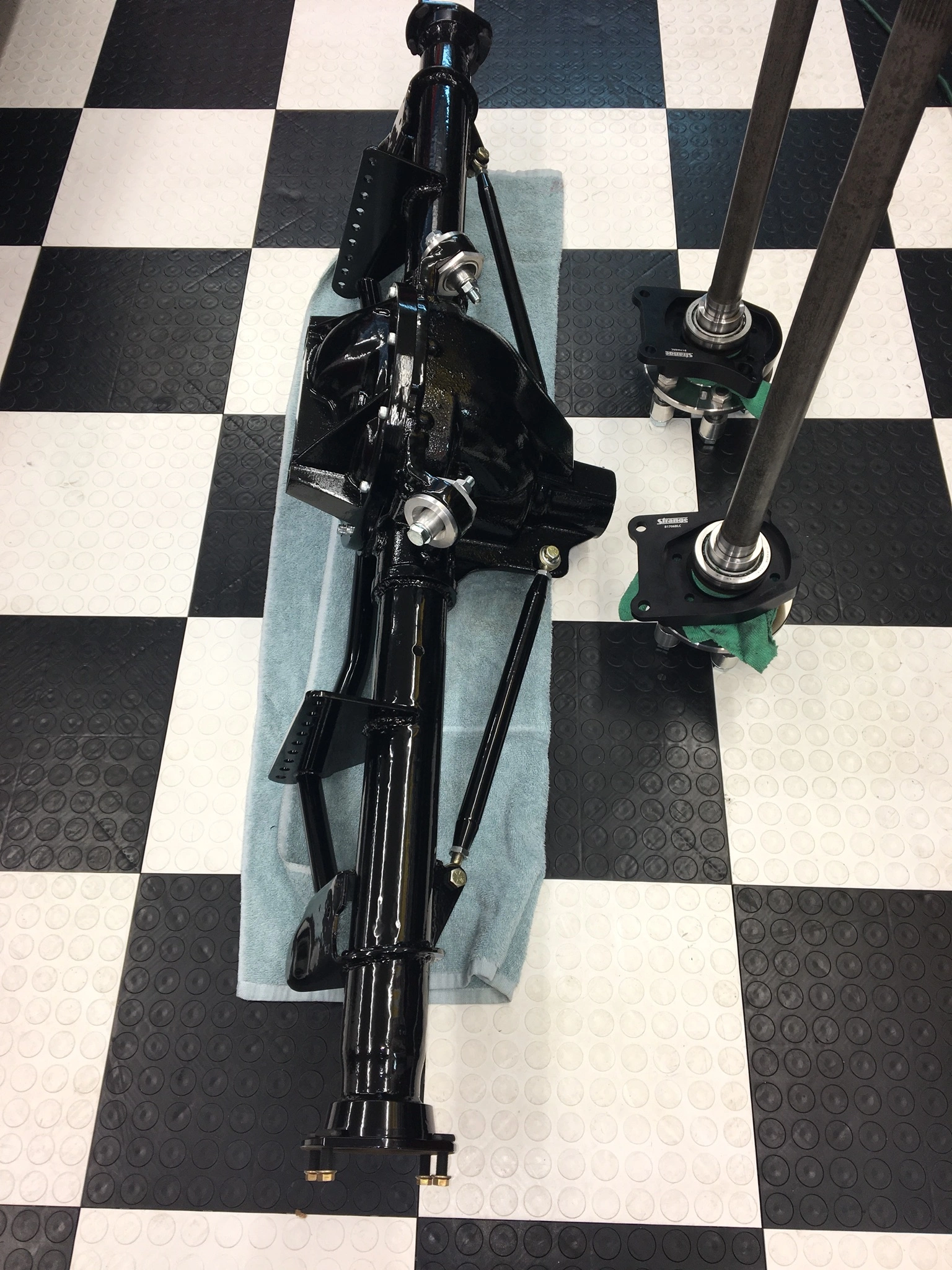

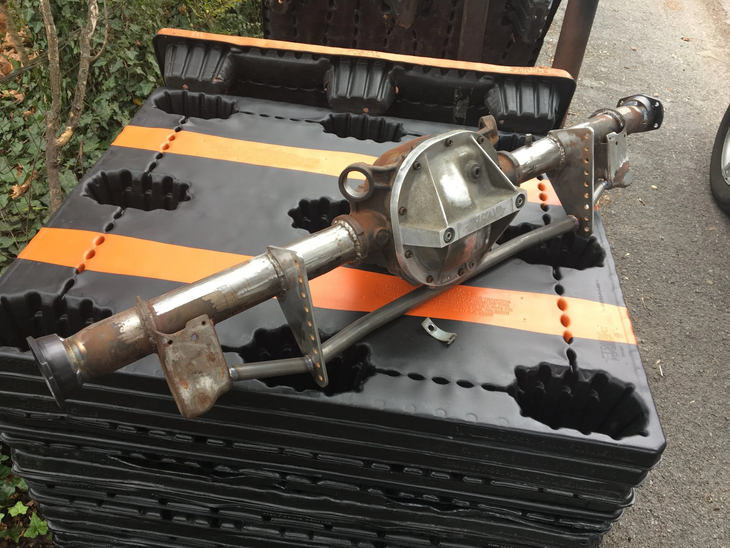

More rear end work. Just about ready for blasting and coating.
And building
Reactions: 90sickfox, 95BlueStallion, Davedacarpainter and 3 others
tannerc91gt
This last 25% is foreign territory at this point
4,392
2,967
Indiana
Dec 15, 2017
#1,308
  • Dec 15, 2017
  • #1,308
Looks like nice work on the rear end!
What will the rear brakes be? I’ve been eyeing a Strange brake package myself
95steedamustang
I tend to be on the ocd side…
SN Certified Technician
Apr 22, 2009
3,205
6,464
174
East TN
Dec 15, 2017
#1,309
  • Dec 15, 2017
  • #1,309
Thanks, I’ve really not decided. I can run any I want with these ends. I have a strange, aerospace, and wilwood kit on the shelf. I’ve used the strange kit on several cars and it’s really nice. If your debating, I would go for it.

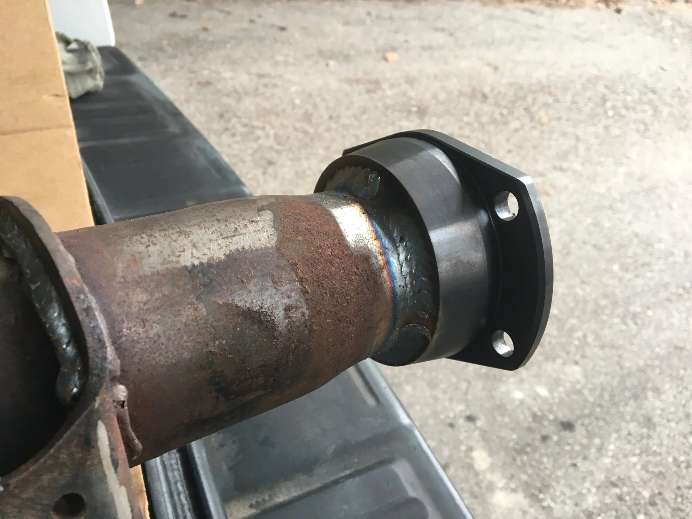

Dec 30, 2017
#1,310
  • Dec 30, 2017
  • #1,310

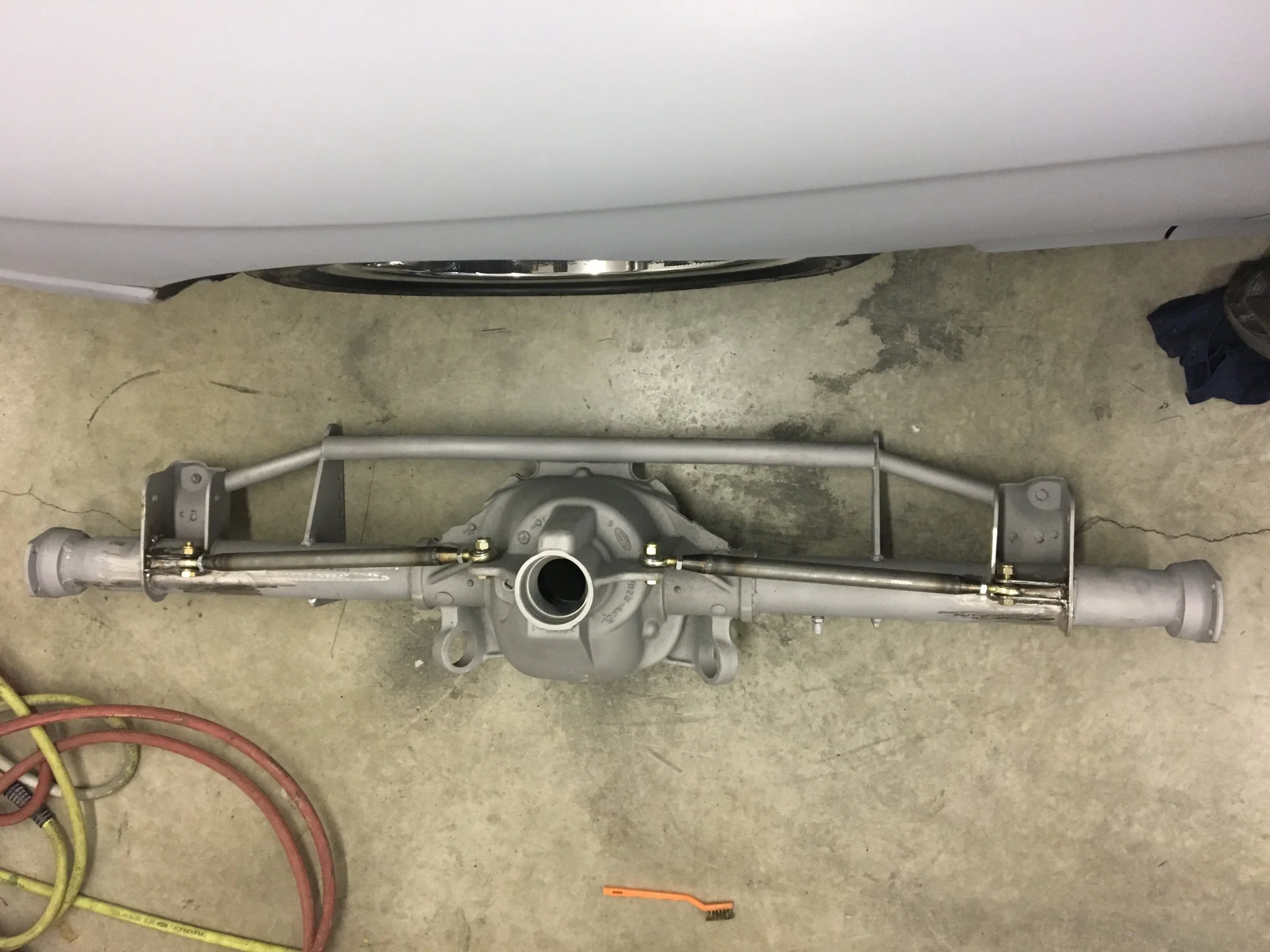

Finally ready for some Powdercoating
Reactions: RangerJoe, 95BlueStallion, RaggedGT and 2 others

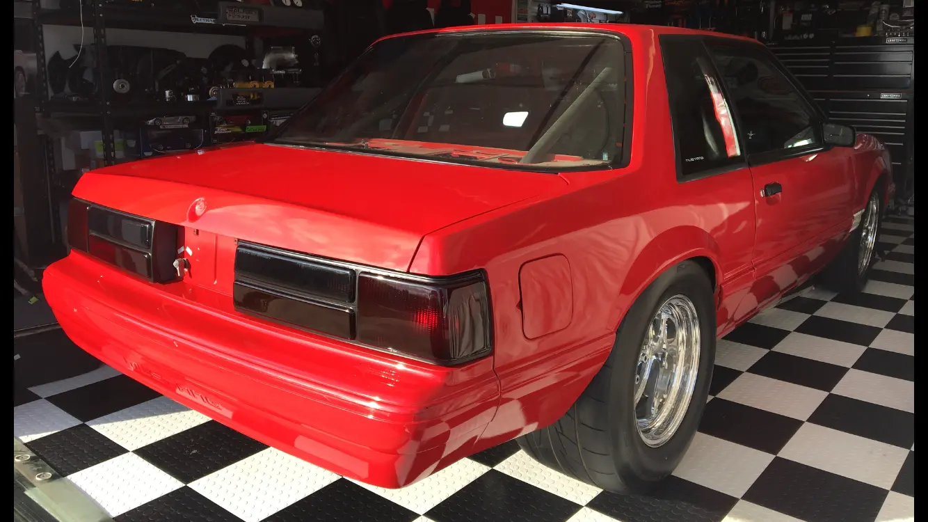

Jan 1, 2018
#1,311
  • Jan 1, 2018
  • #1,311

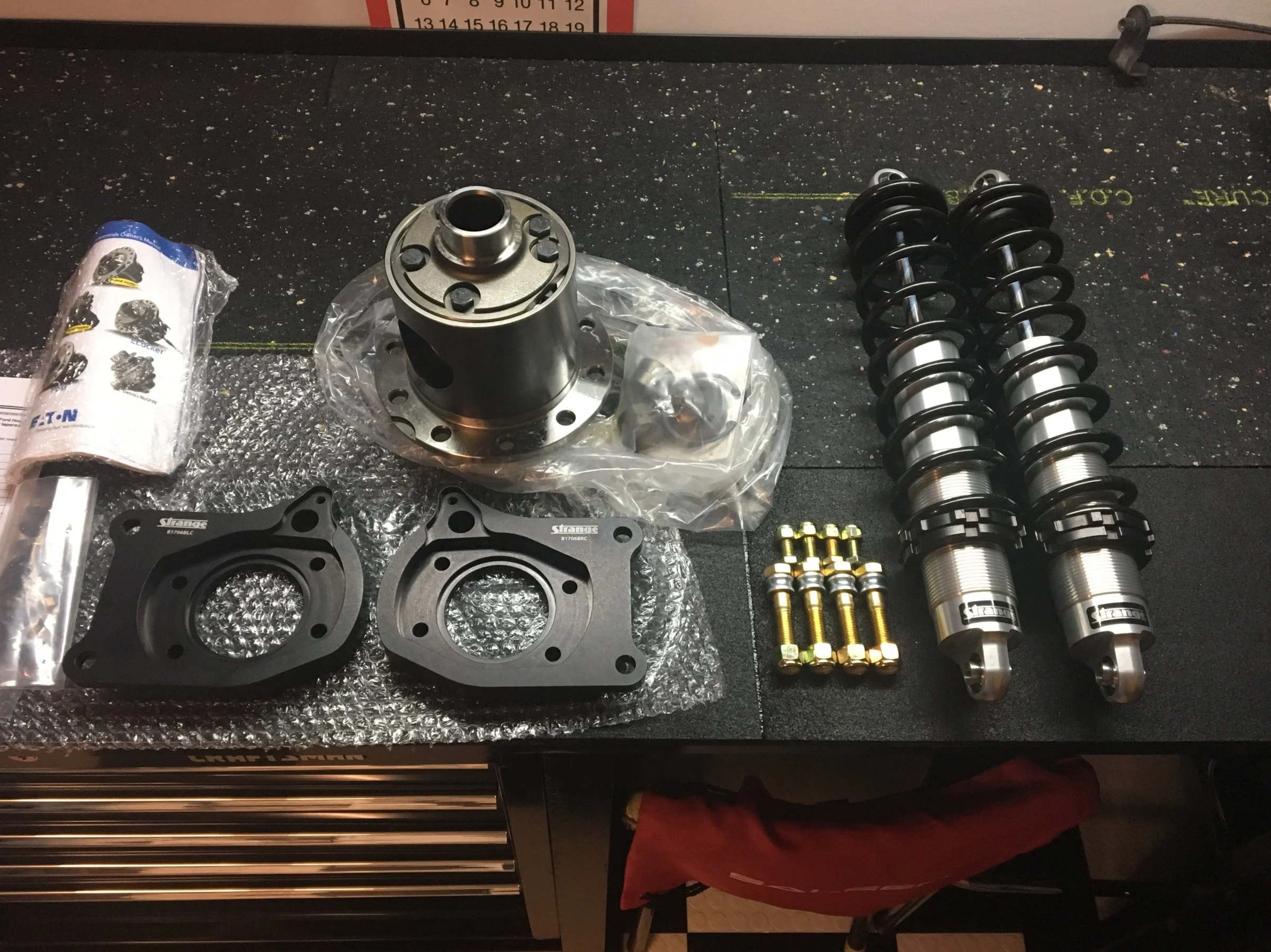

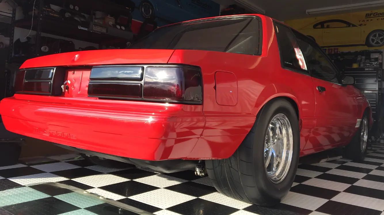

Got some more tweaks done on the little coupe.
Reactions: Willybill32, Mstng93SSP, 1990slow50H and 2 others
95BlueStallion
My assy trans to myself
Feb 22, 2007
5,130
3,103
214
Cedar Rapids, Iowa
Jan 1, 2018
#1,312
  • Jan 1, 2018
  • #1,312
The "little" couple, lol. Just driving around Miss Daisy in it I see.
Rough guess, when do you plan to start spraying the Cobra?
95steedamustang
Apr 22, 2009
3,205
6,464
174
East TN
Jan 1, 2018
#1,313
  • Jan 1, 2018
  • #1,313
I’m going to get the car running, tuned and dynoed. Then I’ll blow it apart and paint it. So it just depends on how long all that takes.
Reactions: RangerJoe and 95BlueStallion

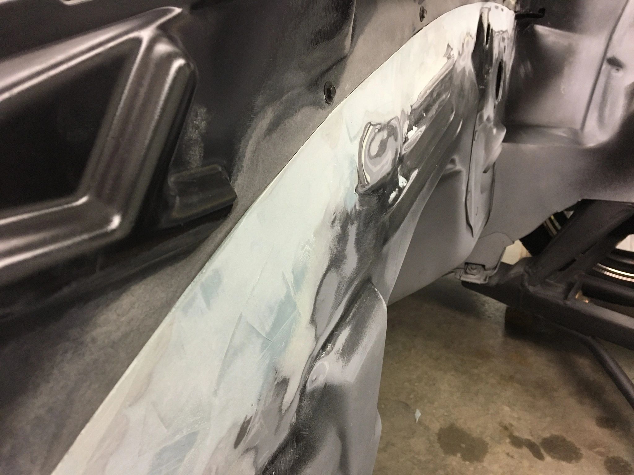

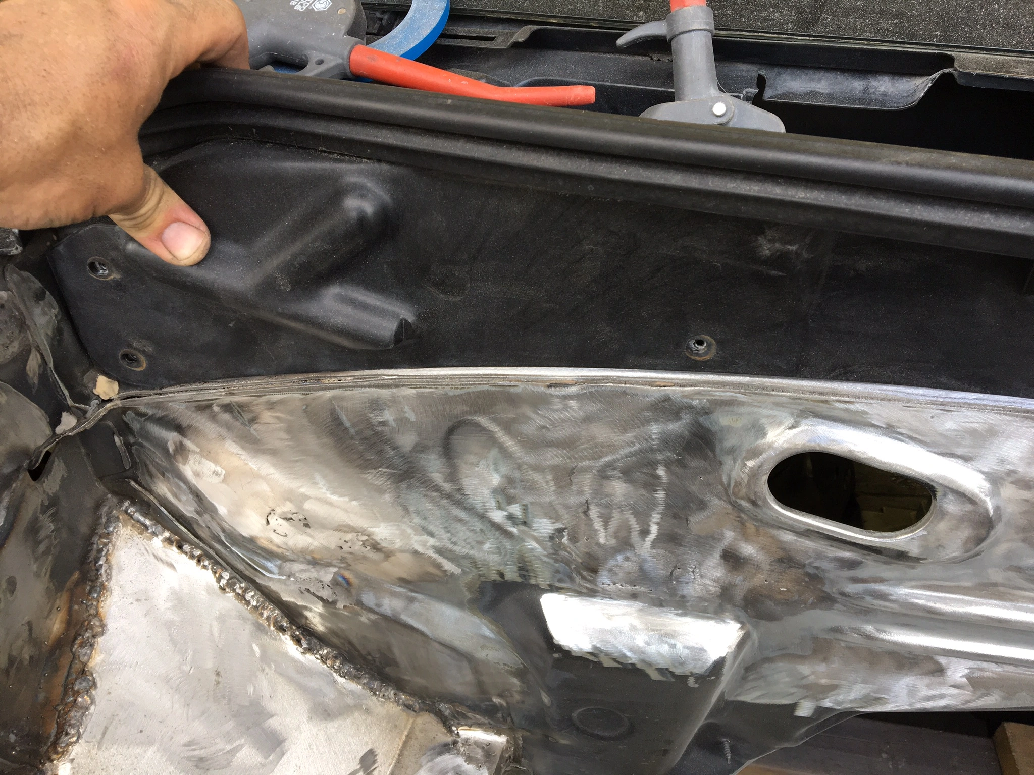

Feb 24, 2018
#1,314
  • Feb 24, 2018
  • #1,314
Reactions: RaggedGT, mikestang63 and 95BlueStallion
Davedacarpainter
Nov 28, 2015
11,833
11,634
203
Discordia
Feb 24, 2018
#1,315
  • Feb 24, 2018
  • #1,315

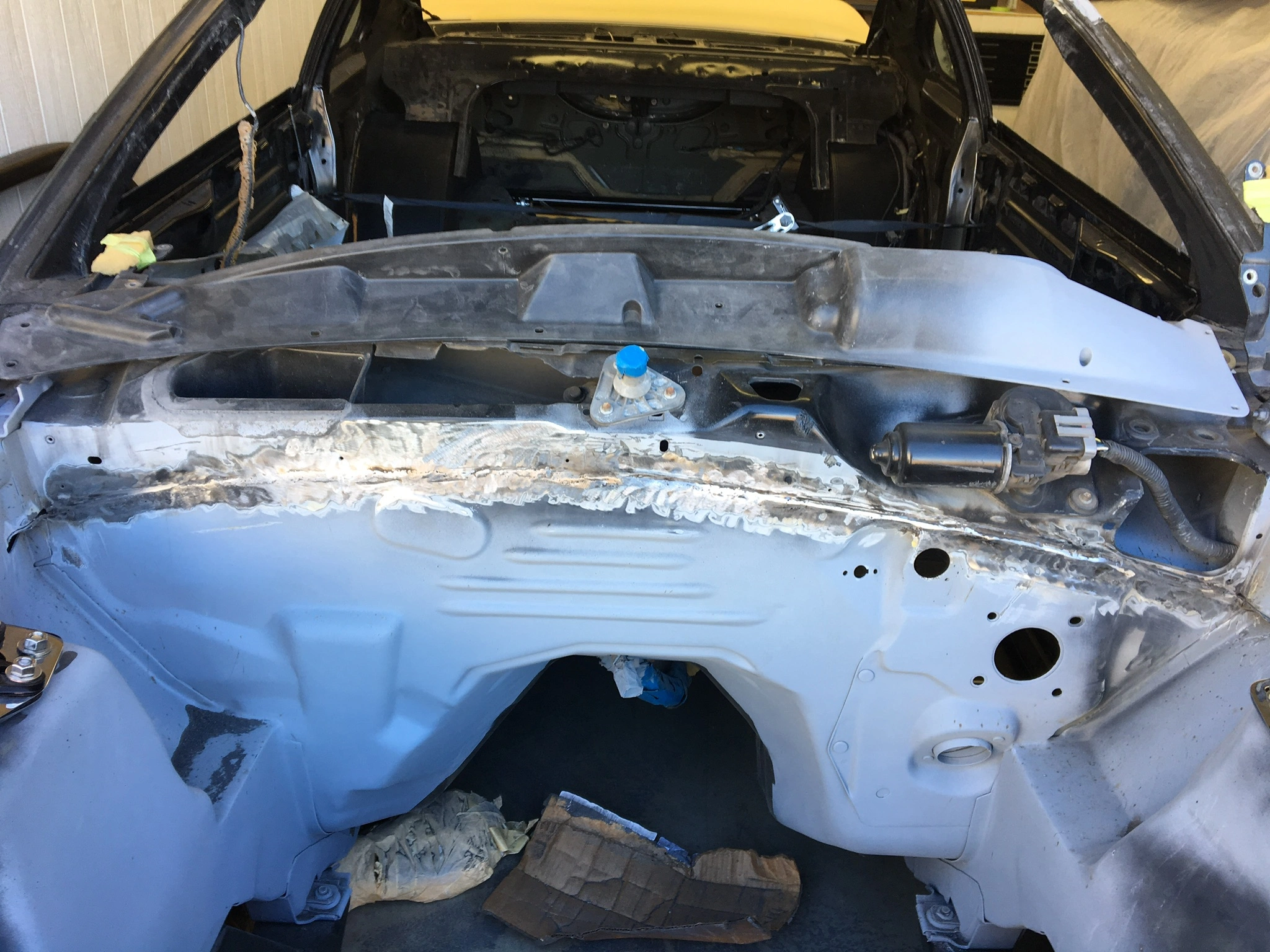

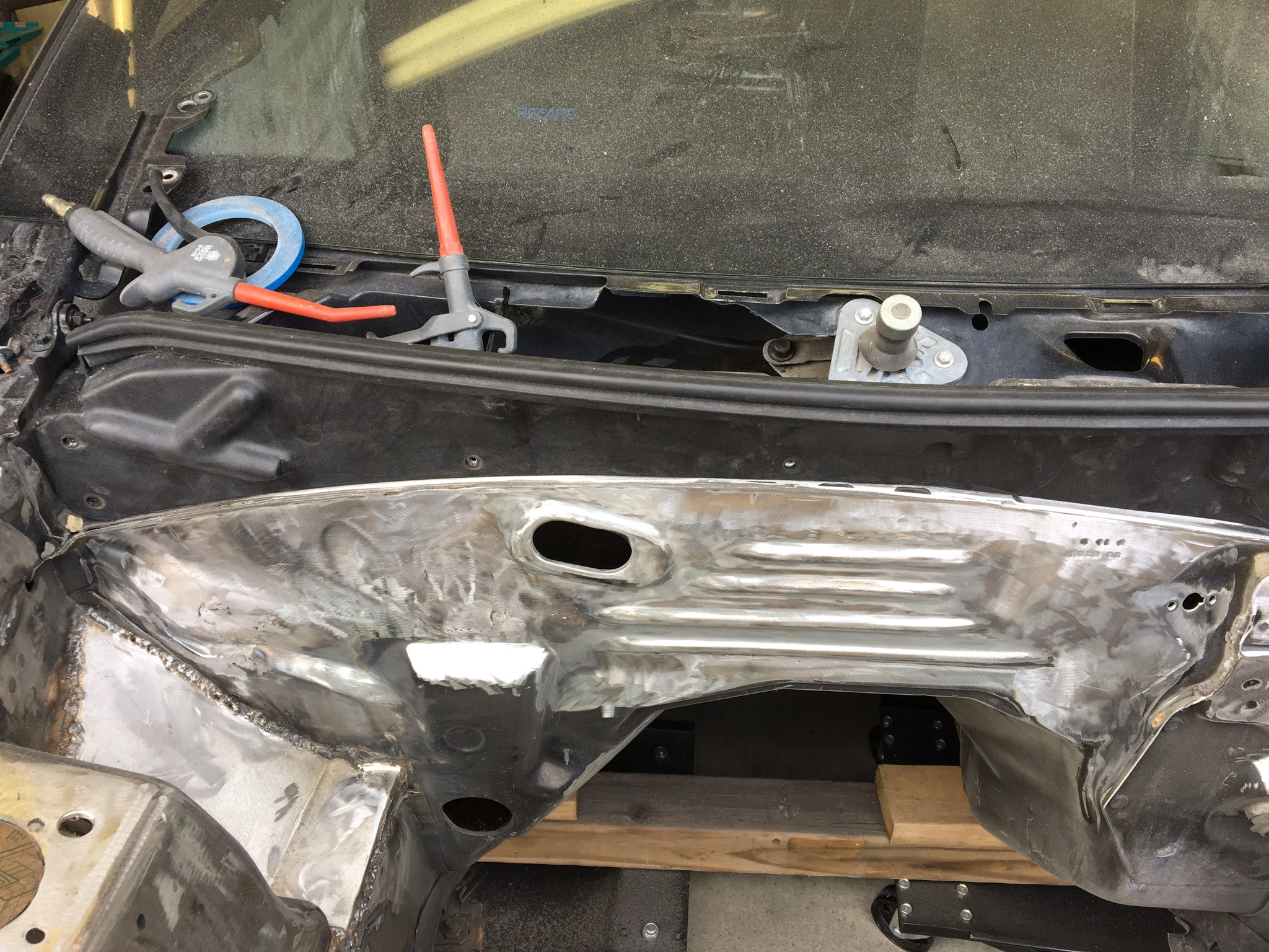

How difficult is it to completely smooth the eb seam Kevin?
Eventually I would like to do that in my blue car. Is there anything special I should do when I cut it completely off? Maybe cut off a little and spot weld across the seam area first then go back and stitch across?

95steedamustang
Apr 22, 2009
3,205
6,464
174
East TN
Feb 24, 2018
#1,316
  • Feb 24, 2018
  • #1,316
I want a powder coat oven too.
Yea, you pretty much nailed it. It’s just like shaving a drip rail on an old one. Which I’ll be doing again soon. Only the metal is much thinner. I cut and ground down a section at a time and tacked it as I went. Then went thru and completely welded it where you could look from the backside and not see any pinholes. Did the S-351 engine bay the same way about 8 months ago. And it also helps if you use the cowl cover as a template when welding and grinding it down. Oh and first remove as much seam sealer as you can from the back, so you don’t have to stop to keep putting out the stinking fire. Lol
Reactions: Davedacarpainter and 02 281 GT

That’s some attention to detail, right there.
You know it’s got to be an exact fit. But I actually go a few steps further when body work comes in, with the whole firewall getting blocked multiple times.

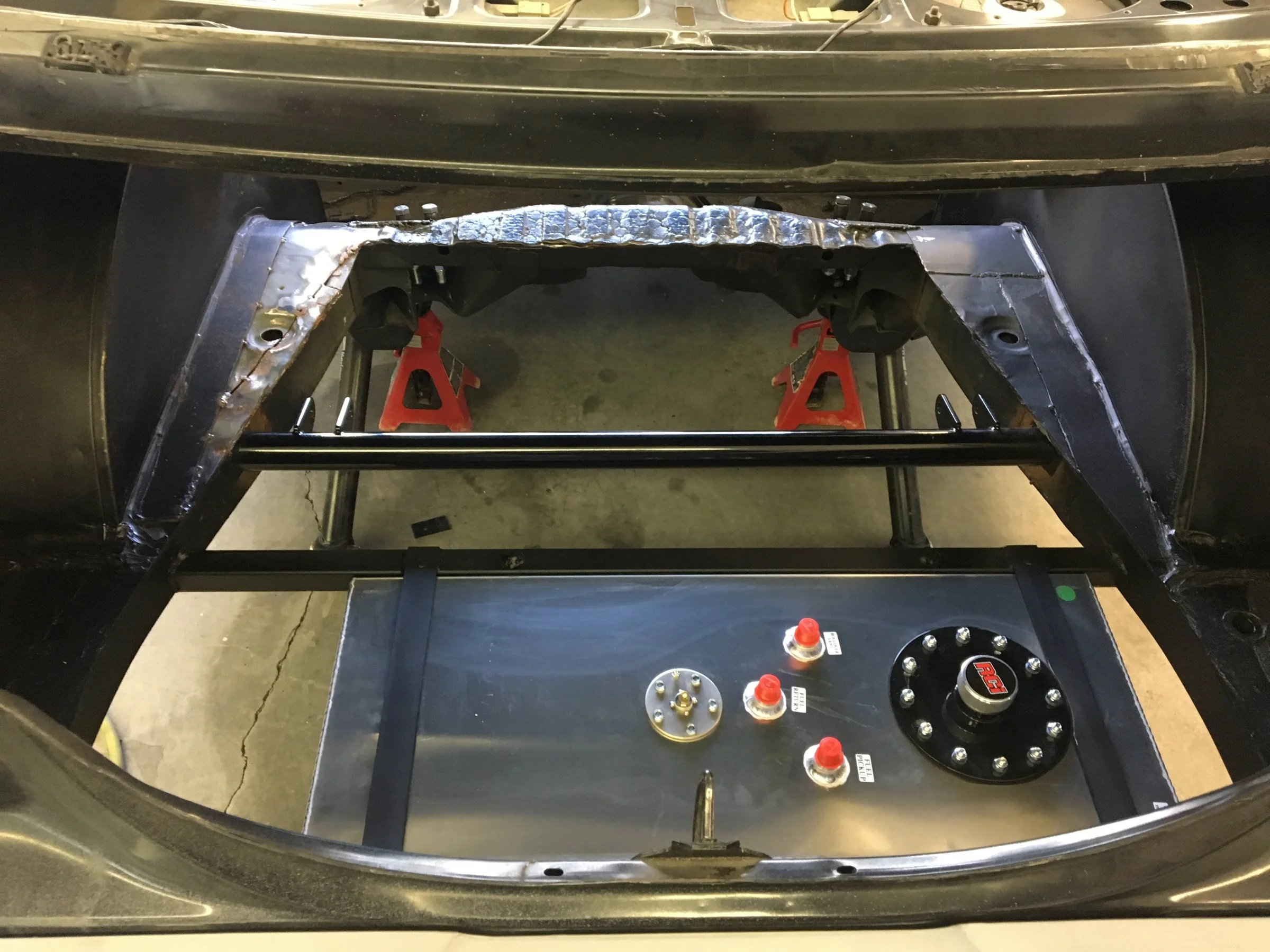

Mar 9, 2018
#1,319
  • Mar 9, 2018
  • #1,319

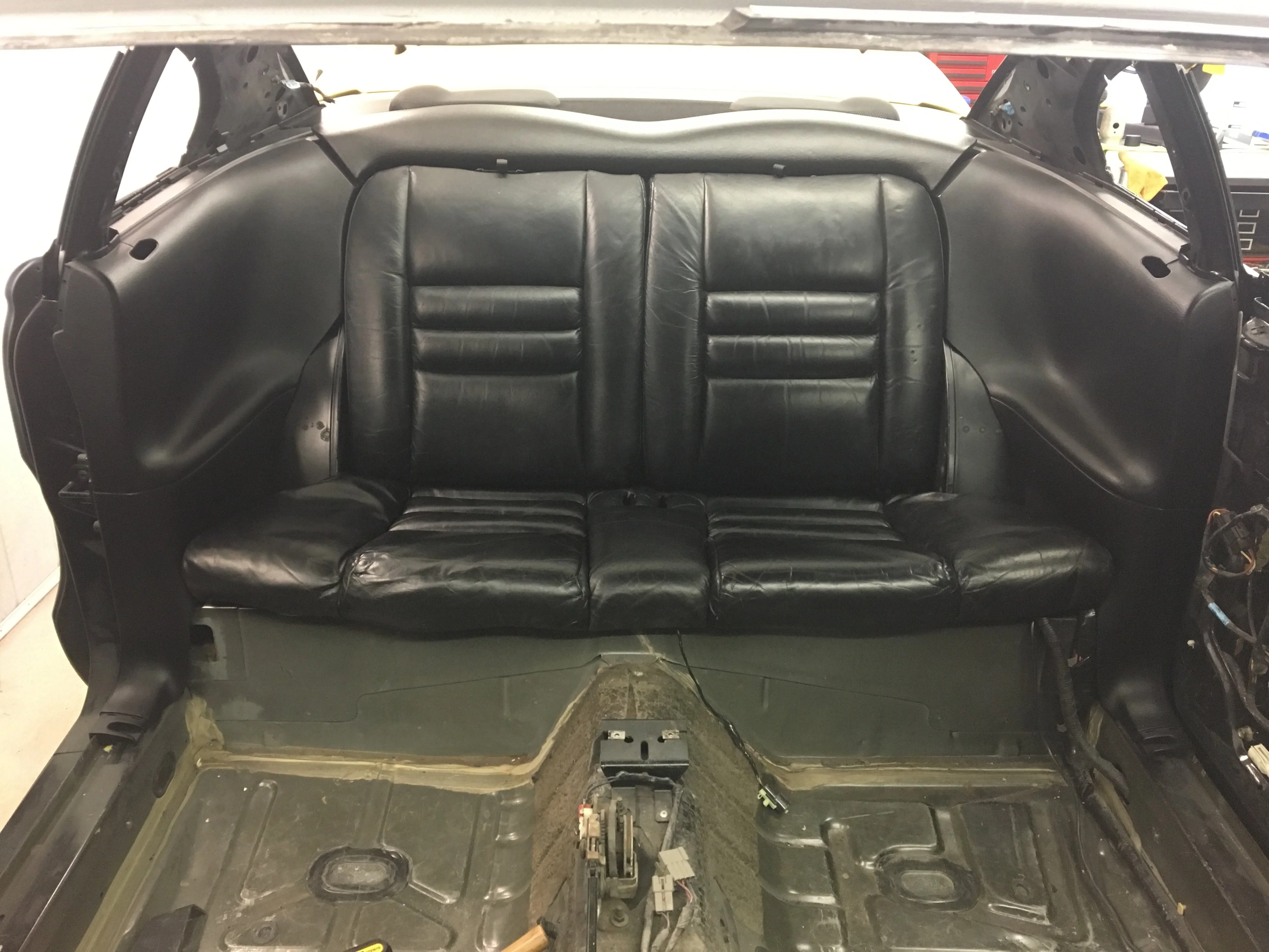

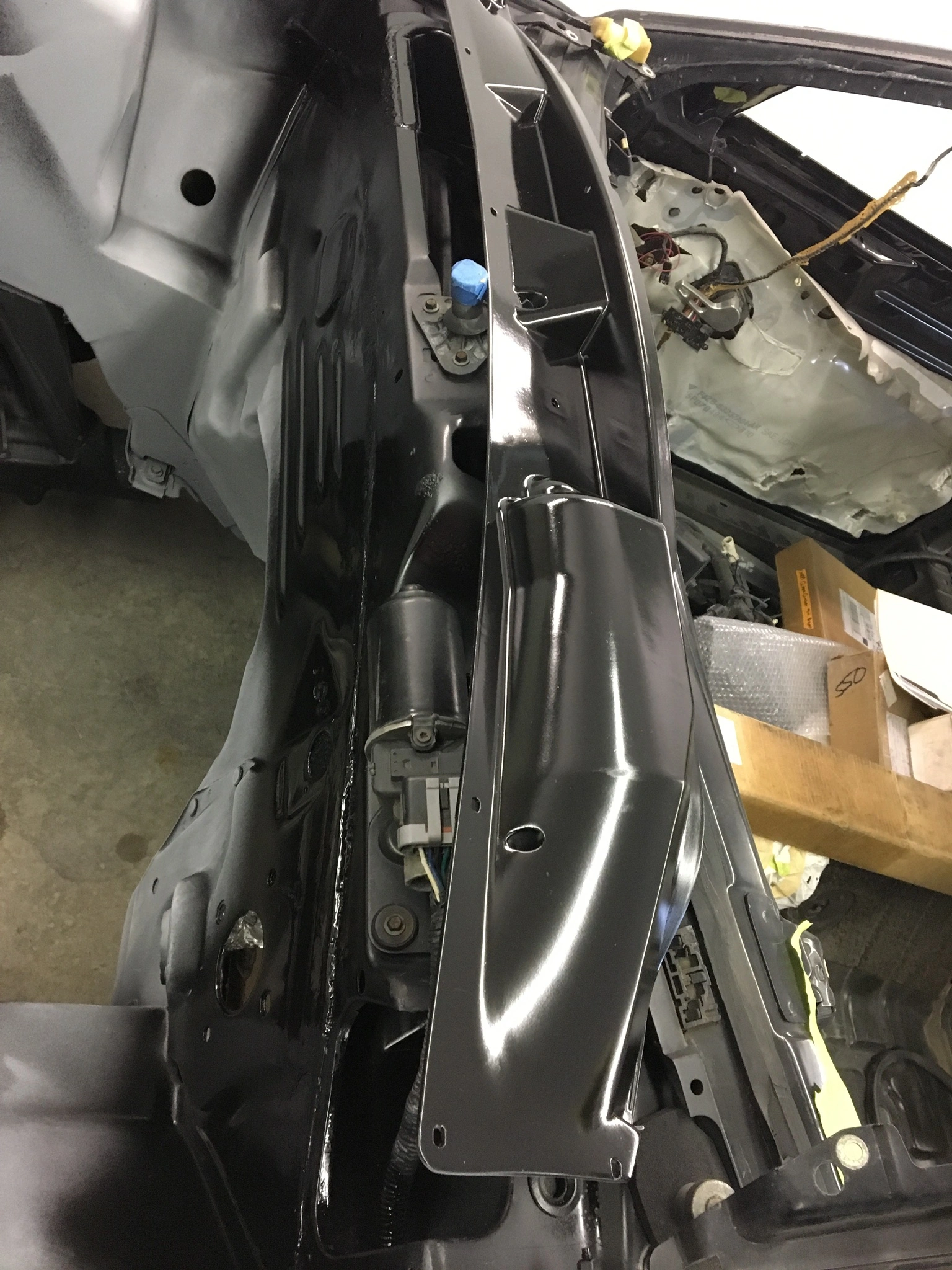

This is just for fittings I will be reupholstering the rear seats to match the fronts. I will also be adding to the panels and retexturing the to match the oem finish to close up the last remaining evidence of a mini tub. My goal is to make the mini tub completely hidden from the back seat or trunk.
Reactions: 02 281 GT and 95BlueStallion
Davedacarpainter
Nov 28, 2015
11,833
11,634
203
Discordia
Mar 9, 2018
#1,320
  • Mar 9, 2018
  • #1,320
You know Kevin, I remember you have a technique for redoing the texture. How do you match oem again?
