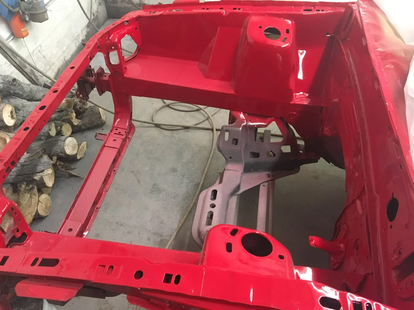

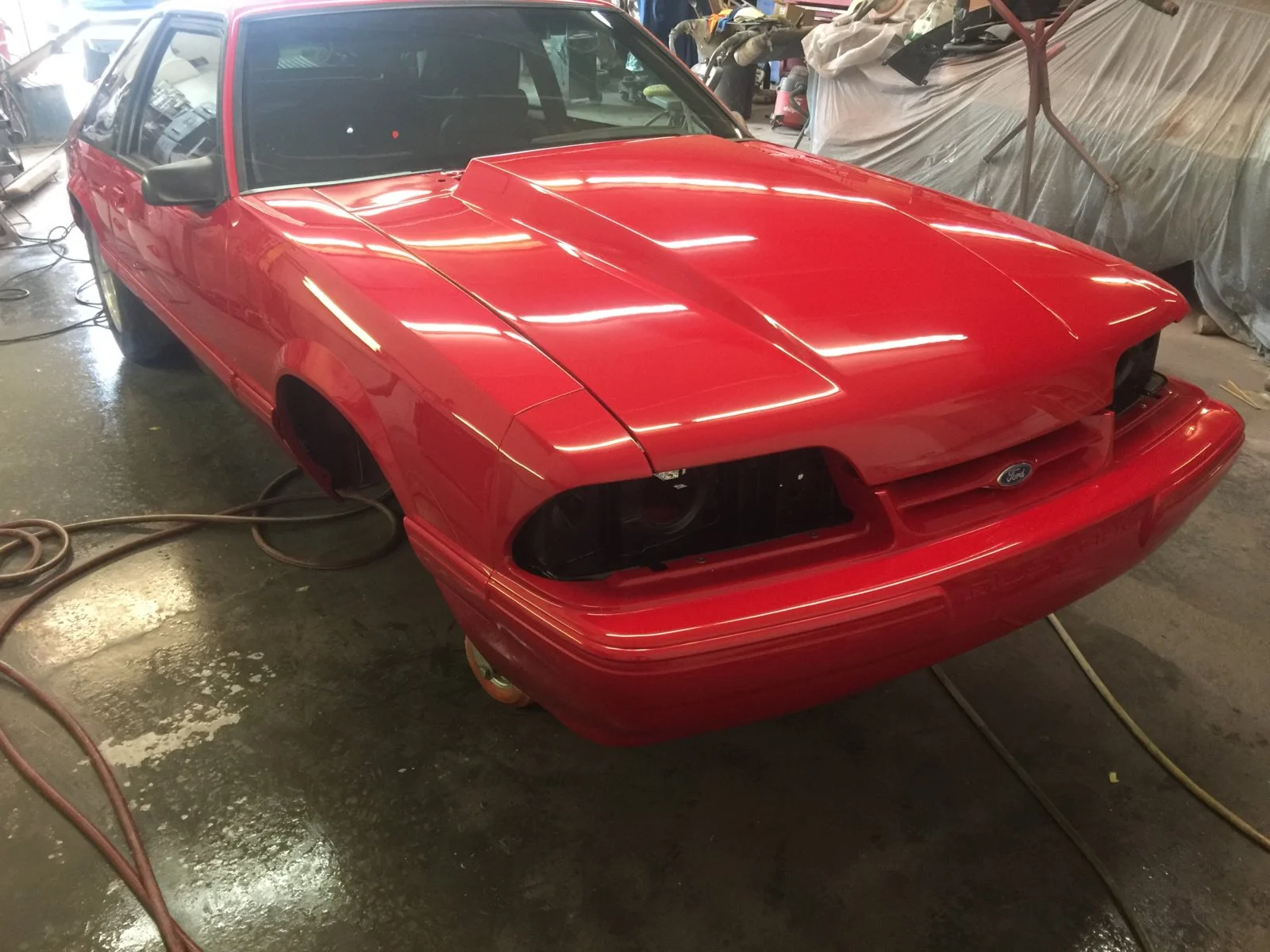

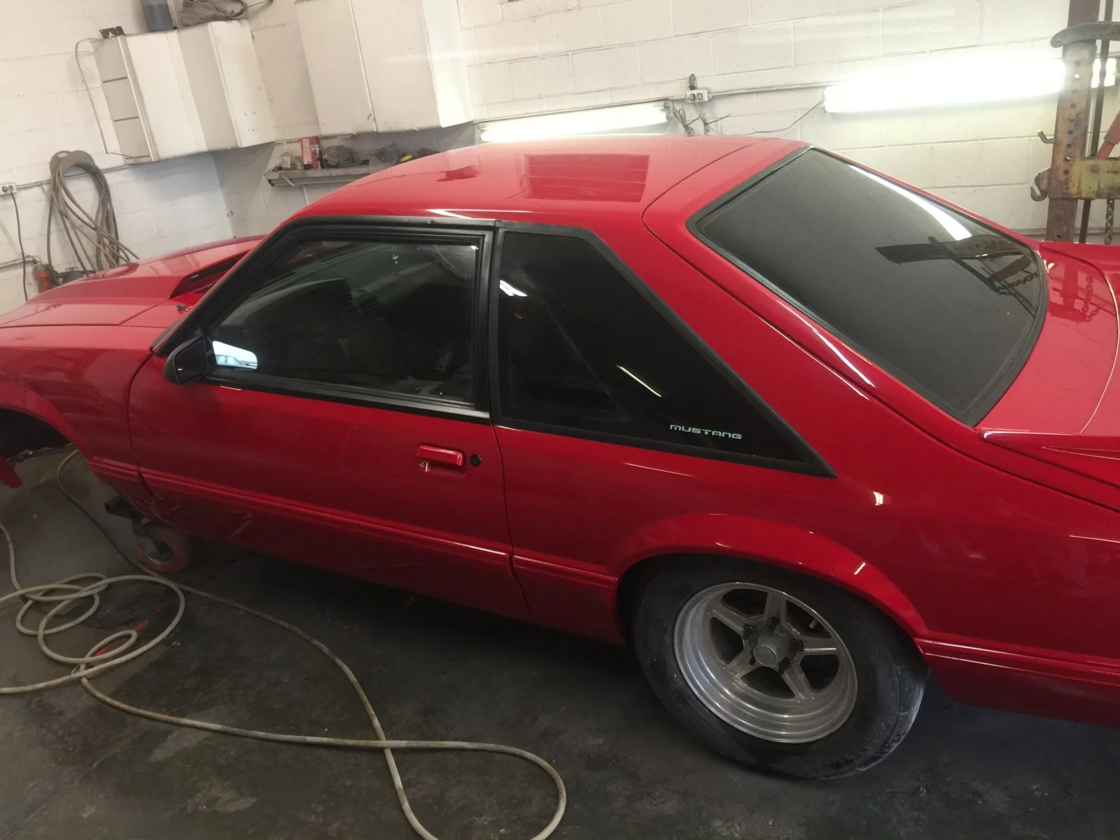

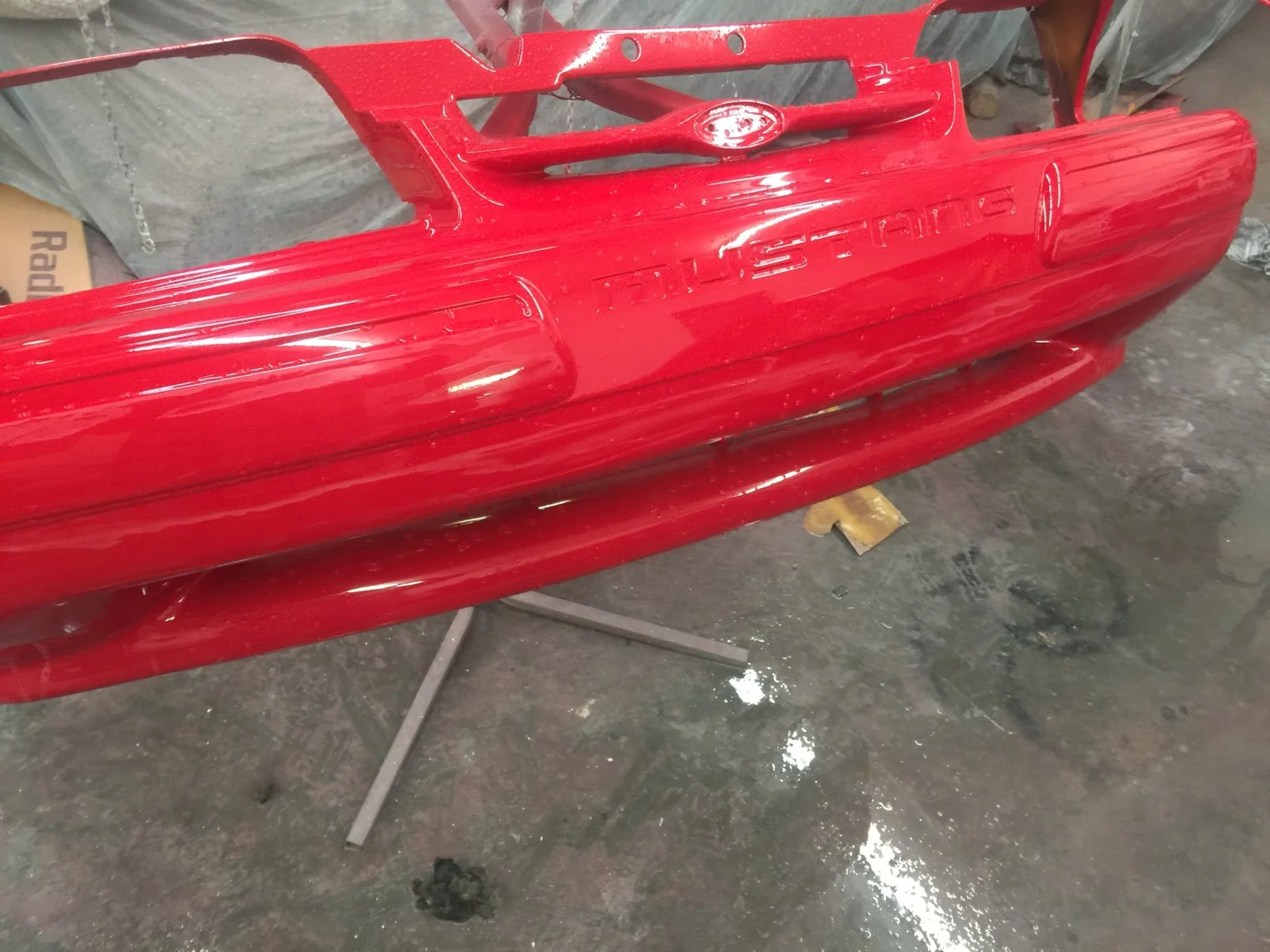

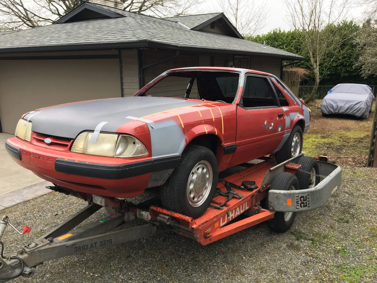

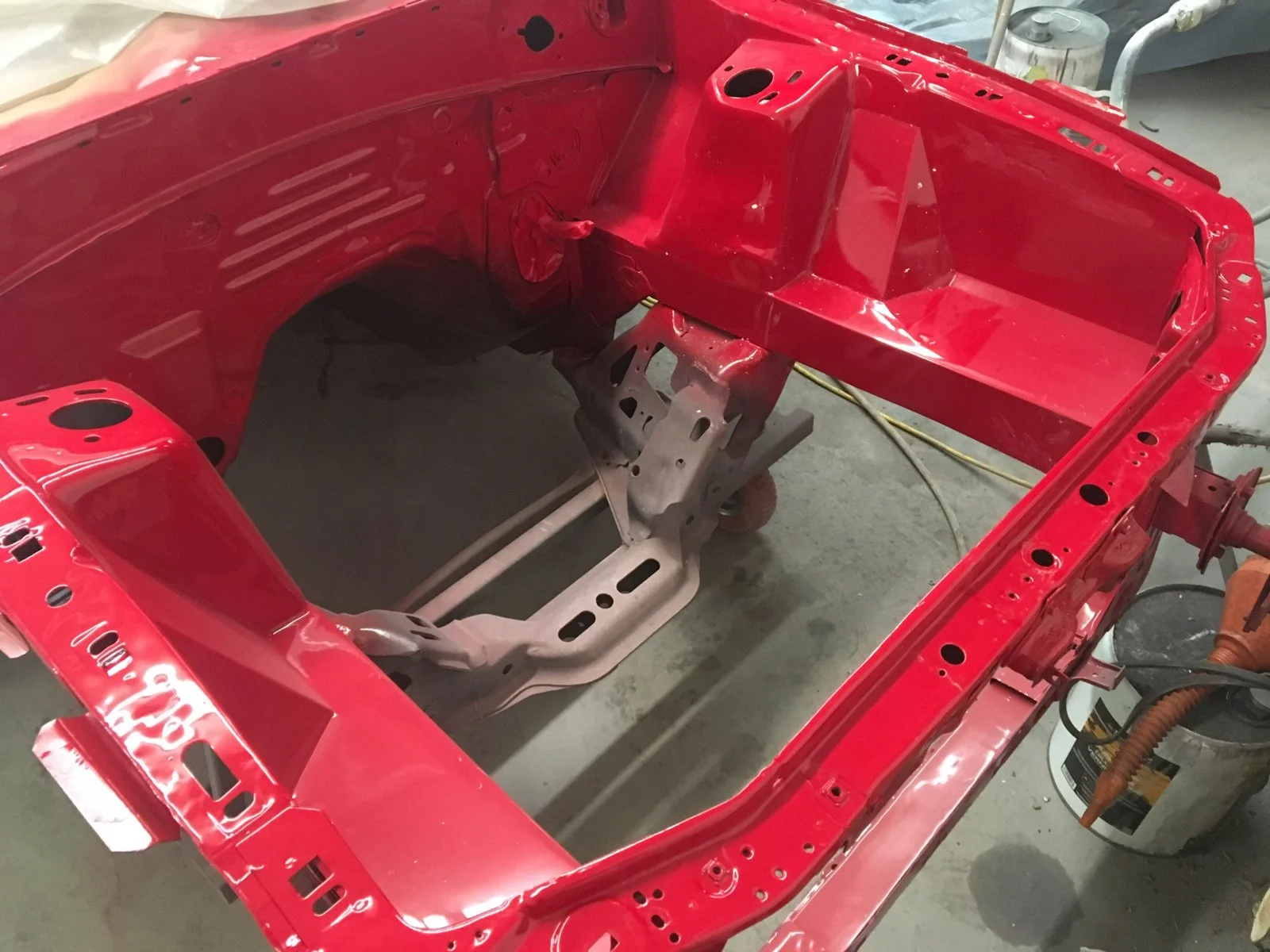

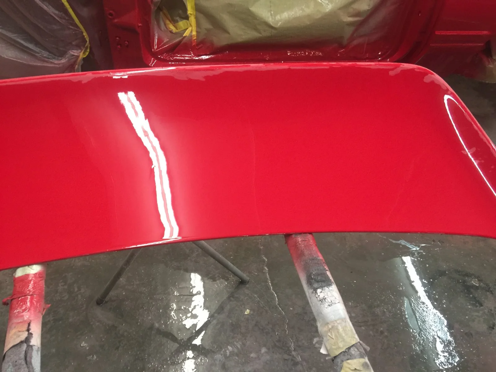

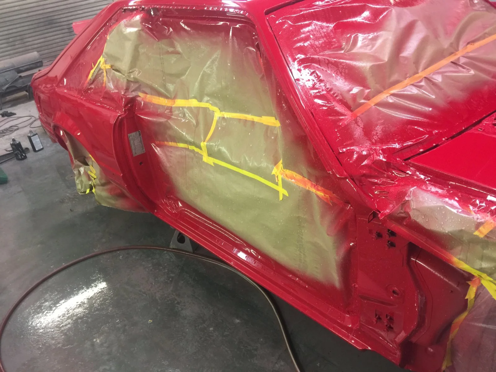

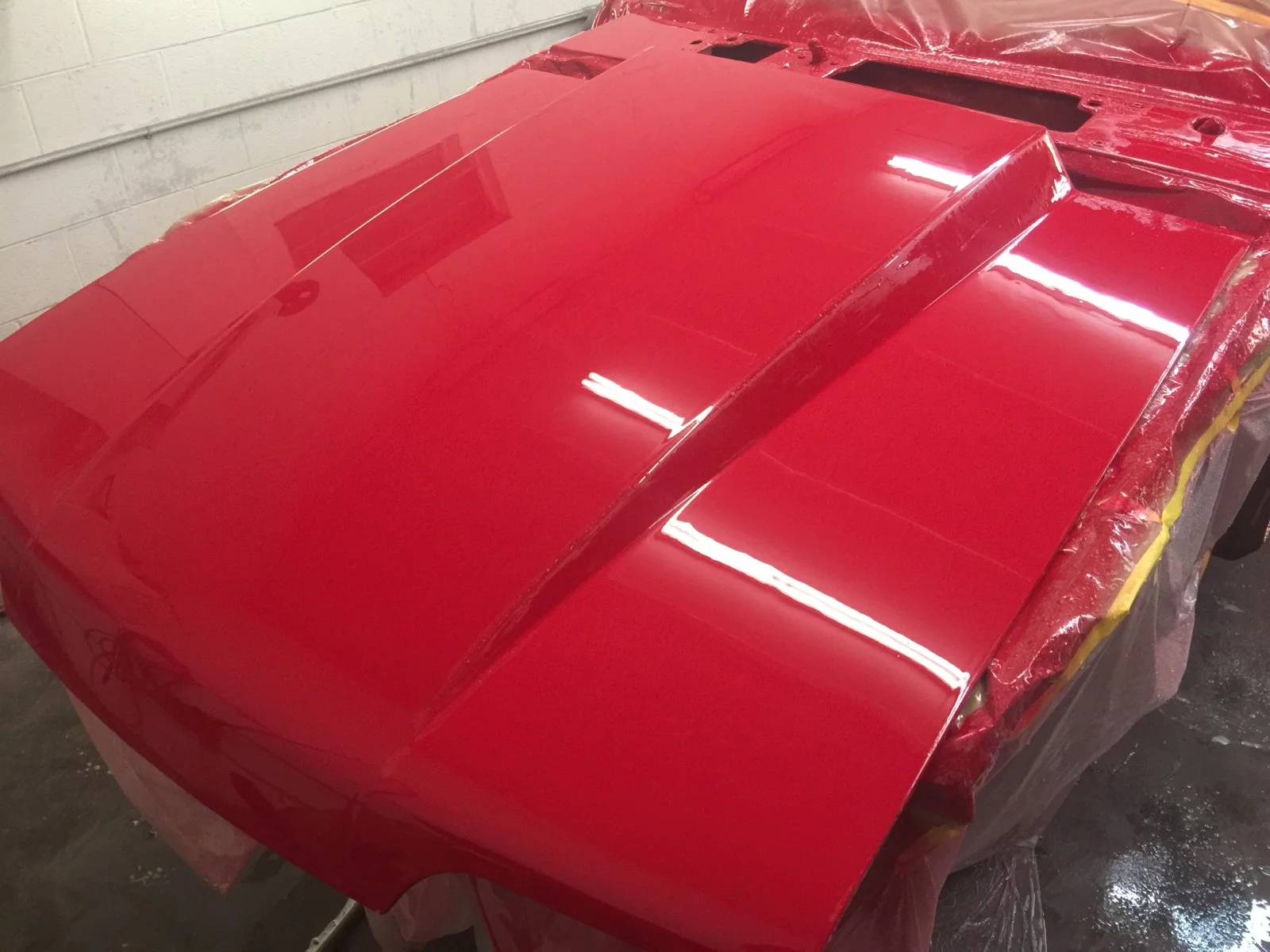

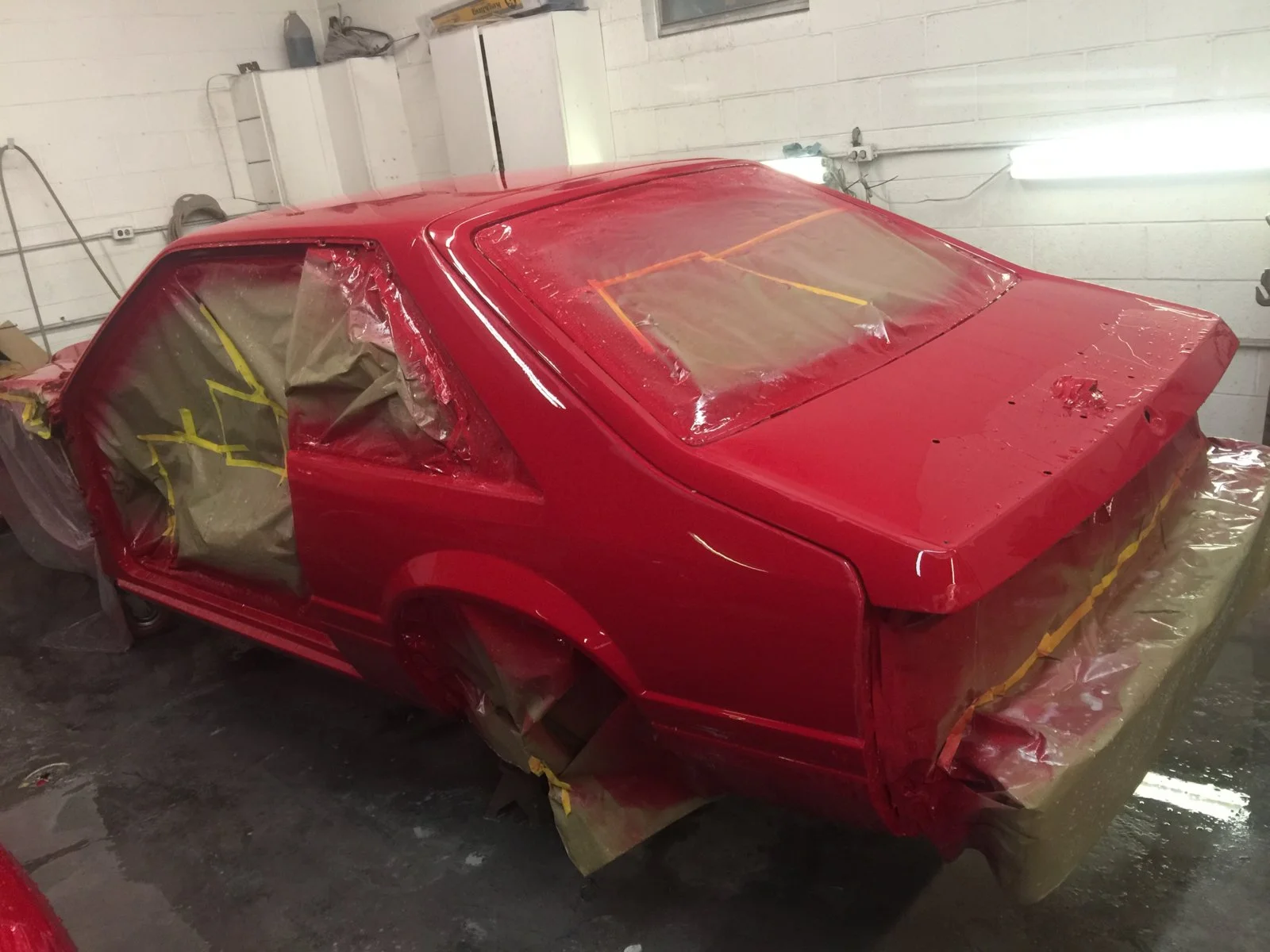

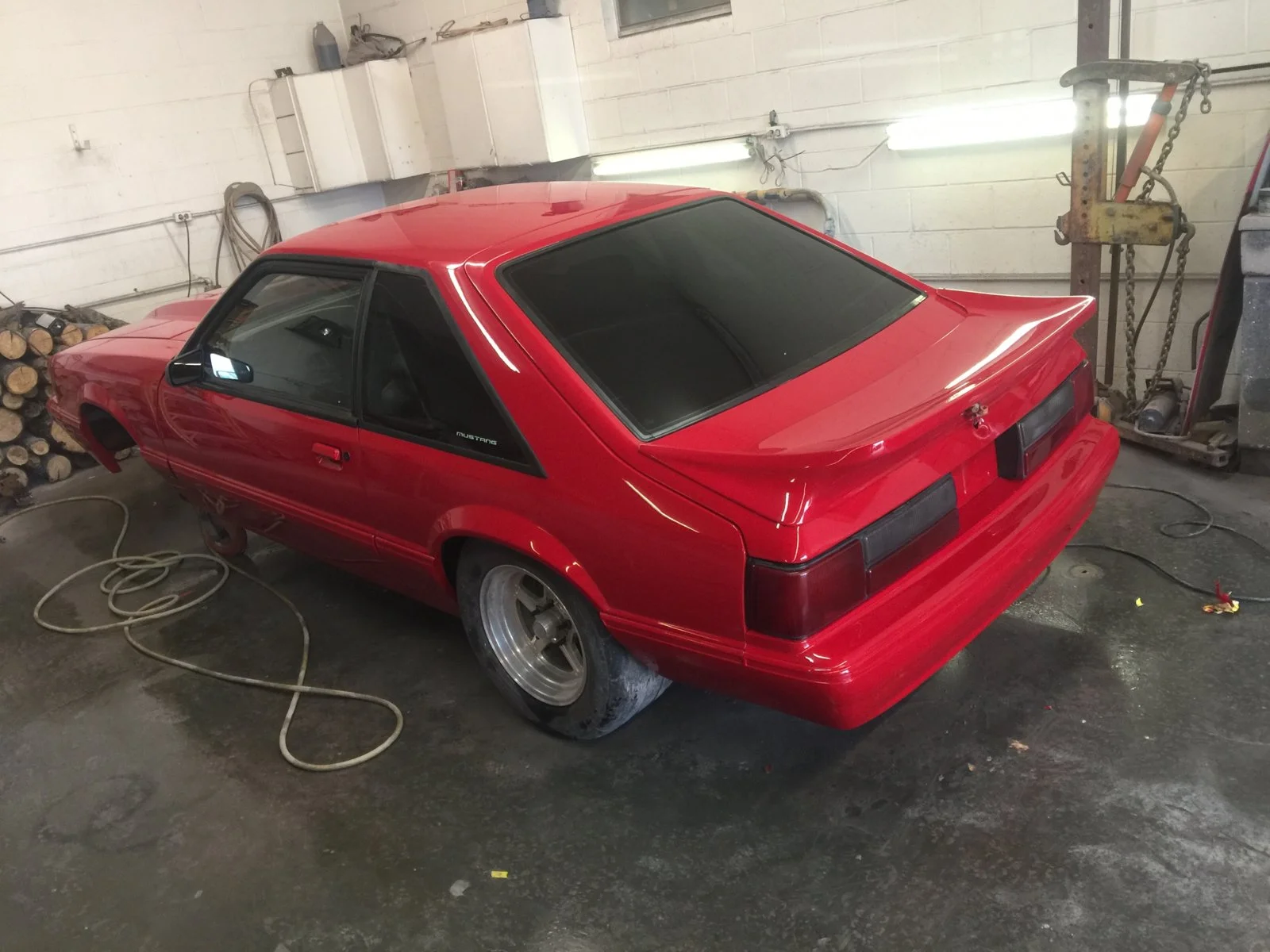

Another project painted and headed toward completion. This is a customer car but is going to be a twin to my Little red coupe. I mini tubbed it and it will have the same wheels as my car and the same red and black interior scheme with...of course redone recaros. Also has the mandatory shaved/smooth engine bay.

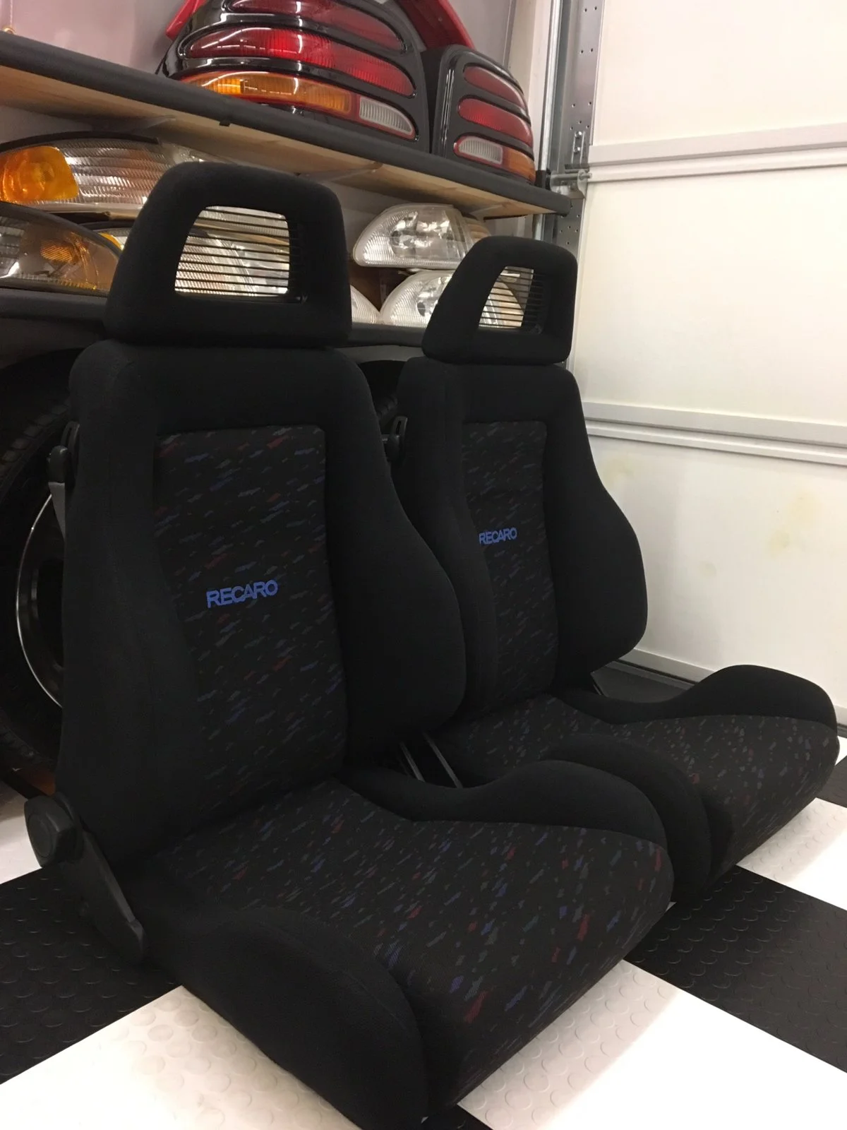

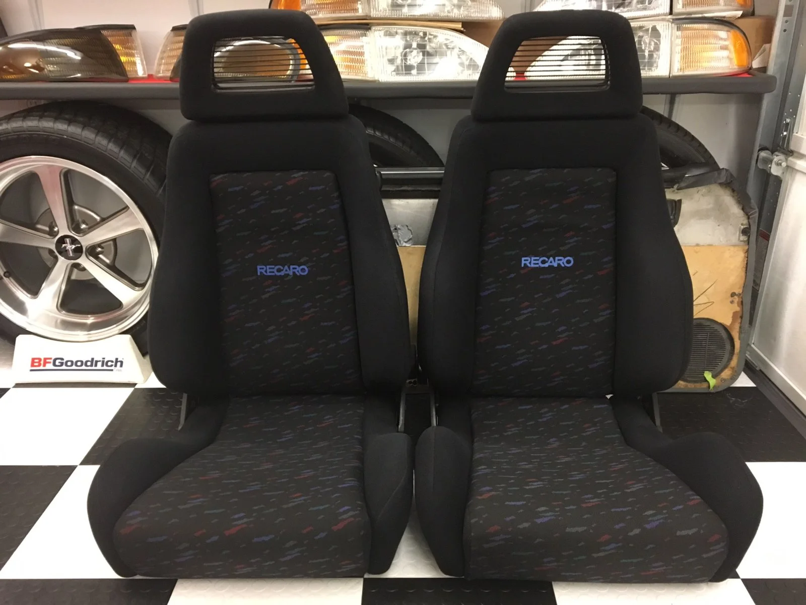

And the recaros Ive sourced for the car

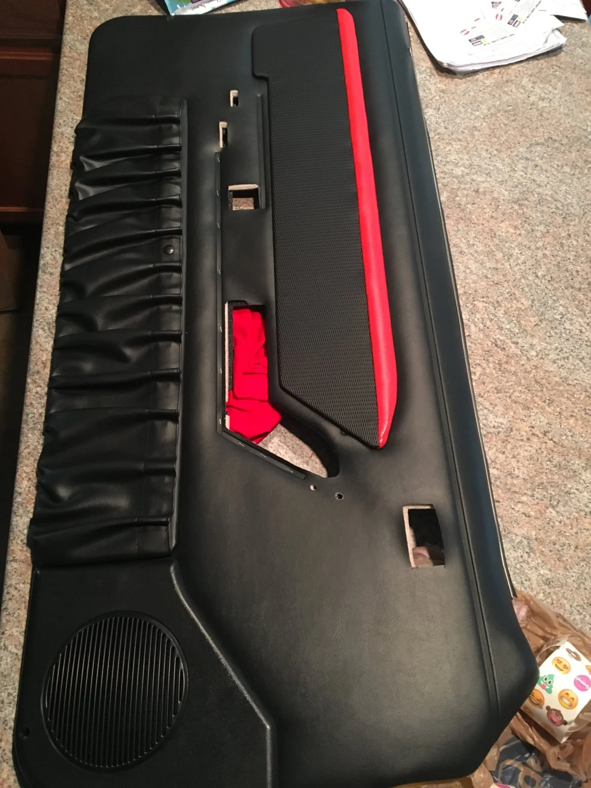

One other note. The customer opted for TMI door panels and as someone who does a ton of custom interior and upholstery work...these door panels are nice. Much better than any oem set and every bit as nice as I would have done.
Reactions: thinkfaster
And you plan to redo those Recaros? They look mint already! Man how I wish I had the cash to allow you to do a full build on my car.

Thanks man! When you hit the lottery, I better be your first call. Ha ha!
Facebook page worked fine for me just now but I’ll add this recent build to it and see how that goes.
And yes, I usually just start with mint recaros and make them better now a days. No time for foam repair and all that crap on these builds.
