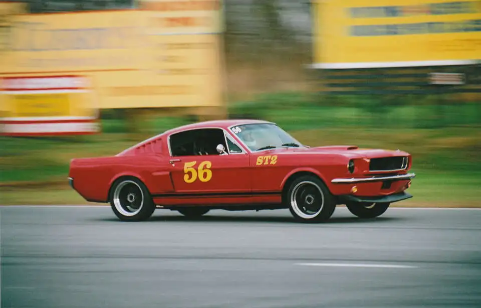

Is it a dedicated track car or is it street / occasional track?
Also, if you are considering 16" wheels, I would go ahead and make the jump to 17". Tire selection for 16" wheels is very limited.
I run 17X8, 4.75 backspacing with 225/45/17 front and 245/45/17 rear. I have the Falken Azenis RT-615's. They were the hot street/autocross tires for years, but there are several out there that will out perform them now. None, the less they are very economical. - Falken AZENIS RT-615 Tires for Sale Online - Vulcan Tire Sales

OK, if it is a dedicated track car, that is trailered to the track, I would go with Kuhmo V-710 or Nitto NT-01's. I pick up Kuhmo V-710's used, but still showing the groves, in 225/40/17 and 245/40/17 cheap. I'm trying to convience my wife that I need dedicated track wheels.

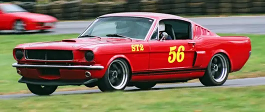

Im putting 8 but only in a 15,I really like the 17s but allready have these.Great looking red fast back by the way
I love that stance in the corners!:Track:
