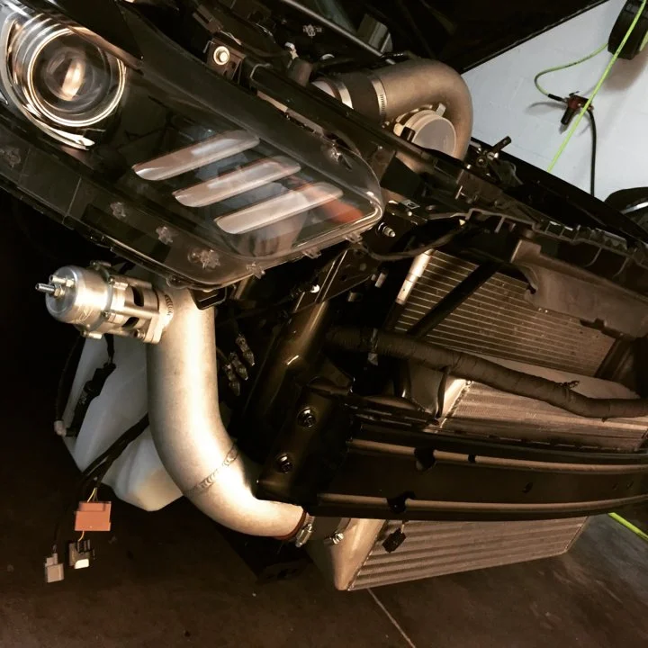

Probably showing my ignorance concerning forced induction, but how can you rev up to 5k and not get into the boost? Doesnt tthe SC run on a belt so spins faster as engine revs? Is this different than say, a whipple type of SC and the way it forces the air?
There's a bypass valve on the charge tube that is open when vacuum is applied. If you only apply part throttle you'll have enough vacuum to leave open the bypass valve which vents the compressed air. The bypass valve is that thing sticking off of that left tube.

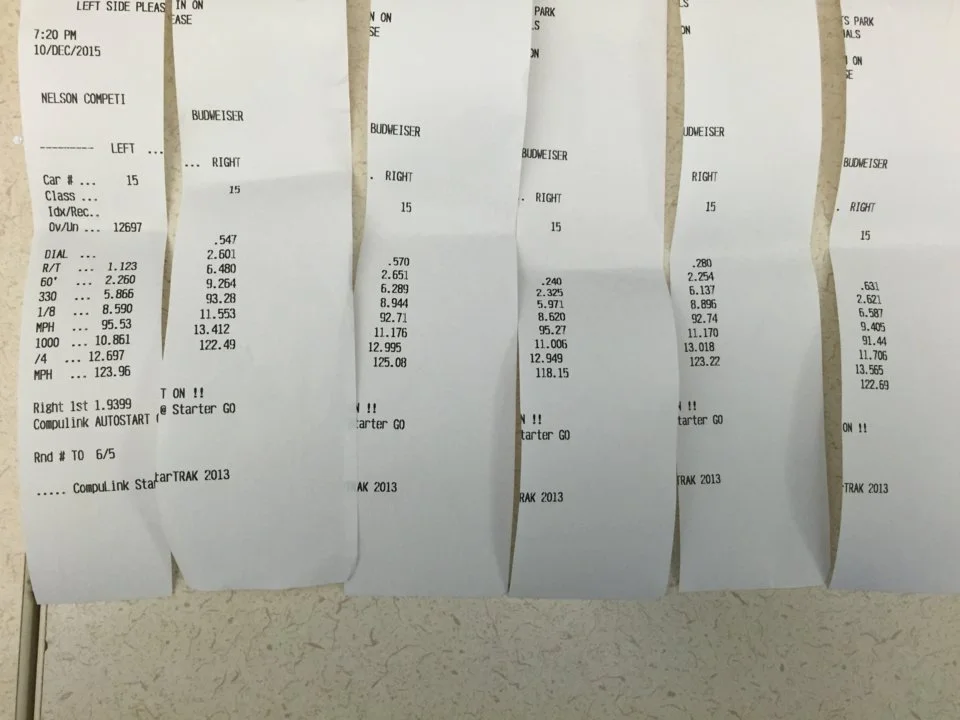

Ran the car down the 1/4 at Bradenton Motorsports Park. My first pass was my most successful ran a 12.6 @ 124. Unfortunately after adding Forced induction my car has gotten slower LOL but at least my MPH increased a good bit. I'm scheduled to run the 1/2 mile drags with Wanna Go Fast Jan 27 in Ocala FL at the Jumbol Air Run Way. I'm already discussing axles and sticky tires. I don't necessarily need to come out of the hole at 5k but I do need traction in first and second. Hoping I can get away with drag radials, axles, and driveshaft loops.
Wow. Those 60' times are terrible. With that trap speed, you are easily in the 11s once you've got your traction issues resolved. Tires will go a long way. I don't know how much the stock axles can handle but its probably good insurance to upgrade them (maybe 84ttop knows?). A driveshaft loop is always a good idea. I'm not sure you would even have traction with stock suspension if you bust out of the hole at 5k rpm. You can always figure out your optimum launch with your setup through trial and error. Keep us updated and good luck!

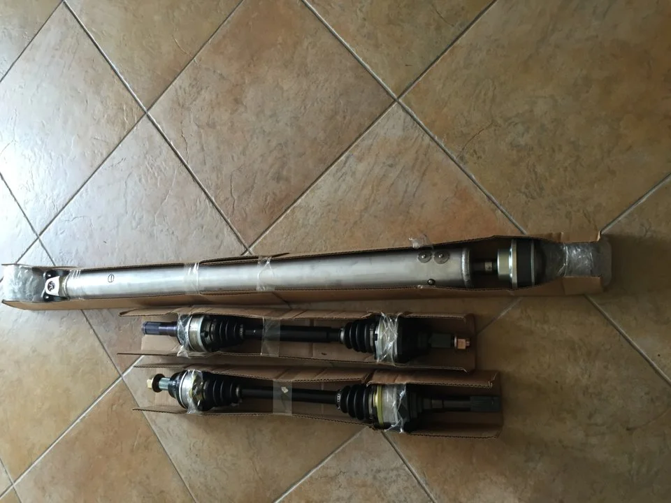

So my wife came by my desk this afternoon and asked me how my track event went because I didn't talk about it. I explained to her it didn't go very well but it could've gone worse.she then asked if it didn't go well because I didn't have the parts that I mentioned a couple weeks ago. I told her that was probably the reason she wanted to know what the parts were that I need it. I show her the parts list and she gets me the credit card and says Merry Christmas. I now have a driveshaft axles set of rear wheels and tires. As far as wheels go I went with a 20 x 10 performance pack wheel with a NT05r 315 35-20 tire.
Awesome!
Sent from my Nexus 6 using Tapatalk
Lucky! I mention car parts and the wife immediately gets ****y. LOL
Sent from my iPhone using Tapatalk
Mine isn't ok with it either... Oh wait, we are divorced now lol
At least the new girlfriend is down with going to the track and buying car parts, heck she is looking for a 53-56 Ford pickup as a project to work on together

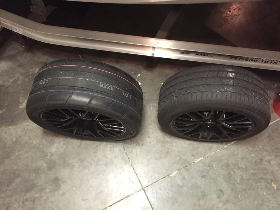

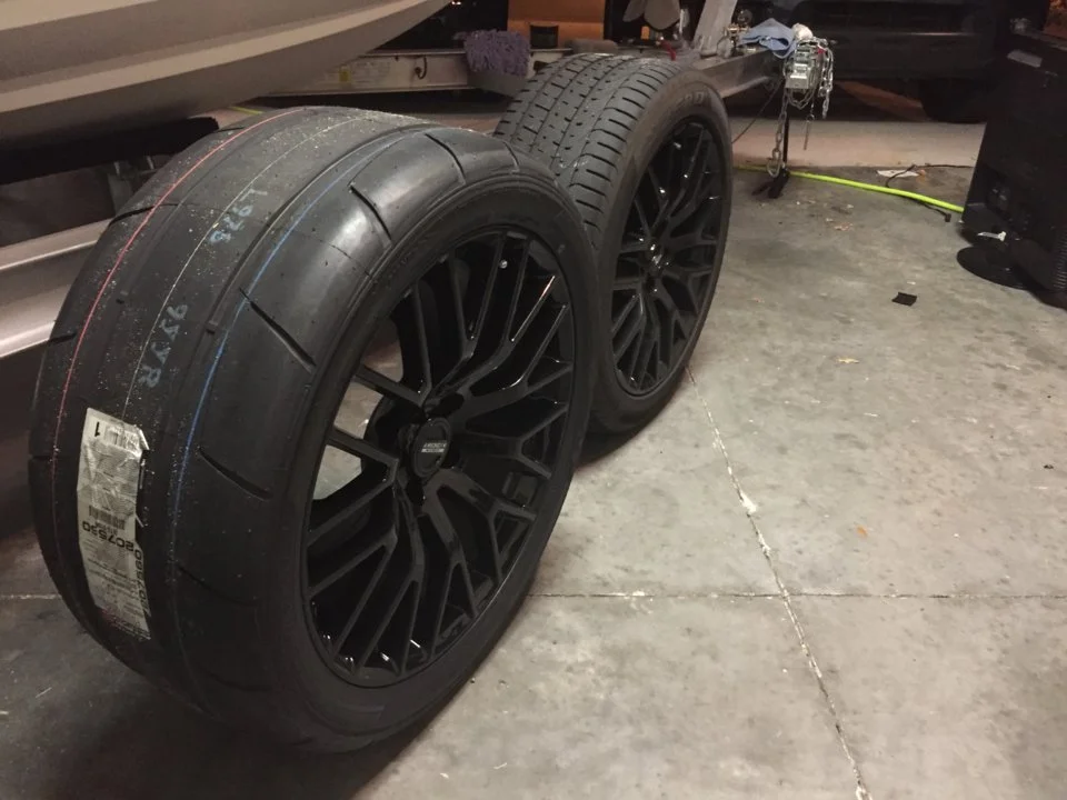

Tires are in! They look awesome on the car!!! I'm going to heat cycle them tonight then take them off and put them back under the tree.
