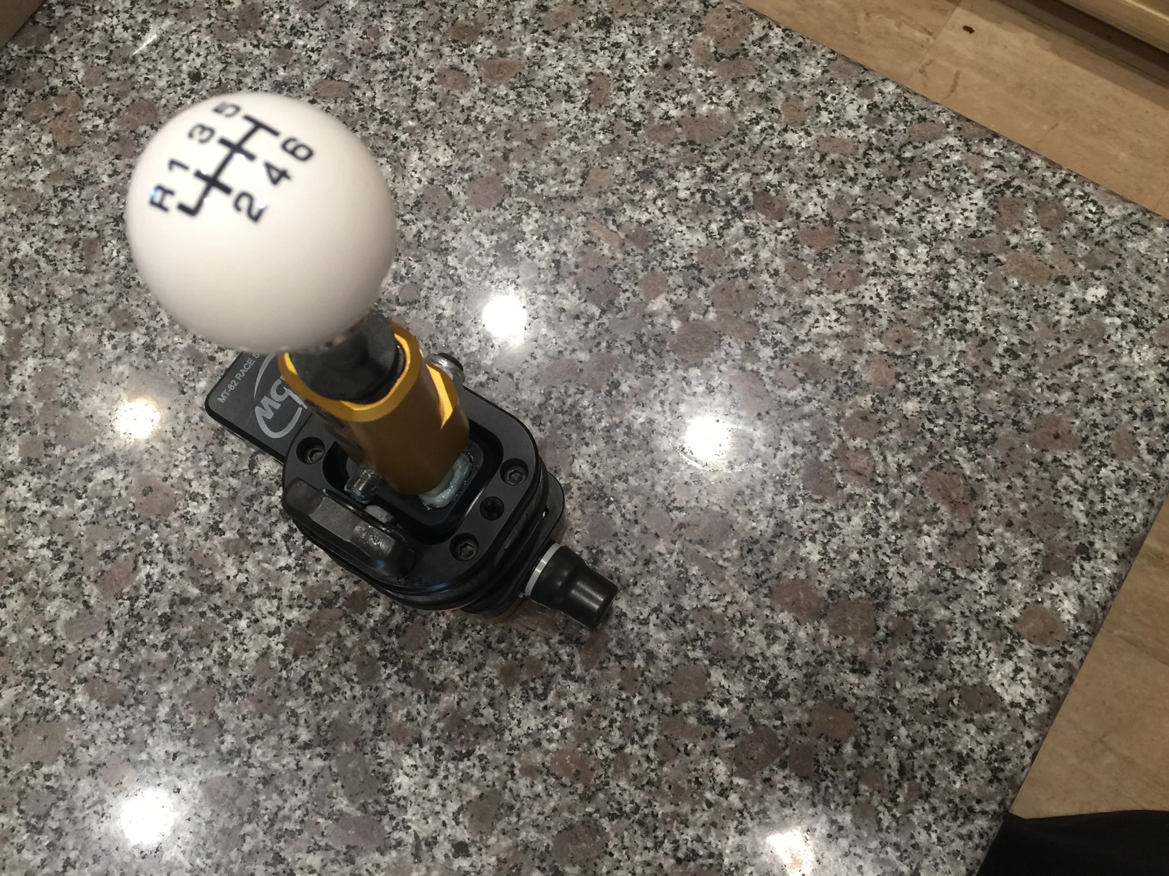

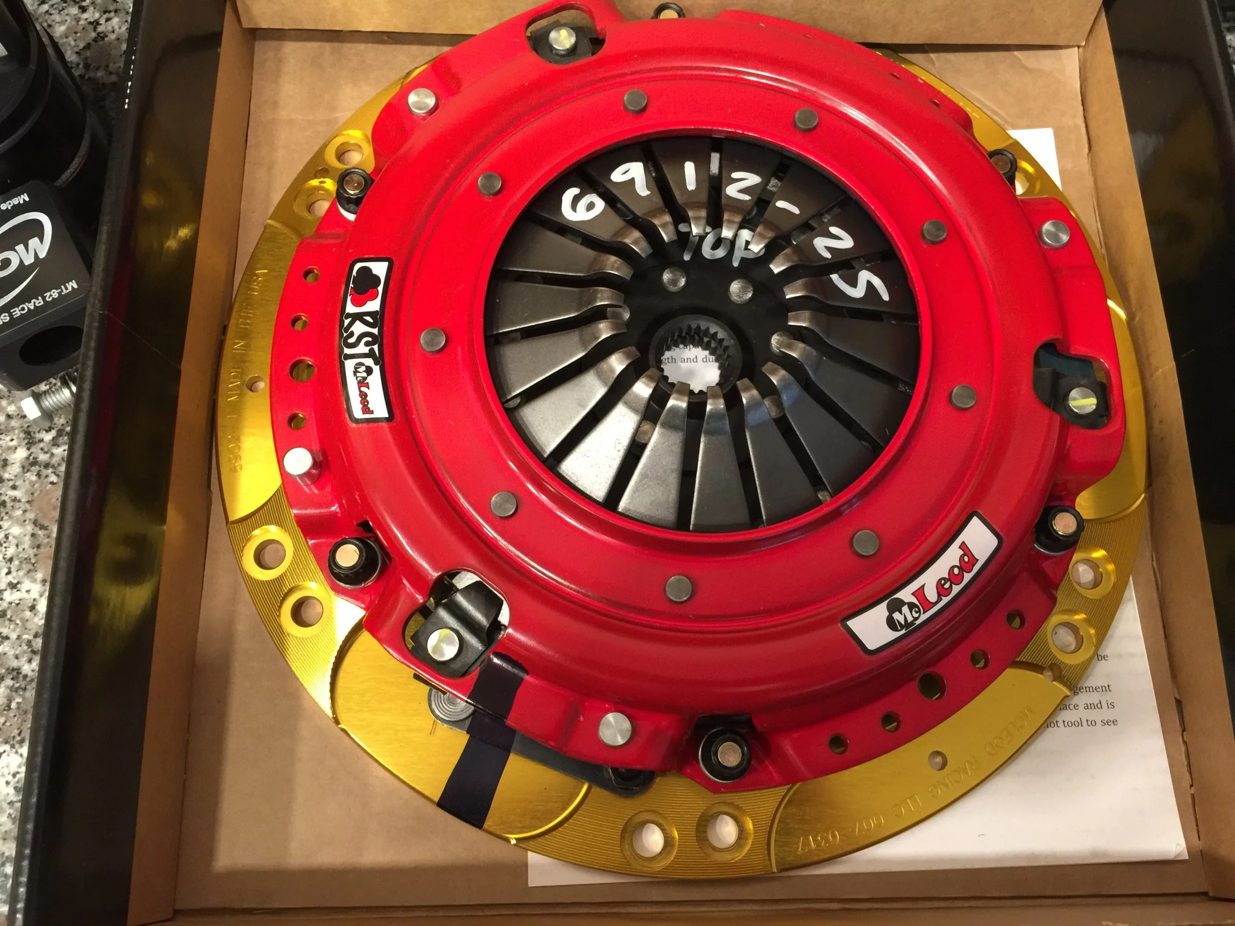

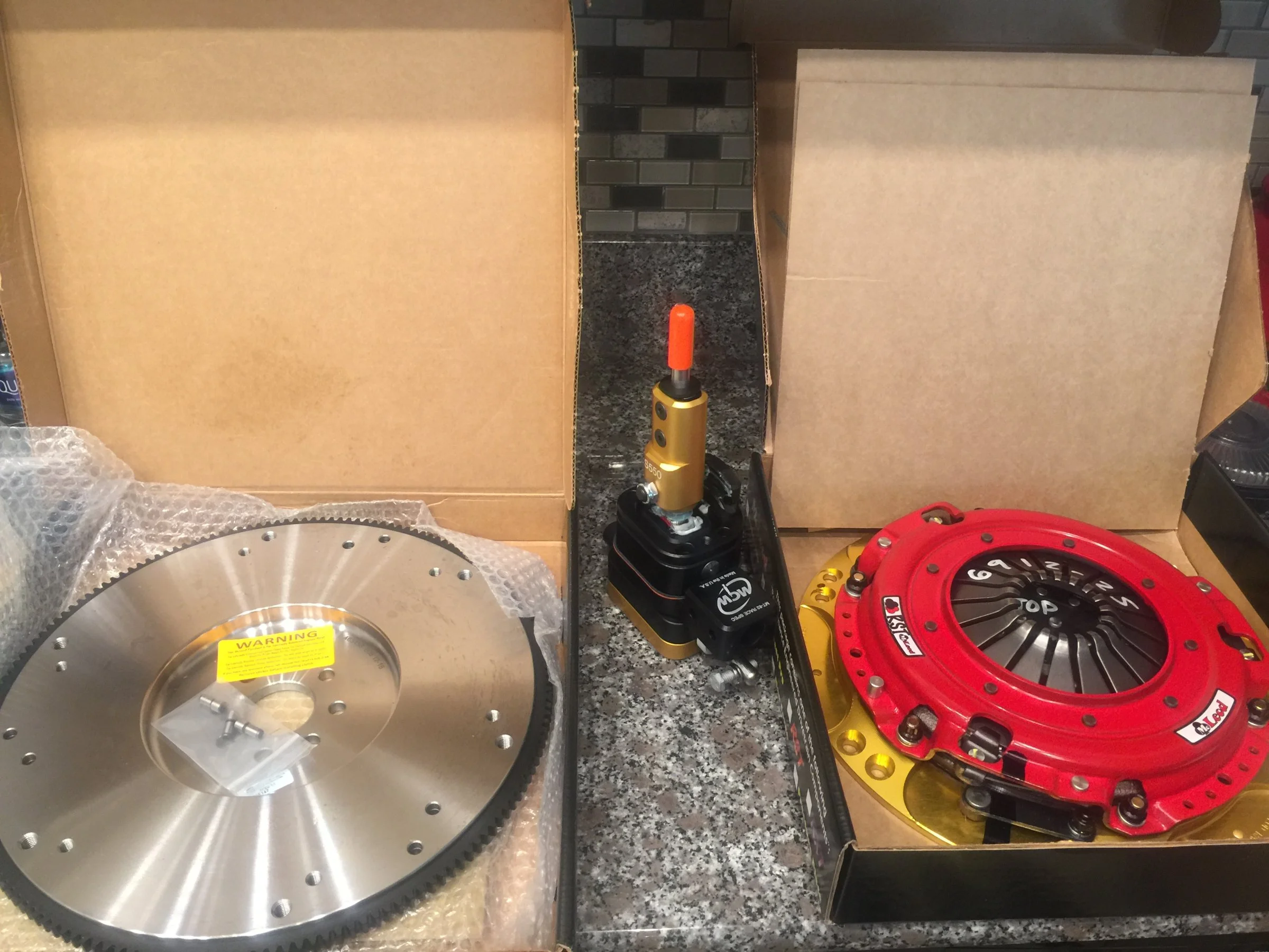

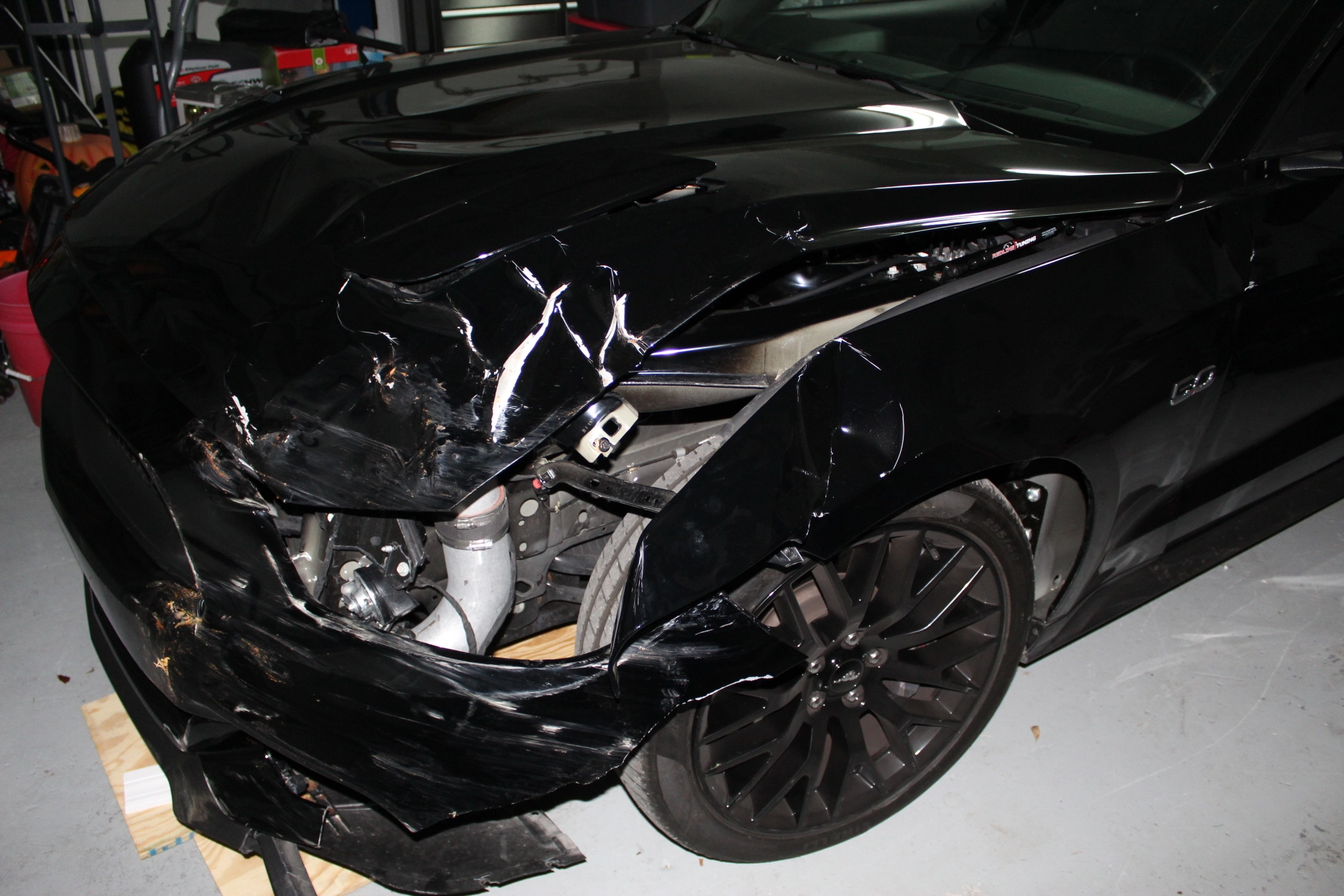

Its been a while since I've updated my build thread. I wrecked the car about 2 months ago. Swerved a deer and hit a tree. Did about 10K in damage to driver front corner. I got lucky and none of the blower components were damaged. The body shop still has my car as there are a couple of parts still lingering in the shipping process. The hood that came in was crushed during shipping so they sent it back for a replacement. We are still waiting on an airbag to show up. While I've been waiting I ordered some more parts for the car. I've purchased and received a McLeod RST dual plate clutch, lightened flywheel and a MGW Race Spec X Spec Shifter. I topped it with a white knob with the shift pattern on it. I can't wait to get my car back and get these new parts installed and update you all with how she performs.

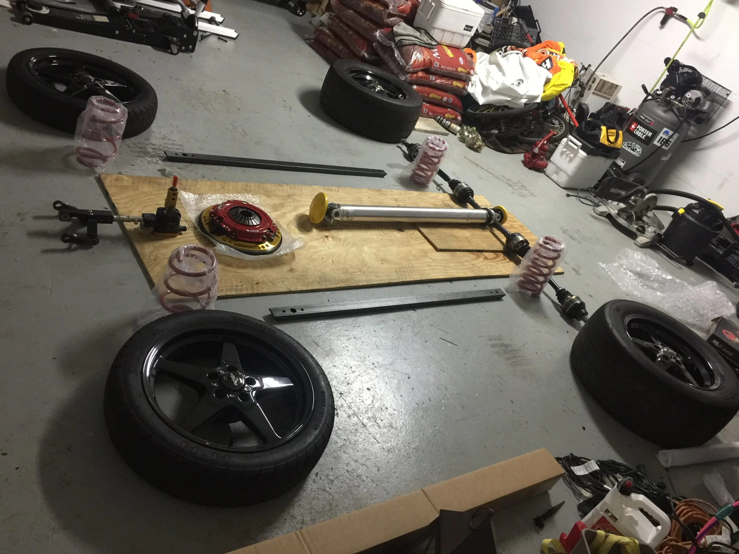

Still no car yet.... more parts have came in though! I'm hoping to get it back this week *fingers crossed*. Parts waiting to go on McLeod flywheel, RST Clutch, DSS axles, Shaftmasters driveshaft, MGW xspec race spec shifter, BMR jacking rails, BMR performance springs and Drag Stars with MT ET streetR and some M&H skinnies
