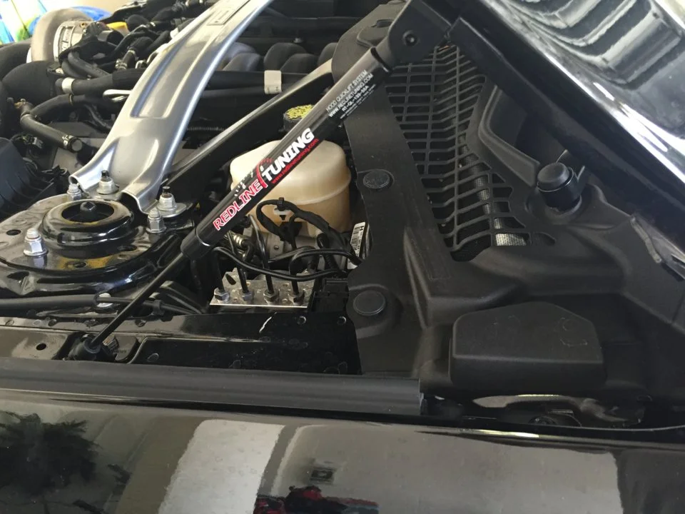

I forgot to mention I've installed Redline Hood struts.
