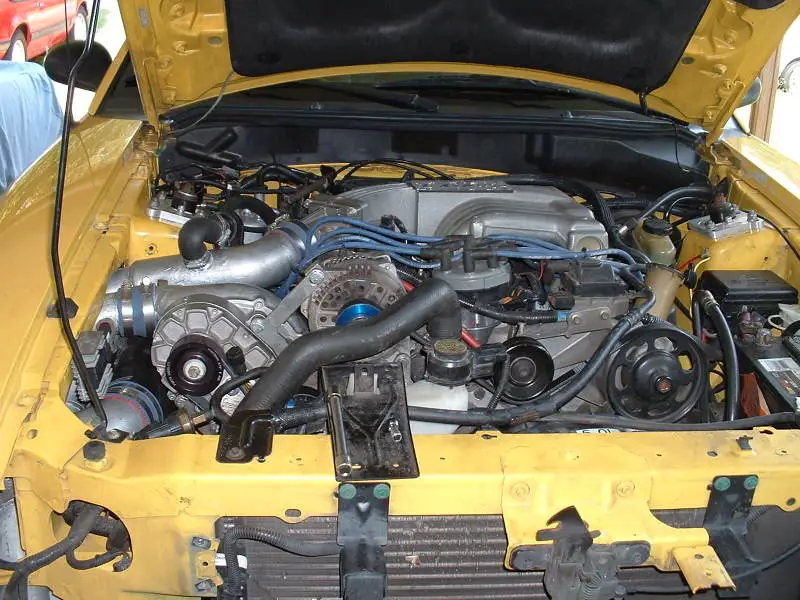

speeking of vortech, how do you have an intercooler, i would love to see pics.
i got the b cam used for $50 on ebay; that's a big reason i went with it. plus my car is a daily driver and i wasn't too sure about the e and f cams being street friendly. i'm sure one of these days i'll swap the cam out for something better and get a retune.
prokiller: as for the pic of the intercooler; i'll have to wait on that as i am not in the country at the moment. when i get back i'll dig up some install pics i took and i'll take afew more for good measure. i bought the vortech used on ebay cheap(sense a theme here?) from a part time nascar truck series driver who wanted to build his own race car for the knowledge and his own enjoyment. he chose a 95 gt as his ride. built a blown motor, had fun with it, decided to try an n/a motor and sold me the kit. he had all the fab work for the intercooler done at some race shop in cali (well known but i forgot the name). sorry for the rambling post.... i'm tired and alittle sick at the moment

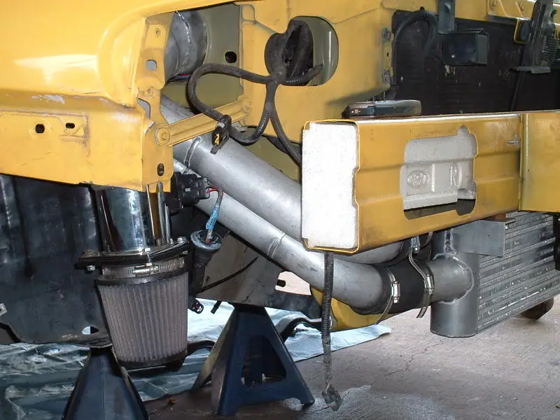

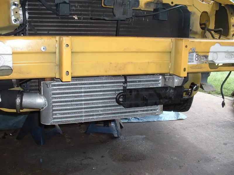

well, i got lucky. i found a few photos of the install of the vortech and intercooler on a thumbdrive i have with me..... give me a minute or two to figure out how to post EDIT: as promised prokiller images....
i know.... stock intake.... but it has since been replaced
so what do ya think?

Do you still have this car? who routed your intercooler pipes. i'm having clearance with the tire issues with mine and is causing problems. please advise, and if anyone else knows who can do this let me know. thanks.
