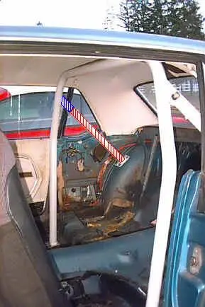

A while back I saw a guy´s mustang site and he had pics of his 4 point roll bar installation in his 66 coupe. The roll bar was just like the one in the pic.
He welded the roll bar to the floor pans, but cool thing was when he installed the rear tubes that weld to the wheel wells (red striped tube). He had his quarter trim installed and used a piece of pvc pipe that was slightly larger than the diameter of the roll bar, so that the pvc would slide over the "short arms" (blue striped tube). He cut the pvc just long enough to come in contact with the quarter trim panel, and marked the circumference of the pvc on the trim panel with a pencil. Took off the pvc pipe and used one of those hole saws that you use with a drill to cut the holes for door knobs in the house. He then took off the trim panels and slid the rear roll bar tubes through them. Bolted the tubes to the roll bar and had someone hold the trim panels while he welded the rear tubes to the wheel well. He ended up with a super sharp looking installation, no need to install boots to cover up the holes there. I´ll see if I can find the link.

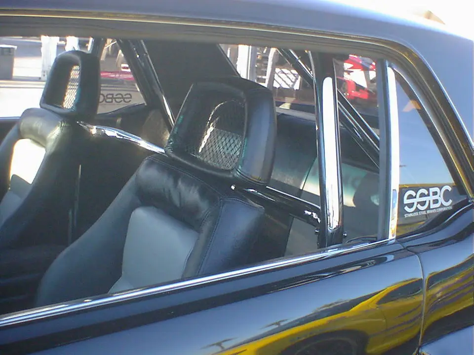

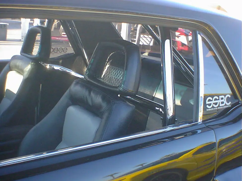

Yep, mines the same one as this...
Here's mine...
Forgive my ignorance, but wouldn't it make more sense to attach the rear of the bars through the rear deck panel and weld to the floor where the frame rails are? Attaching to the wheel wells just seems to be very weak without connecting to the rear of the car. The white roll bar looked preety impressive.
