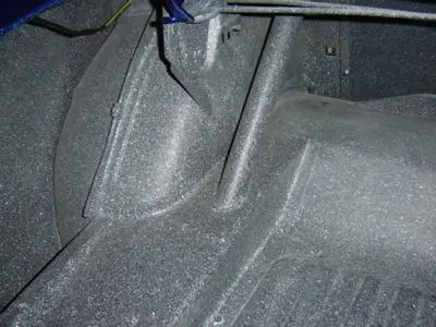

Here is a couple more shots of my cage with the interior partialy in.
As you can see in number 1 i still need to stretch the headliner on the rear pilars...anyone know how to secure that after stretching it?
The second pic shows the clearance between the rear seat and the main hoop.
The third shot shows the rear strut attachign to the trunk floor / rear sub frame.
I ended up having to move the front seats inboard 1.5 inches each to get everything to fit...there just wasn't enough room. I dont think anyone would notice just glancing at the car.
The master plan for the front struts is for the bend in the bar to head outwards giving you more elbow room....NO way would that happen as the main hoop only leaves about 1/2 inch on each side. I pointed the bend down to tuck the bars farther down and out of the way. I also didnt weld the forward struts as high on the main hoop as was suggested for the same reason.
If I were to do the install over I would have not cut so much off of the main hoop as was reccommended. I think it would look better tucked up almost touching the headliner and my tall friends wouldnt hit their heads on it when they tilt their head back.
