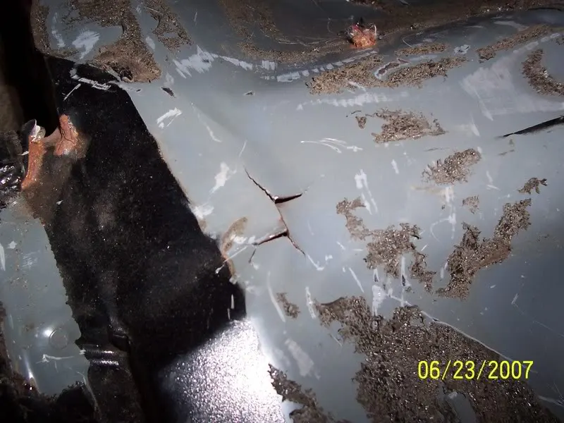

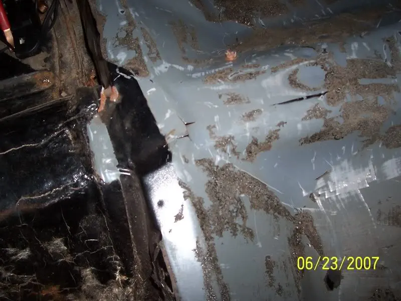

id go with thru the floor subframes. ive got full length ones underneath and my floor pan is ripping.
of course thats after a few 5K launches with slicks.
