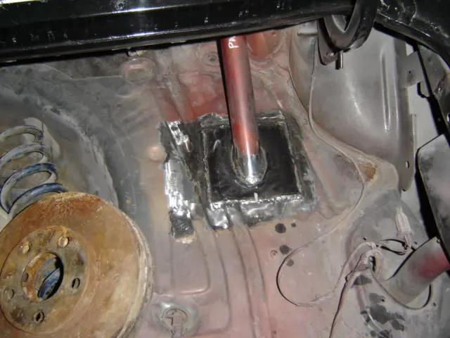

well whats the deal when i see the very back two point's going through the rear interior plastics. lol how the hell does everyone know where to mark, and better yet, how do you bolt or weld the plate on with that big ass plastic thing in the way. may seem like a stupid question but it's been something thats been bothering me for a while

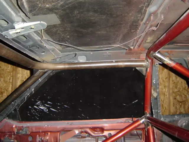

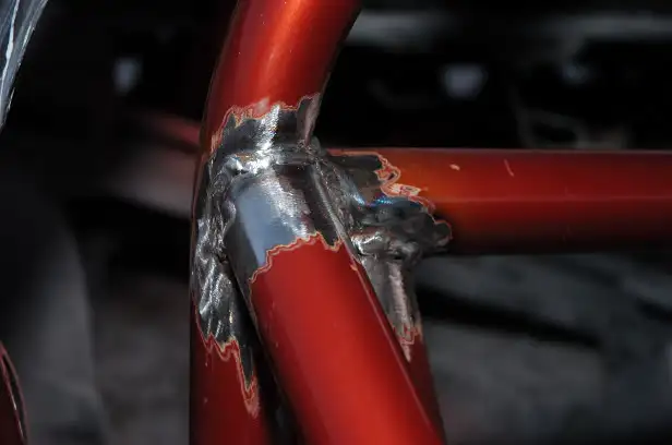

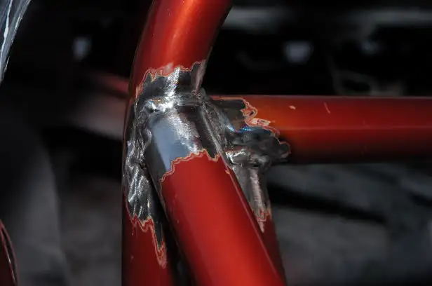

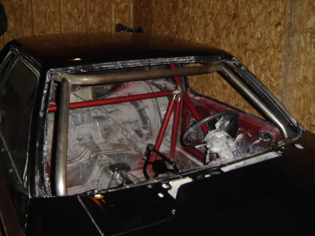

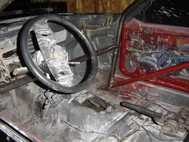

12 point here and street car well weekend street car..lol A 6 pt cage is good for a solid chassis but you have to do it all IMHO to get the full effect. upper and lower, torque boxes, sperical bushings, anti-roll bar(low ten sec car) or panhard bar, sub frames, welded axle tubes, good shocks,struts,s[rings,etc. It's a package deal

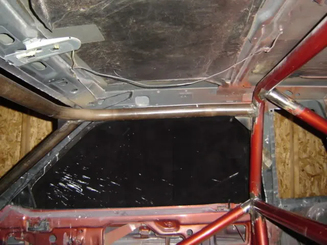

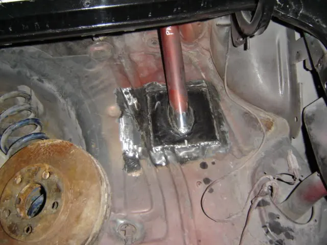

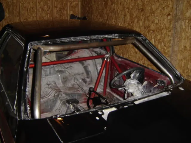

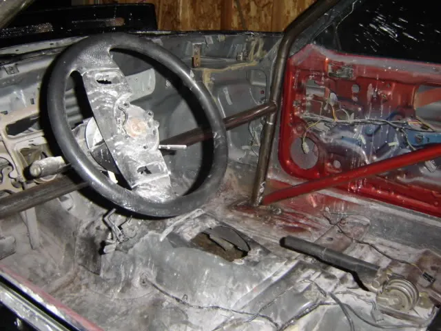

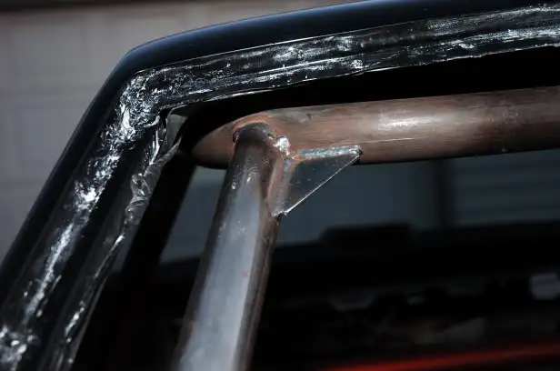

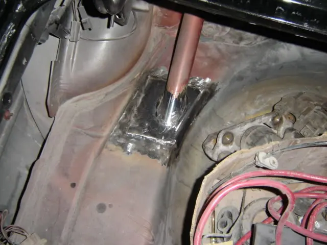

also here's some pic of the back bars and more of the cage
