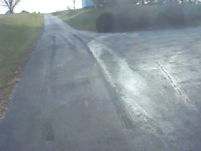

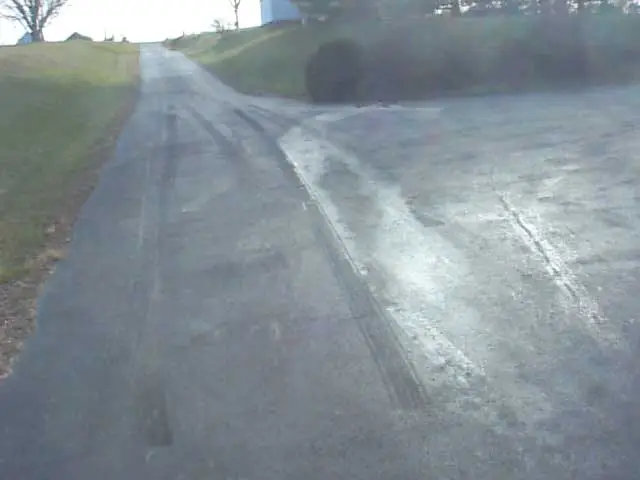

2 question..........
1. How competitive is your driveway?
2. What did you notice about the upgrade? Be specific.
Very competitive driveway
The suspension runs through its range of motion faster. It felt like it softened my 620 slightly simply because the whole suspension assembly is working with less binding on sudden shifts from side to side.
Ozsum2 said:
Wow! Who shovels your snow?
I don't shovel. On the rare occasion that we get too much snow (24 inches or more) all at once, I will get it plowed, but otherwise, my wife's DD and my DD are more than capable. ;)
They both still make it with the deep snow, it just wears out the universals a little faster when its that deep.
