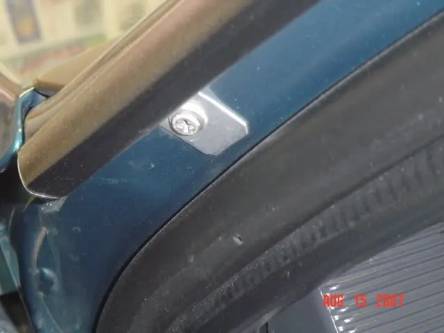

My roof rail molding only have a single screw and the rest is clips. I think when I put my new ones on, I put just a little bit of silicone adhesive on them too. Not much though.
Here is a pic of the only screw.
Here is a pic of the clip, there are several on the moldings that allow it to clip to the lip on the car.

To remove the moldings, Remove the screw and then gently pull the molding down toward the ground. Maybe just a little wiggling too. Some of the clips will stay on the moldings and some will stay on the car's lip. Shouldn't cause too much damage to them.
