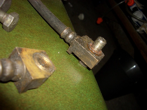

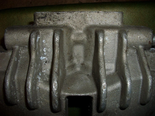

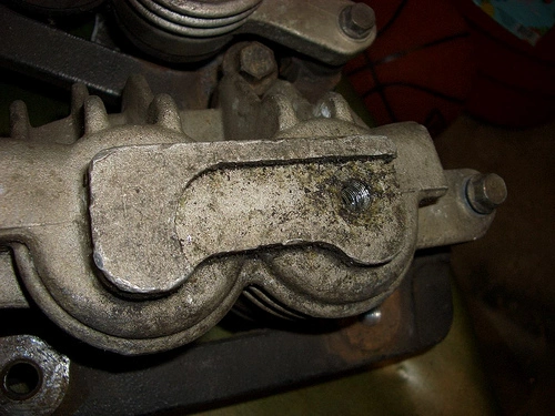

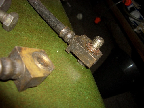

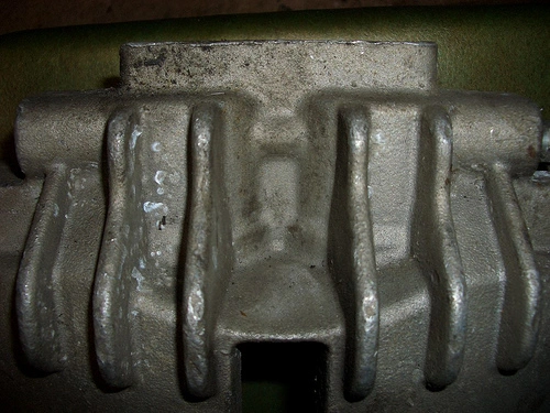

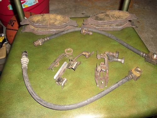

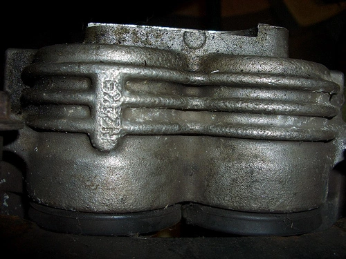

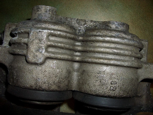

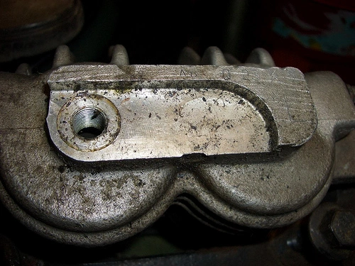

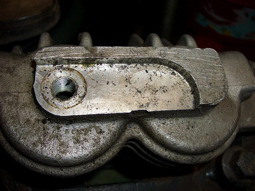

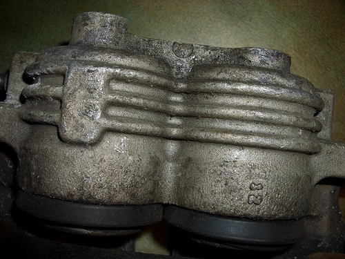

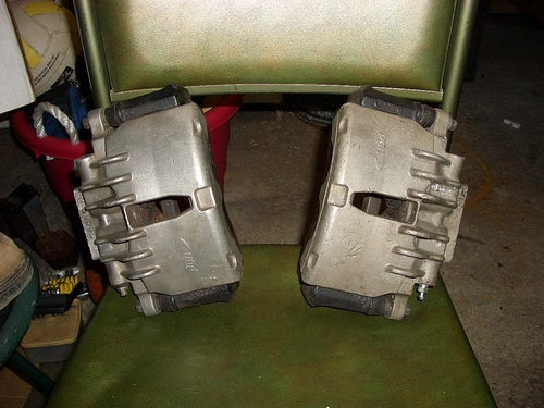

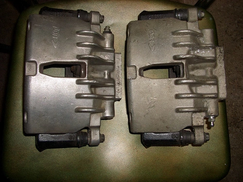

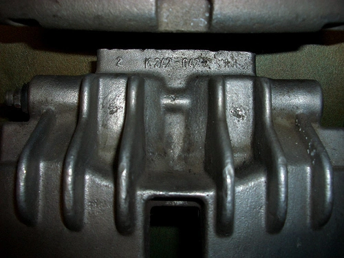

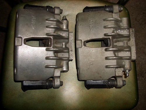

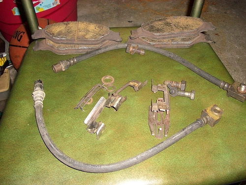

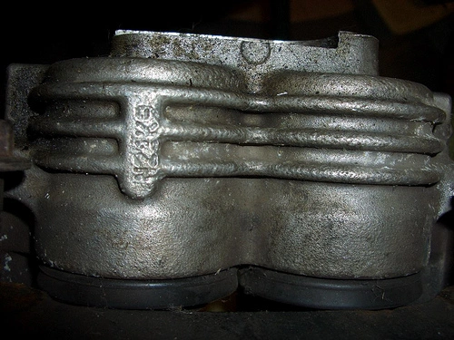

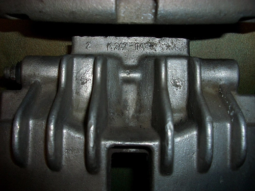

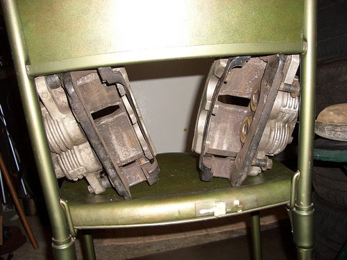

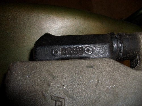

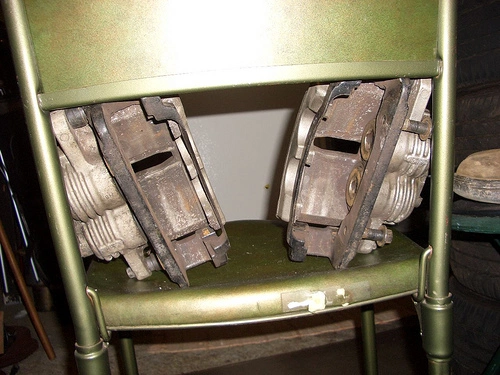

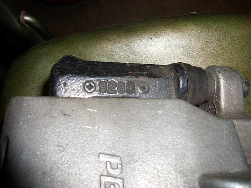

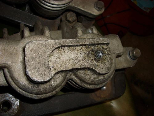

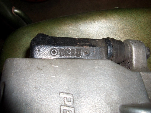

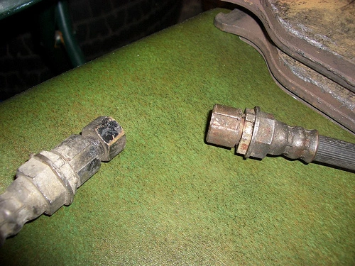

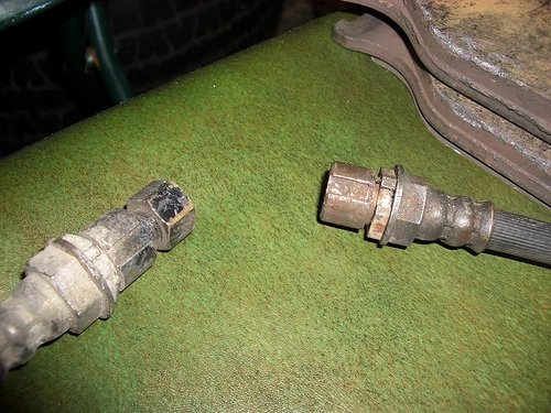

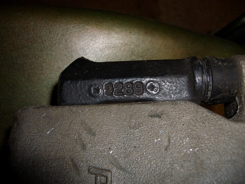

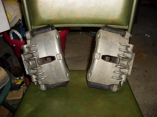

Ok I got my calipers in today...they look good but I'm not sure they both came off the same car...there is a Left and Right though...let me know what you guys think

Check the banjo bolts. 99-00 calipers were fine thread while 01-04 calipers were coarse thread.
Also, the brake lines where they connect to the body should be twi different sizes inside. You will need an adapter for 1 side
