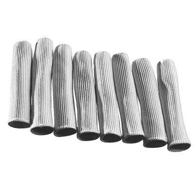

I'd see about getting some boot insulators as well.
Good luck.
Like these?
You got it. The thing with them is that they're pricey buggers. Way back when, I had found some that were decently priced but it's been so long that the vendor and prices would be outdated. If you're able to hunt around a little, you can find some that wont cost as much as the wires.
I've also used, um things from around the house, as an insulator, but it wasnt pretty.
Good luck bud.
