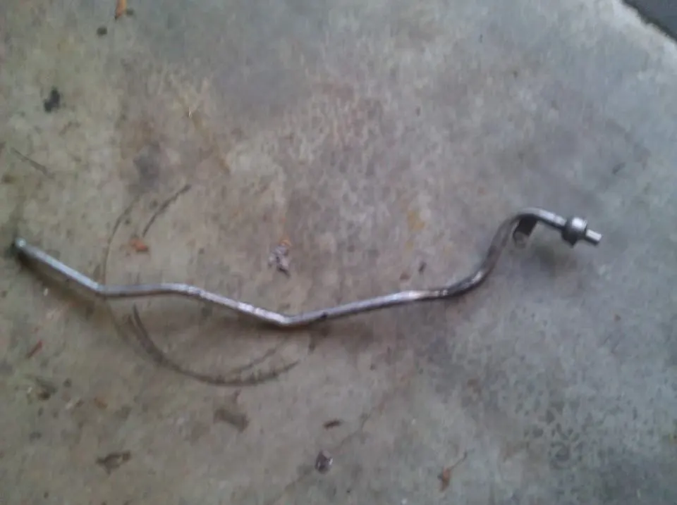

A secondary problem with only a code 41 or 91 is for cars with an intact smog pump and cats. If the tube on the back of the heads clogs up, all the air from the smog pump gets dumped into one side. This excess air upsets the O2 sensor calibration and can set a false code 41 or 91. The cure is to remove the crossover tube and thoroughly clean the insides so that there is no carbon blocking the free flow of air to both heads.
