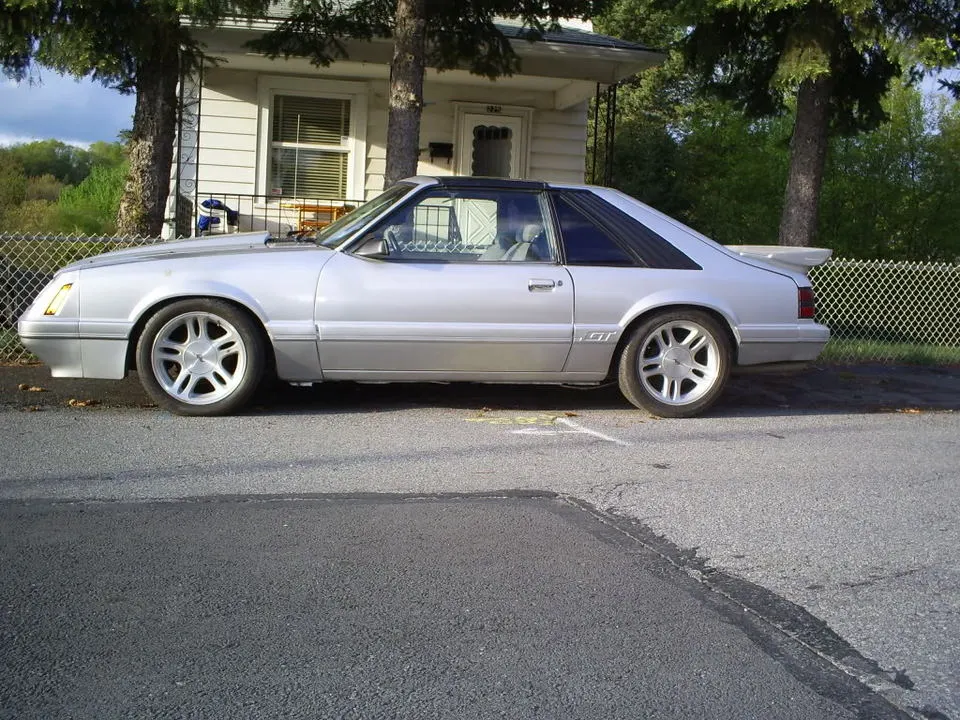

Specs:
Motor
Stock 302
Eddy performer lower
Holly 650 douple pumper carb
MSD distributor
BBK underdrives
1 inch carb spacer
Edelbrock air cleaner
Exauhst
BBK shorties
BBK h-pipe
Flowmaster 40 series mufflers
Drivetrain
Stock T-5
Hurst Shifter
Centerforce Dual friction Clutch
BBK firewall adjuster
Stock driveshaft
3:73 rear gears
Ignition
Msd 6A
Fordracing 9MM wires
autolite plugs
Body
3" cowl hood
Weld wheels w/ mickey thompson sportsman tires.
Saleen wing
Misc
Autometer and proform guages
energy suspension parts
Competition engineering drag shocks

Is the aircleaner sticking up more from the 1" carb spacer or from the design of the aircleaner, itself? ... or is the Edelbrock intake significantly taller than a stock intake? Just curious, as I was thinking of going with an aftermarket intake when I go carb'ed on my '84 sometime, but dunno if I'll need to budget for a hood...
Looks good! Where's the video?
RsStanG1987
I shaved all my pubes playing this game.
Mar 13, 2004
569
9
79
Dupont PA
Jul 22, 2008
#24
  • Jul 22, 2008
  • #24
Nah the aircleaner wouldnt clear my carb or distributor cause i had to buy a fancy air cleaner so it sits higher from the spacer and the aricleaner spacer. Maybe vid this weekend after i get her a bit tuned up. Still buttoning little things up like the dipstick and motor mounts.

new valve covers.. The Efi ones were causing pressure to build up in the engine and almost cooked it.
t-top shot

5 lug swap pics.

What type conversion did you use up front? Looks like it has plenty of clearance

Looks good man, why didnt you paint or clean the engine bay when you had the engine out?
