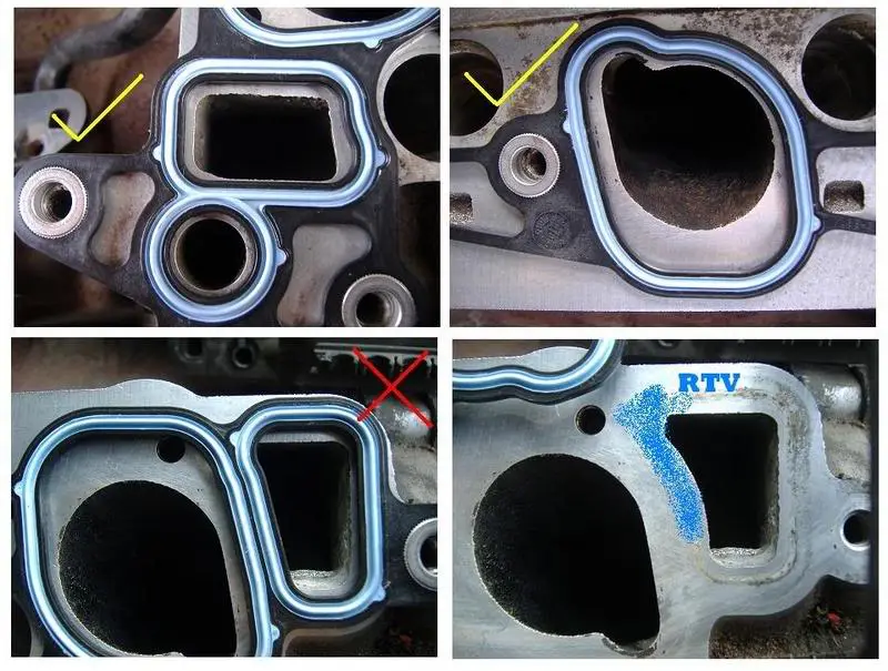

Here's one from AM. This is the passenger side. The driver's side looks just like it, except is on the rear of the head. As you can see, it really isn't much, and honestly, I don't think I've ever heard of anyone that used the PI gaskets and RTV having any trouble.
Still can't find the one I'm looking for...

The shape of the NPI water jackets is such that the PI gasket will miss in two spots, one on each head. The RTV is needed to create the seal, else you will leak coolant, but American Muscle is WRONG about needing RTV on each intake port. In total I used two pea-sized quantities of RTV for the whole installation. Always do a reality check before blindly following someone's advice, because sometimes it will turn out to be half-baked.

With stock replacement parts, yes, that would be correct. But this is putting a PI (mid 01-04) intake onto the NPI head, which aren't meant for each other.
As you can see in the picture, the PI gasket does not match up exactly with the NPI heads. It completely surrounds and seals all of the air ports, and obviously would match up exactly to the PI intake, but not the water jackets on the NPI head. This is why the RTV is needed, to help seal up the water jackets. The gasket just does overhang the lip of the jackets, and the amount of RTV needed to make it seal is quite small, just a dab really.
If you were to use the NPI gaskets (which most everyone would not recommend, lots more work), the gasket would match up to the head (and thus the water jackets) but not the air ports on the PI intake, and therefore RTV would be needed on all 8 air ports.
In other words, we're kinda jerry riggin a PI intake onto an NPI head here. There are companies that make adapter plates for the PI intake/NPI head, but honestly, at $400 a pop, they're not worth it. The RTV jerry rig/trick has worked flawlessly for probably hundreds of people, myself included.

here ya go.
pic, 1000 words, something like that...
