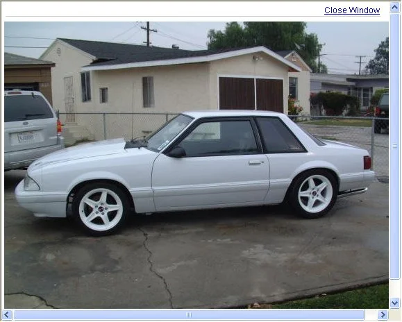

Just brought home my first mustang today, its an 87 X highway patrol.
The guy I bought it from didnt have it very long, and said the only thing that really needs to be fixed is the rubbing issue with the front tires.
They are 255 tires and when your going straight, you can hear a slight humming, and it goes away when you turn slightly to the left, but gets worse when to the right. Also, if say I 'm getting on the freeway, going right, and I hit the brakes while its rubbing, it still stop till I let off the brakes :shrug:
Is it just the tires that are too wide, or is it something else?

You think it could still be a wheel bearing? Would I need to replace it, or could I get away with repacking it?

oh is that white car yours??? Its looks very sweet.

Thanks for the comments on the car, I've been looking for almost a year for the right notch, and I found this one on autotrader, called him at 10 in the morning and found out it was the first day it was on their :D And I get compliments from everybody about the white on white!
The wheels up front are 17x9 with 255/40, in addition to the humming noise, whenever I turn full lock either way, the tires rub really bad, does anyone else have this problem with this tire/wheel size combo?
