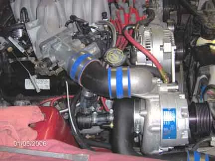

Hi,
An update
Jay and I worked last night. Got the Vortech, alternator, upper intake installed, oil lines plumbed to vortech, hose installed between vortech and T/B. Starting to look like something is being done . Ran into a few fitment problems with the MAF and vortech intake. The lightning MAF is a larger diameter than the stock, so need an adapter, for the air intake, also had to solder the pig tail into the harness. Also needed SCT chip for the MAF, got a basic tune put on it to get from Jay's to dyno, that was programed yesterday, by Mike at Paul,s.
Getting excited now.

Really excited now....

oh my, no power pipe ? that thing will be lucky to make 5 lbs sucking thru that thing
