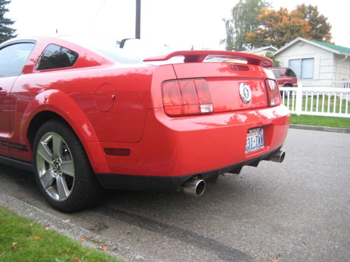

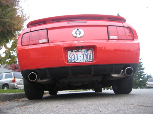

Soooooo easy, My 12 y/o daughter cuda done it! Don't know why I was freakin. Check the new look on my 6

No trimming nessisary, just a take off and bolt on proposition. Four bolts in the trunk area, two in each fenderwell, two pushpin fasteners on the bottom and presto- bumper off. Take the wiring harness off the factory one, put it on the new one, and re-install. Easy. Yes I will probably do the supercharger myself, but I have to purchase a few items to make it complete first, and money is tight, so it'l have to wait. I bought this rear bumper though cuz the guy selling it nearly gave it away, and I can't pass up deals like that.

Looks good. I am planning on putting a GT bumper on my V6 around March 09. I've got a line on one. Right now it's Redfire. Gotta get it painted Legend Lime to match my car. I installed the X-pipe & duals (with the help of a friend) and notched the rear V6 bumper to fit around the Magnaflow pipe tips. I think it will look much better after switching it to the GT bumper. I want the bumper Legend Lime with that bottom lip black to match my rocker panels and my black front spoiler. To top it off, I also have a line on a set of 18-inch fanblades that I want to powdercoat the blades black and leave the rest silver. The car is lowered, so these 16-inch wheels put it way too close to the ground. Got to watch speed bumps and road kill (nature's speed bumps). Also takes a bunch to jack it up to work on it because the hydraulic jack won't fit underneath it anymore without using the stock jack first to raise it up enough to get the hydraulic one under it.

Bill - the GT500 looks great, especially since the black side trim matches the black V6 rocker panels! I've been wanting to find a GT/CS front & rear bumper cover for my 07 GT, but I'll have to have them prepped & painted as the GT/CS's were never offered in Alloy Gray.
