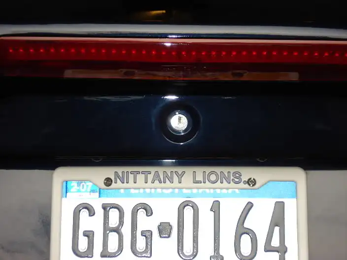

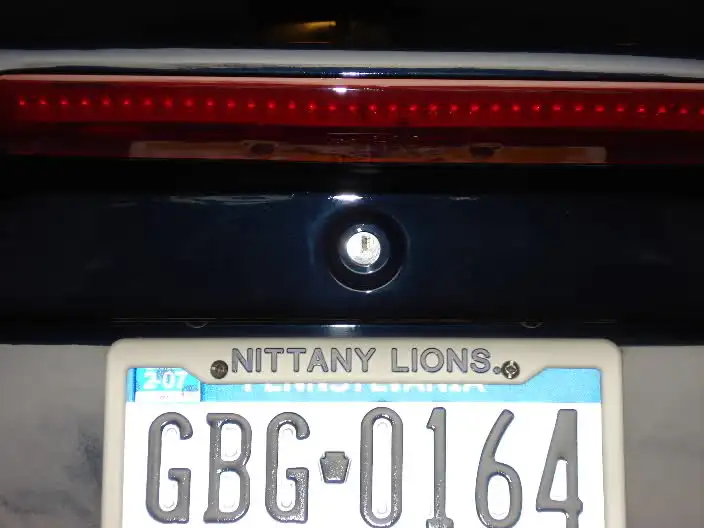

Mine was like that at fist. U need to match bottom of spoiler to line on top of lisence opening. Then it'll match
Mine did match. It slid down about a week later. :nonono: I think next time I'll have them use epoxy.
Use BULLDOG Adhesion promoter wherever you are going to put the 3m tape.. you can buy it in the auto paint dept at Walmart.. It's in a purple spray can.. Trust me, if you don't use it, the tape will eventually let loose.
I feel your pain. it took me few try in span of 2 years almost to get it right.
u need adhesion promotor. Don't skimp out on this.
then u MUST heat up serface worm to touch, before apply 3m tape.
DO NOT use clear tape that comes with Saleen. they stick about as good as couple in trailer park
