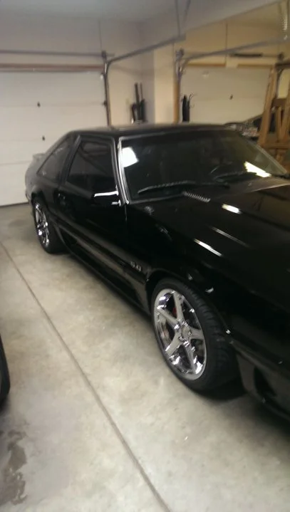

I'm running the 18x9's on all fours. 94-95 spindles up front stock length in the back on steeda springs. 255/35 front tires and 275/35 rears. No rubbing at all rear fenders are rolled and the car is a 92 so it has extra clearance up front.
