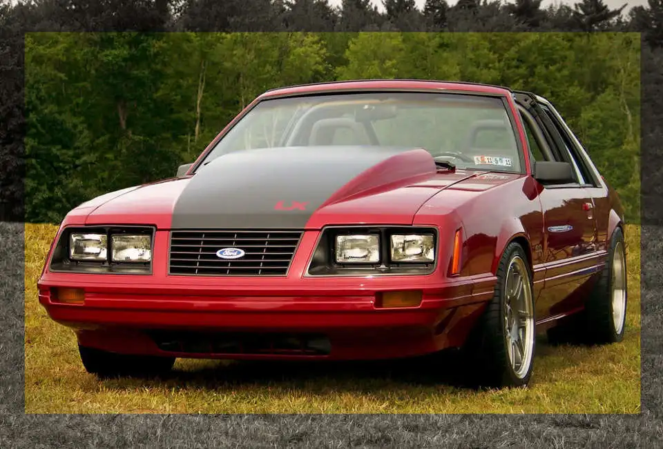

You get a flattening agent for the clear. They give you formulas for how flat or satin you want,so you know how much to put in the clear. This is the way I did the center of the hood on the ttop coupe. You have a nice durable finish then. I used the Dupont product. Also alows you to spray multi coats of the clear.
For some reason I think it would look better on a fox than on any other body style mustang. I think a black coupe with flat black stripes or flat black center hood,wheels too with a polished lip, would kick. I shouldn't be giving away my future ideas:lol:

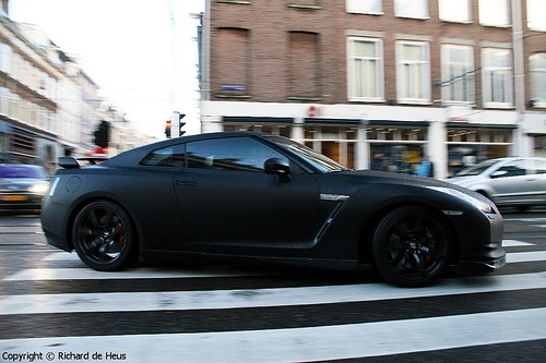

to me it just looks unfinished, i think the exotic cars with the matte paint works because the lines are smoother too. I think it looks good on bmws, lambos, ferarris and newer vettes cause those cars already have a sleek stealthy kind of look to them, a mustang really isnt sleek looking at all. and the flat paint just makes it look more boxy to me
