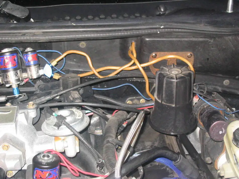

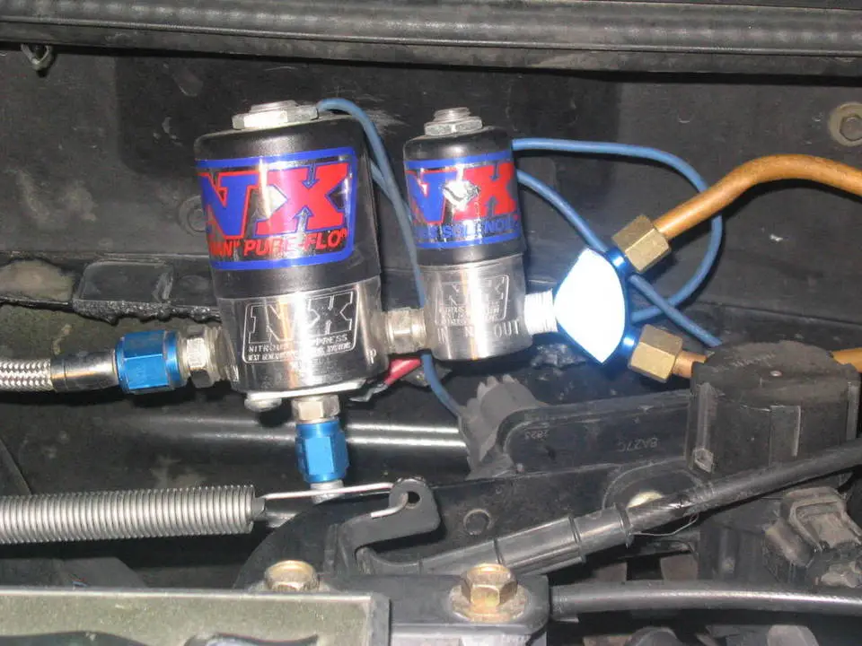

98blackstallion said:
hey man what all did you use to run the purge on your nitrous kit? I am at that step in my install and I am just curious to all what you used.
first i used the y valve from NX then i got some copper line and a flaring tool. then i got some end things and tightened it onto the Y valve. get them from pep boys. from there i did the same at the other end but hooked those up to 90* elbows and then onto purge valves off ebay. heres the valves
