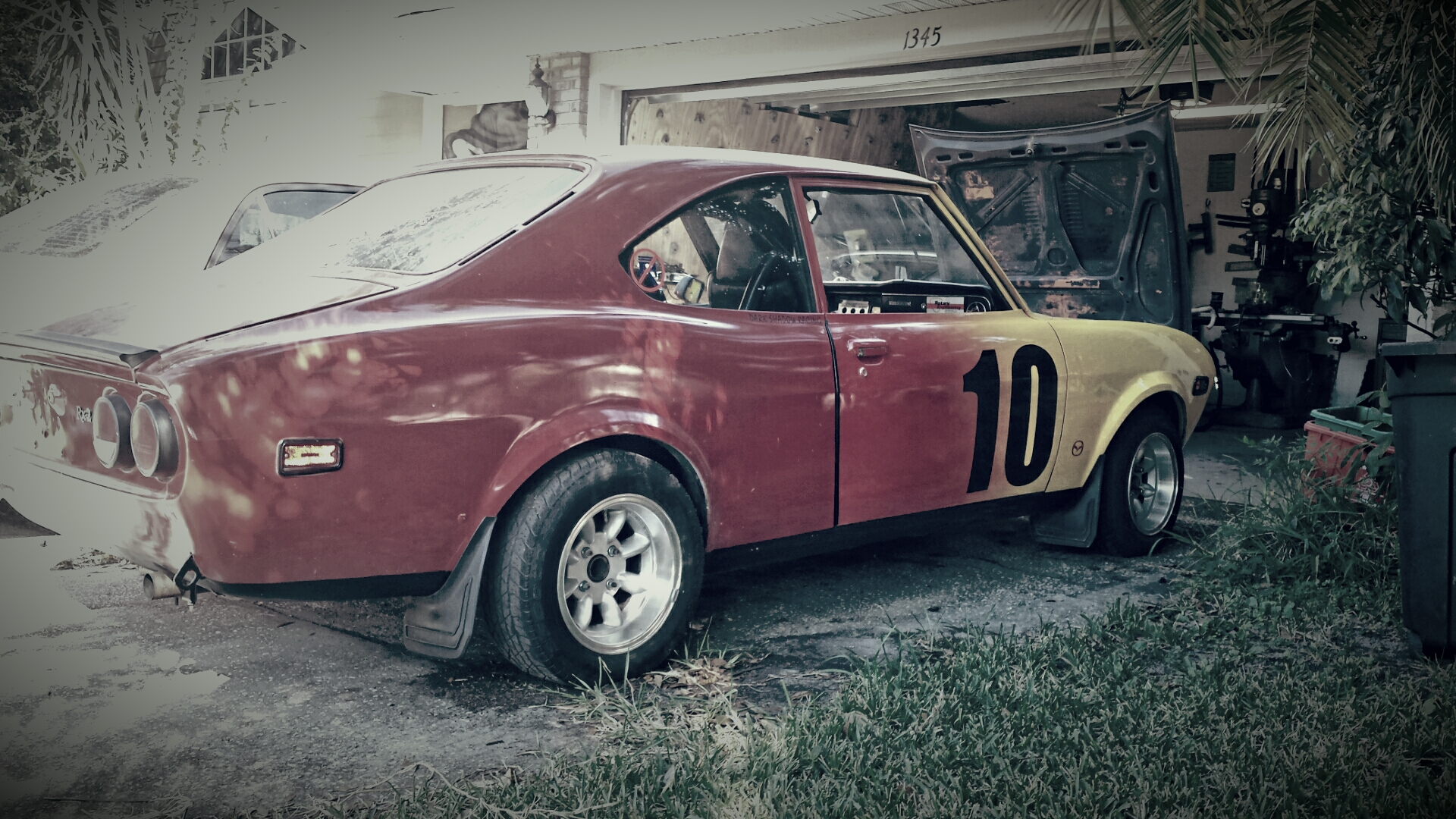

RX2 ... youve got my attention ! post some pics please. Sincerely a car guy
The paint job was like this when I got it. I'm trying to get everything else done before I attack that...
Thread officially derailed, lol...

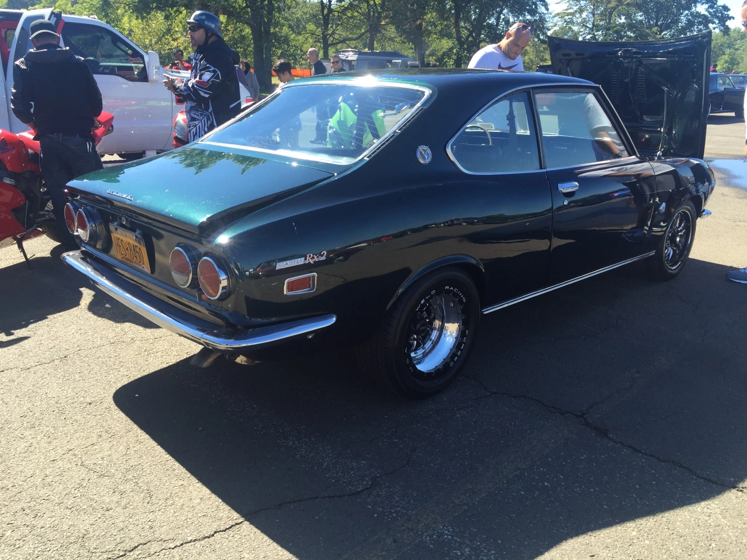

That's awesome ! There was a few at one of the last shows I went to up in the Bronx here . I'm into everything car wise
