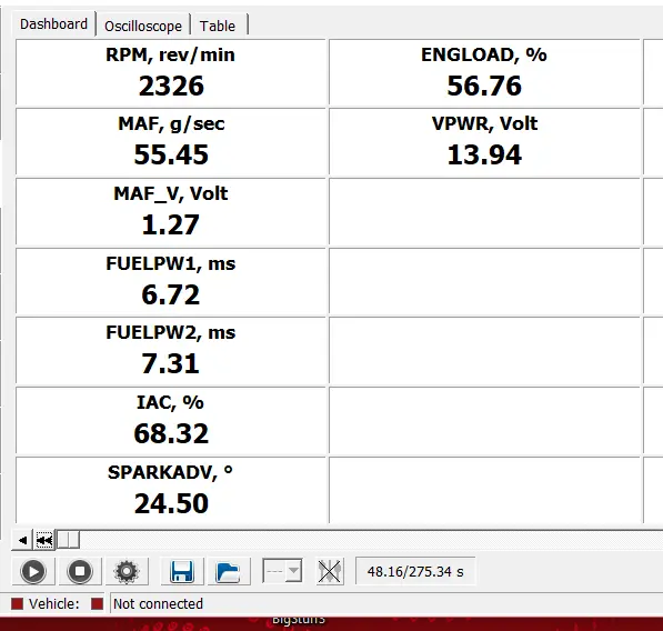

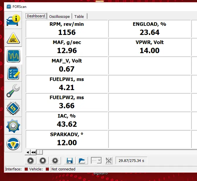

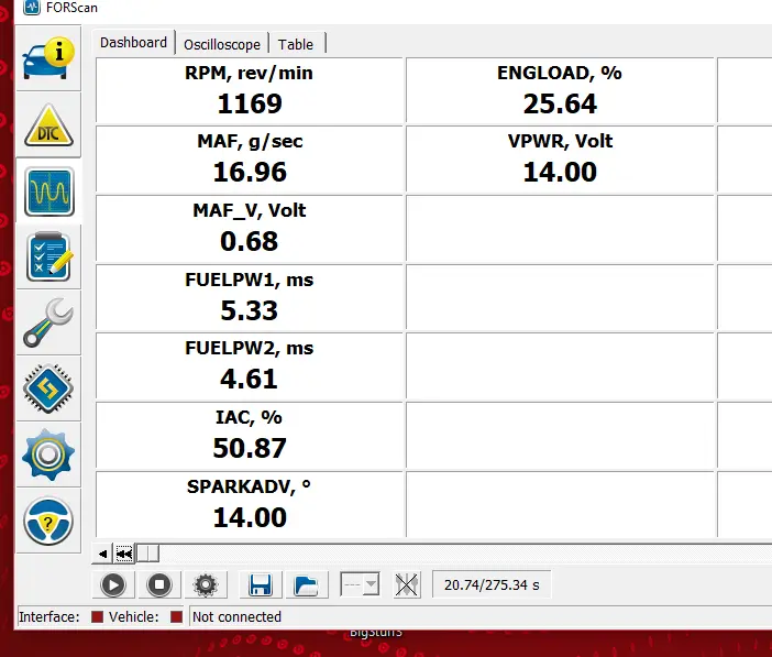

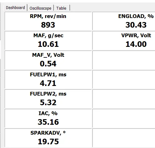

Perfect. Thank you! I'll update you when I have the wideband installed. I didn't have the adapter with the kit for usb so I have to buy one. I'll have everything hooked up, installed and a table uploaded late this evening if I can find an adapter without ordering one. BTW I think I have an injector missing, clogged whatever you want to say. Look at the numbers between both banks on these tables. They differ pretty dramatically at times and other times they are solid even with each other. I only displayed the times they weren't close.

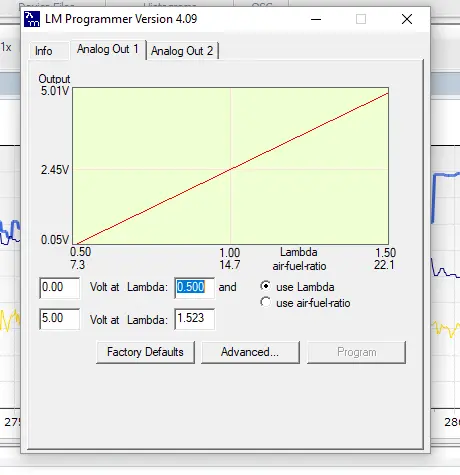

Update: I have stopped using the forscan software and have downloaded the livelink software from SCT. Great stuff! Has given me the ability to datalog without unplugging and plugging devices back in and out. I bought an adapter to use one of the analog channels so I can datalog with my x3 as a pass through device. My only problem is deciphering the chart on how to read lambda. Attached is the picture of analog 1 input configuration. I believe @ 2.45 Volts my wideband is reading lambda right? I first thought @ 1 volts it was lambda but now I'm doubting myself since the car is running worse than when I started. Any thoughts on this and how to read it?

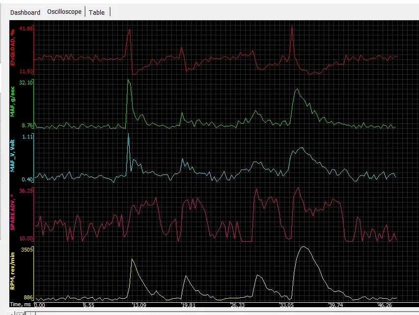

Stephen,
Attached is a datalog file from today. I got to tune my mustang 4 or 5 different times. I think the maf tables are dialed in as close to lambda as possible. WOT is also dialed in really close. When I turn on closed loop the fuel table should easily be able to adjust for what I need. I only have one problem now. The hanging rpm. You can view the file I attached below that shows it. How do I make the rpms drop after blipping the throttle without adjusting the maf table?
