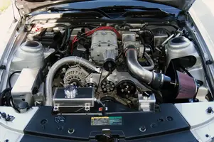

Have Brenspeed send you an emissions friendly tune. I have no trouble passing NJ emissions with my Bama emissions tune and a supercharger.
