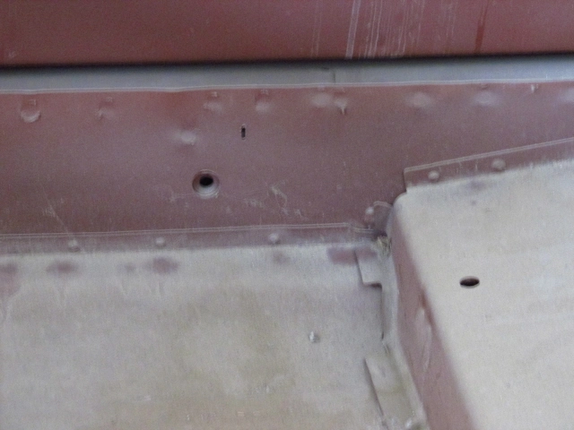

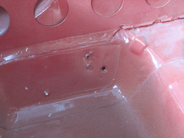

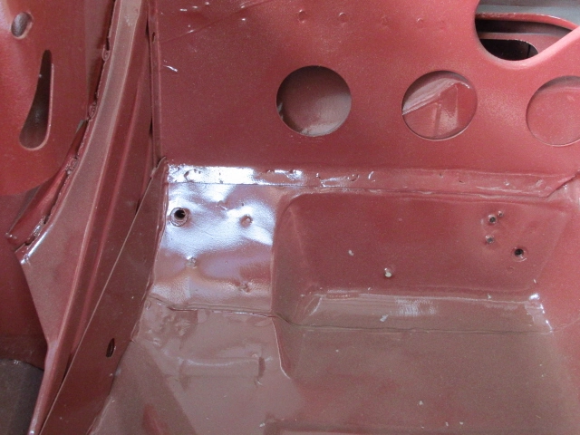

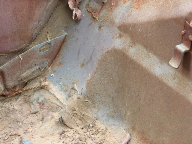

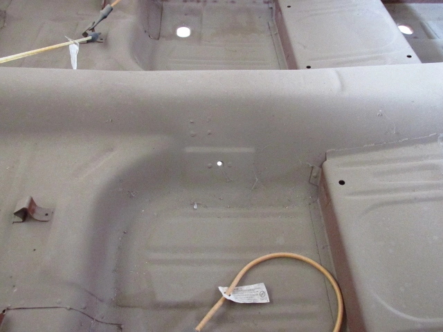

here are some pics of my 67 convert . The holes will be in the same location for 64 1/2 and 65, coupe and fast back.
This is the back seat area ,as long as you are close they will be fine .

DOH! After all the hours of scraping, welding and painting around those holes, I always wondered what they were for. Thank goodness, one of the few things that weren't rusted. Thanks horse.
