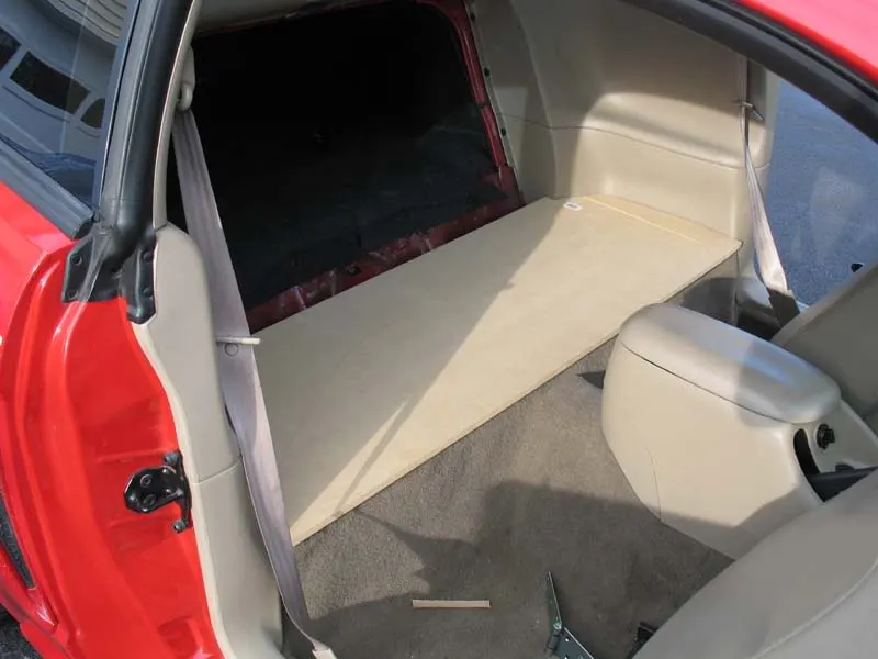

you will more than likely need to take the back seat out to get to them without damaging any of the trim pieces. i remember seeing this when i did my rear seat delete:
you can see those black studs holding in the trim piece that covers where the mechanism would be
you might be able to pry that panel back. its pretty tough material, but i usually wind up breaking stuff :D. you will need to unfasten the weather striping as you can see on the far left hand side
A good trim tool helps. Also do not expect to get the trim back in perfect the first time. It always takes more than one try to get it exactly right.
