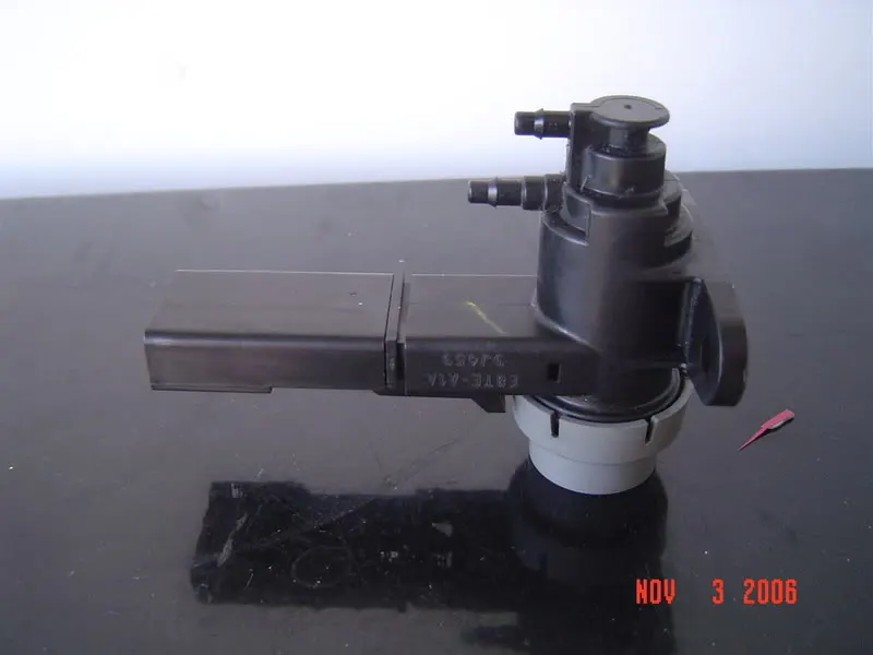

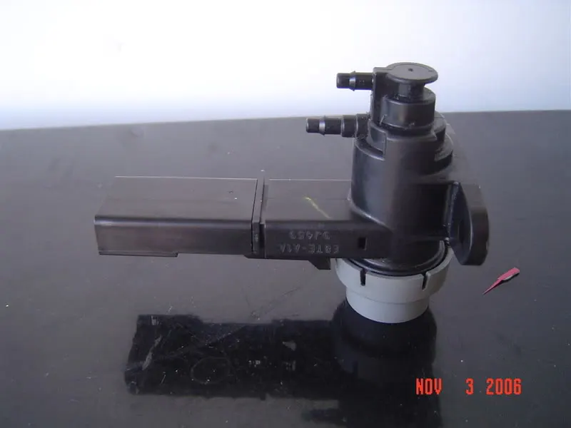

It might be the EVR, here is a pic, it goes to the egr and controls the vacuum.
Here is a pic off of the car and upside down
