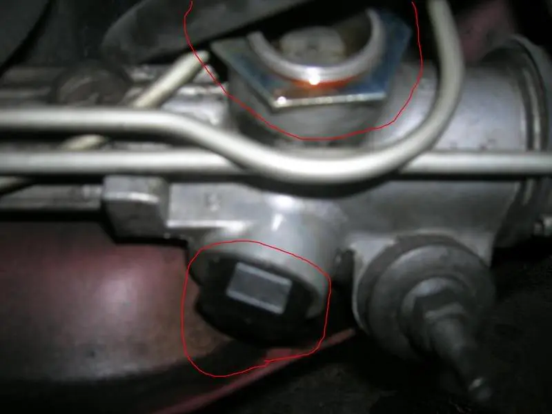

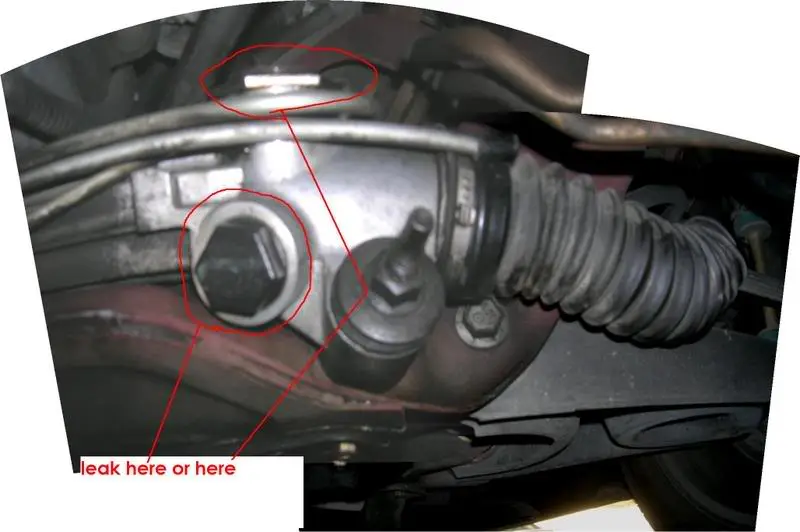

So here's an update on everything. I haven't gone to autozone yet, but I messed with my car some more. Earlier I said it was just below the minimum mark. Later it was farther below. So I put a piece of tape at the level it was at. Then I noticed a puddle. The fluid in that puddle was red. So there it is. A leak in the power steering system. So I wiped everything clean, and gave it some time. Checked again, and no leak. Then I Started the engine and snooped around under the hood. What I noticed was the power steering fluid level went strait down. Maybe that's normal, I don't know. So I opened the resevior and looked inside. It basically looks like a draining washing machine. Everything was sloshing and spinning into a whirlpool kinda thing. It was also a dark orange, and foamy. Normal? I don't know. I shut the car off and the fluid rose a little. Not up to the tape though. Then I gave it maybe 2 hours roughly. Went out and checked it again, and the leak was back, so I wiped it clean again. The level was above the peice of tape, but still way below the minimum. If you picture the distance between the max and min marks, it's equal to that distance, below the minimum. I'm not sure exaclty how to describe where the leak is coming from, and I don't know terminology well (which is why you call me a noob), so here's some pics. You can notice where the front driver's side wheel is in the roundish pic, which helpt's to get you oriented with the angle it's veiwed from. And in the second pic, you can notice the fluid inside the circle. I suspect the leak is coming from both parts, but it may only be because it's leaking at the top circle, and dripping around and past the bolt in the bottom circle.

yes, the leaks are coming from the top cirle in the pics. I don't know why they wont load, but I'll try to fix that. I filled it to just above the max line with power steering fluid. I started the engine, and is still does that whirlpool thing. It's foamy too, just a little. The brakes are making that sound again, and there's no power steering at the wheels. I noticed too, the brake pedal will be stiff as usual at first, then sink away as the sound starts. Then like it's been doing, it jitters, then kicks back. Not safe to drive anywhere. No steering, no brakes, on a manual transmisson. The brain can't handle all that at once for a 14 mile drive. Hopefully the dealership will pay for the tow.
No luck on the pics. Looks like image shack is down for the time being.

I kept trying, but couldn't get imageshack to work. Then a few days later I tried photobucket. So, the images I posted on page 1 last weekend are working now. You can see where the leak was. It was coming from the top circle of each pic. I filled it to the max line with fluid, and it still didn't work. Had it towed back to the dealership and had to listen to 10 minutes of "oh that's weird. usually the breaks and steering don't go out like that" "oh I've never heard of that before, that's strange". The next day, the shop told me what I already knew. The rack and pinion was shot. Leaking and needed to be replaced, and that was what caused my brakes to go out. I kept asking them, and stressed the issue on what caused it. The only responces I could get were "it was michanical failure", "the thing just went out", and "I'm not a ford person". They also replaced a line, and needed the car an extra day to bleed the system. They said it was fighting them. Whatever. The was no mention on any problems with the power steering pump. I can only hope they honestly did check it, and it checked good. The new part took several days to arrive, and cost $300. Labor was about $500 they said. That's a big fat bill that went strait to the used car department who sold me the car. Nothing cost me a dime, but although I'm not too sure, I think they test drove half a tank of gas out of my car. Also I was 3/4 of the way home before I noticed the wheel is not centered. Too bad for me though. I need a car NOW, and will just have to get that aligned some other time. Also the car doesn't pull to the left or right at all, which I like. (my old V6 mustang pulled to the right really hard. I think that's because I did all my donuts in the same direction. The car didn't have the power to do donuts turning to the left.)
