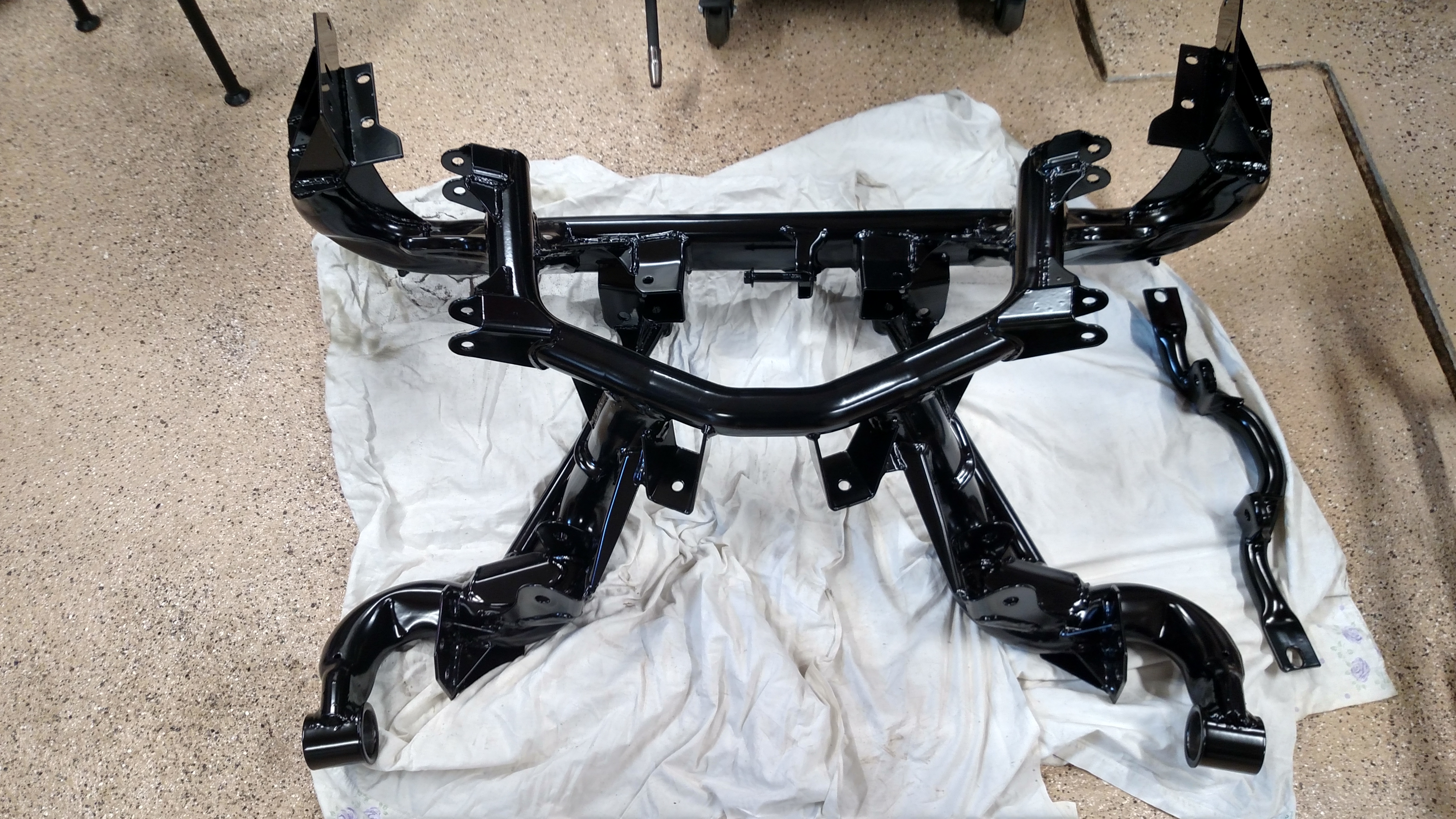

Haven't had time to get much done over the last few week, but I did get my IRS cradle back from the powdercoater. Really happy with the job they did and the price was awesome.

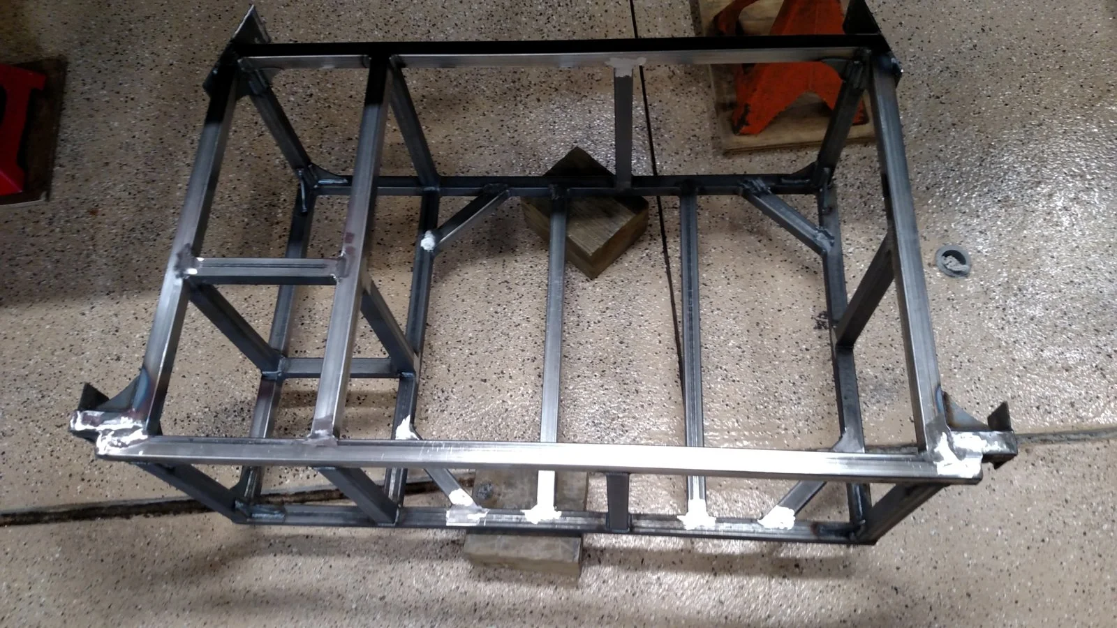

Also finished up the welding and grinding on the fuel cell cage. I ground down all of the welds on top of the unit and on the inside of the cage where the fuel cell will sit. I want the fuel cell to sit nice and flat and not have any stress points against it. I ground down the welds on the top so the lid sits nice a flat when installed.

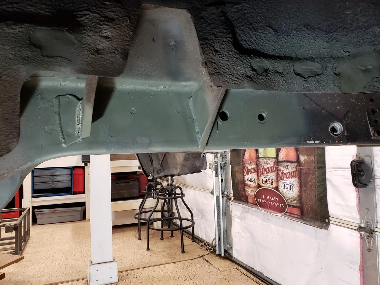

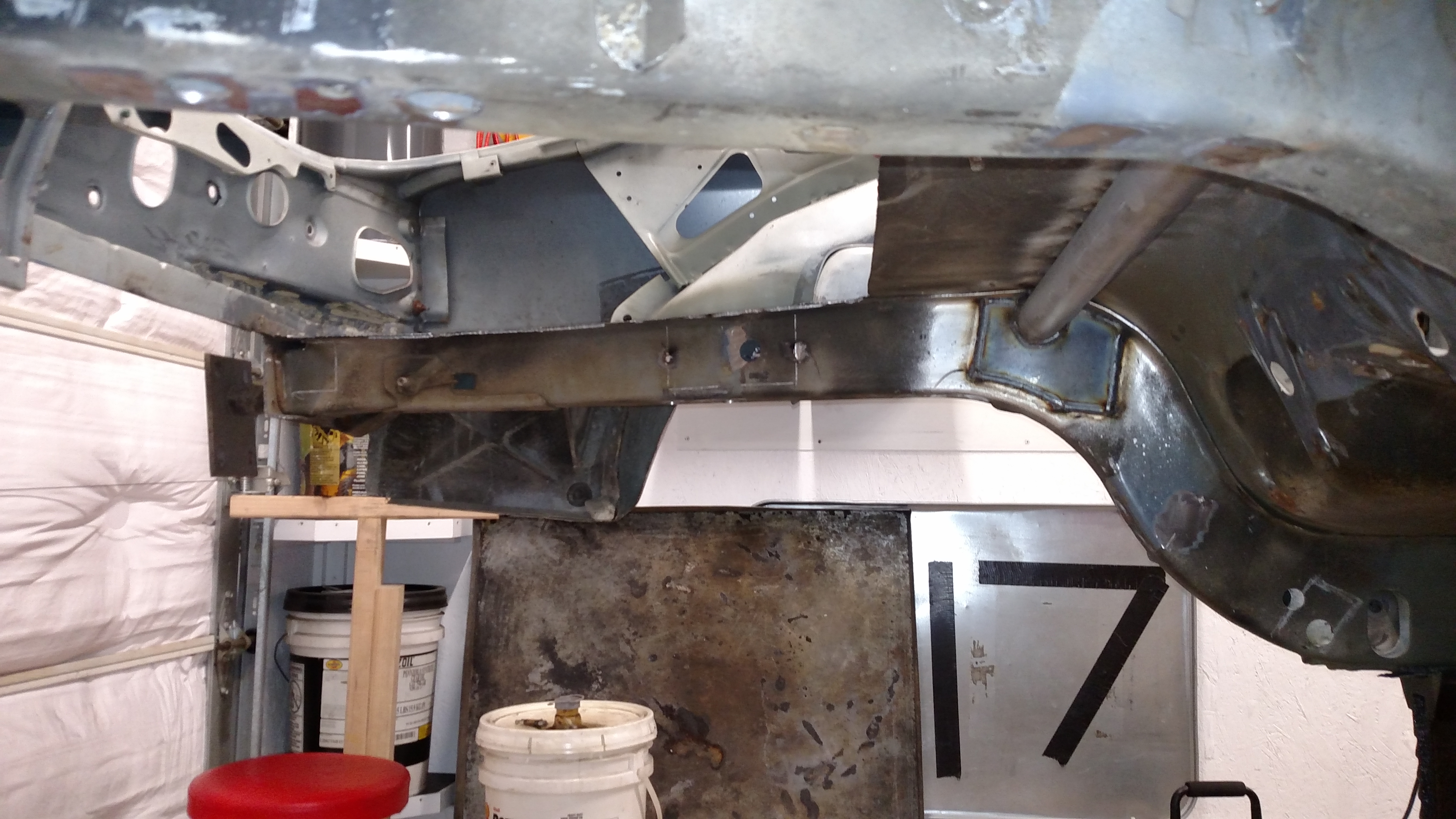

Finished drilling out all the holes for the weld nuts that will allow me to bolt the IRS cradle to the frame using my front and rear hard mounts. The bigger holes are for the weld nuts that won't be a thru-bolt design. The smaller holes are for the thru-bolts, there is a bigger hole on the other side to accept the weld nut. I will be welding a section of 1" DOM tubing inside the frame rail from the weld nut to the other side of the frame to prevent crush. There is one-through bolt for each axis on the front and rear hard mounts. I figure that is overkill enough...

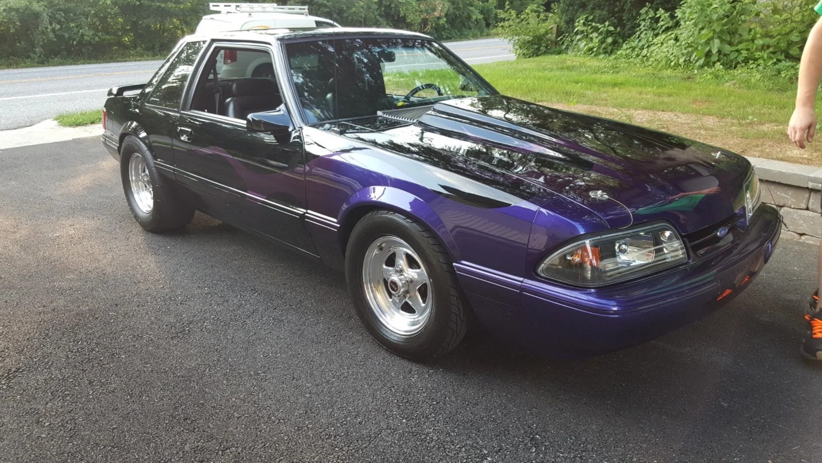

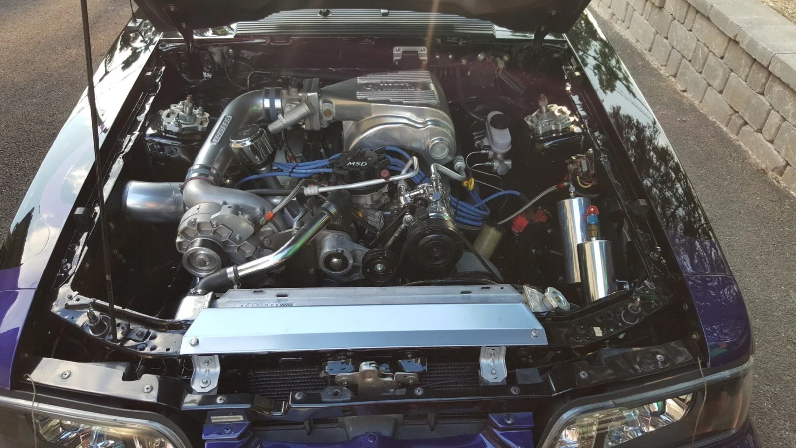

For those that didn't see my post in the "How your foxbody currently sits thread", I bought another fox that I'm hoping to get sorted out this winter/spring and be able to get to the drag strip next year. I've been missing having a running fox and have always wanted a more street/strip drag orientated car, so hopefully this car will fill my addiction while I keep this build moving forward. It's supposed to be a 10.5 second car as it sits and I have lots of plans for upgrades. Here's some pics of that car:

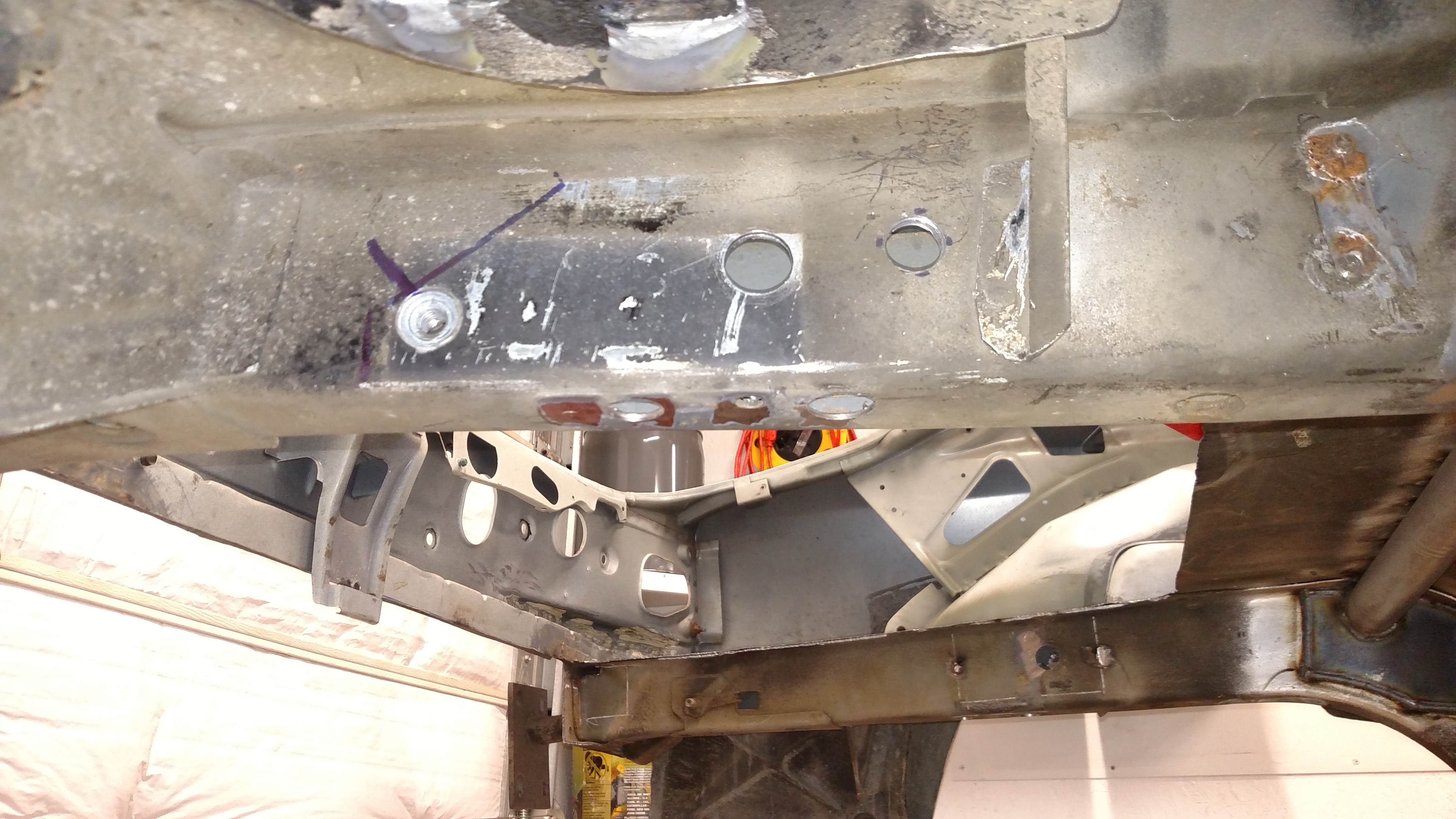

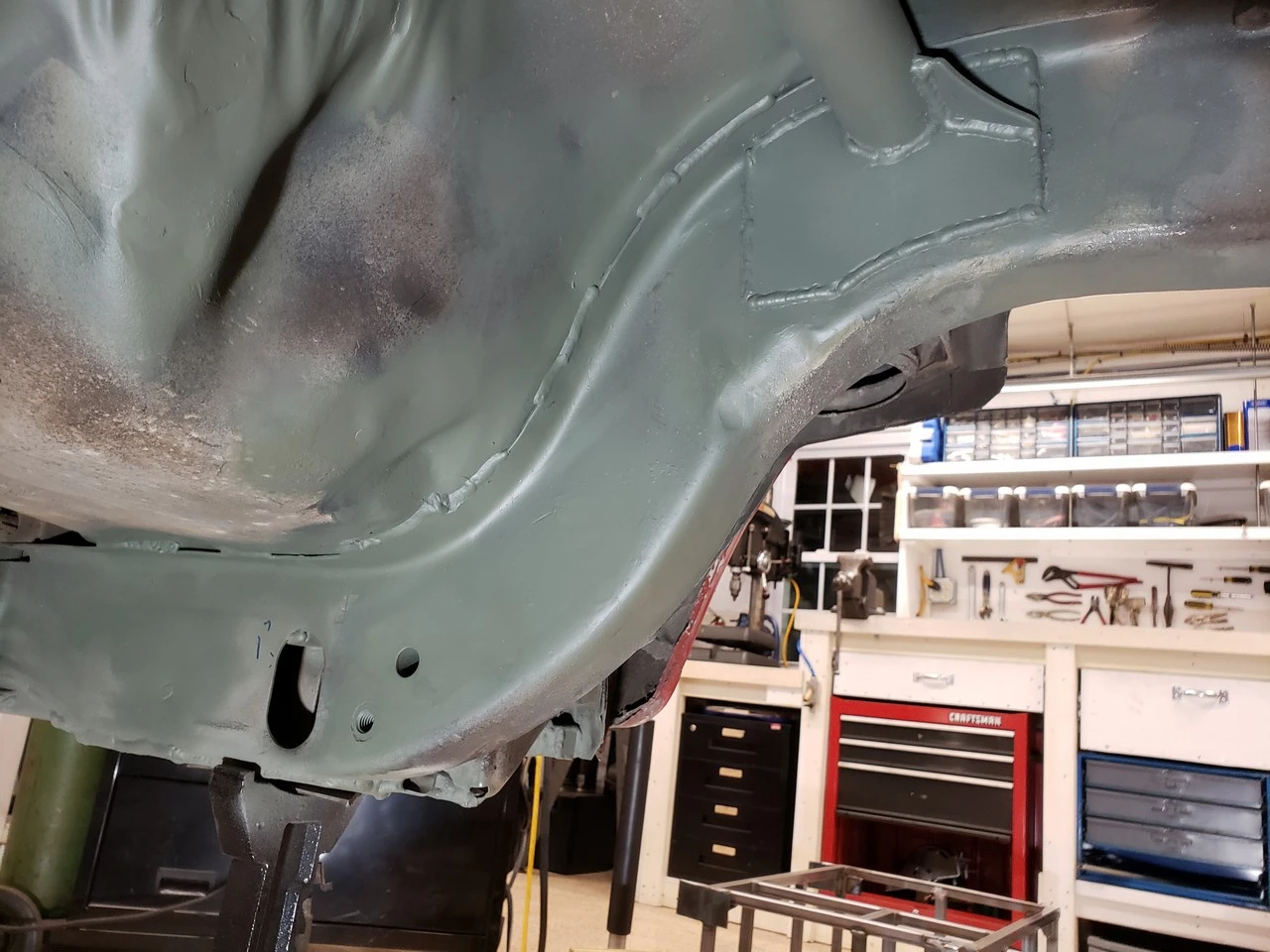

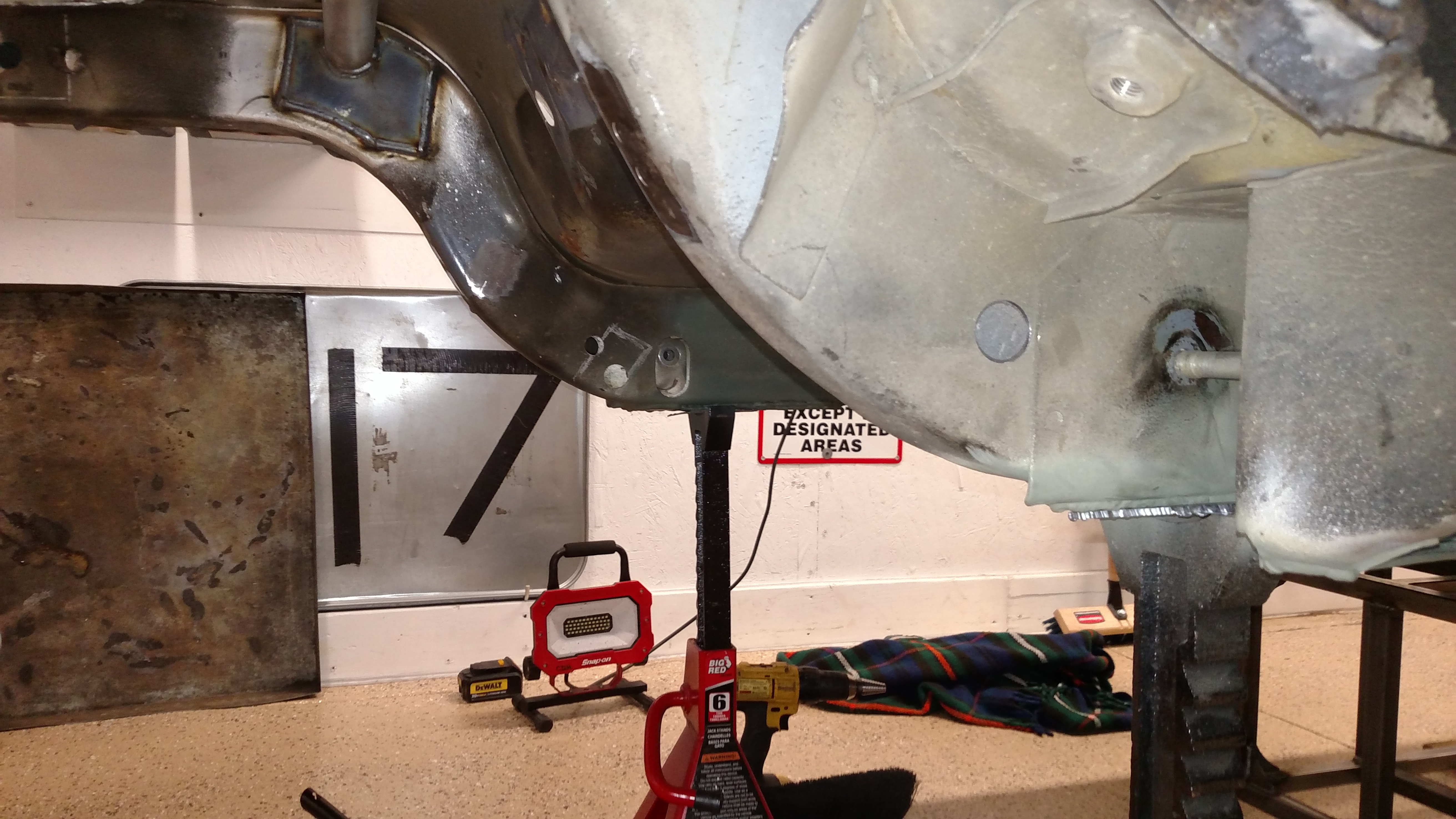

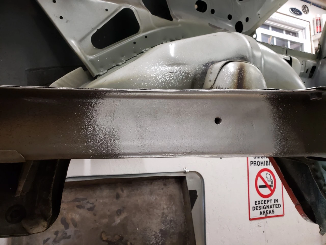

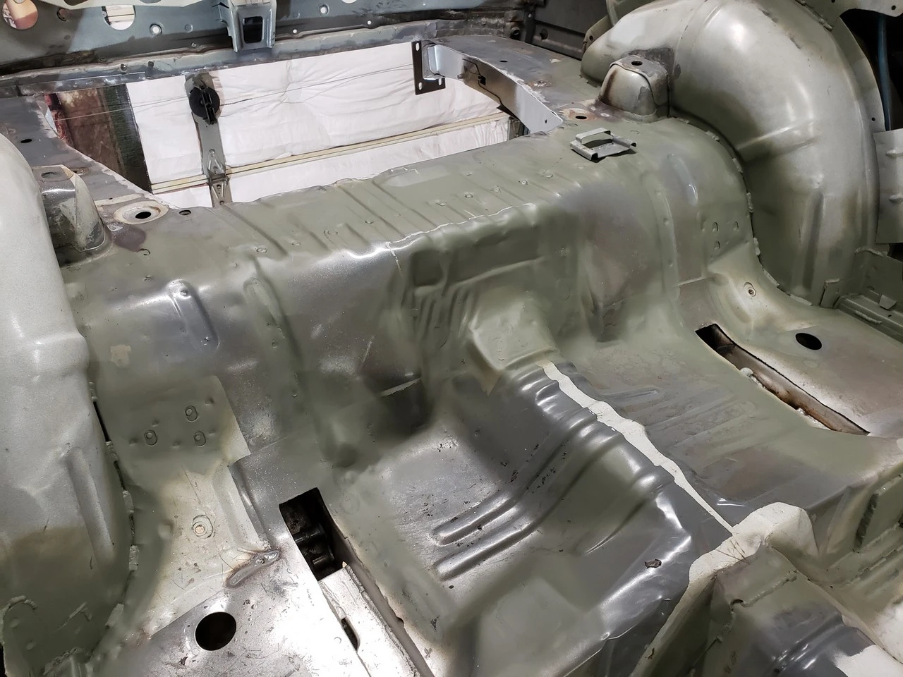

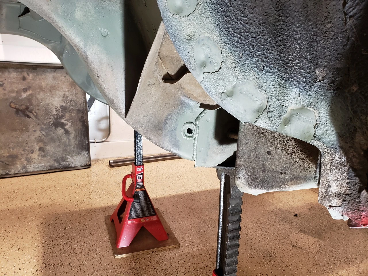

Welded all the holes and cleaned up the back half car where I had removed the upper torque box mounts. Also fixed all the cracks in the sheet metal from the abuse the upper torque arm mounts took from the prior owner.

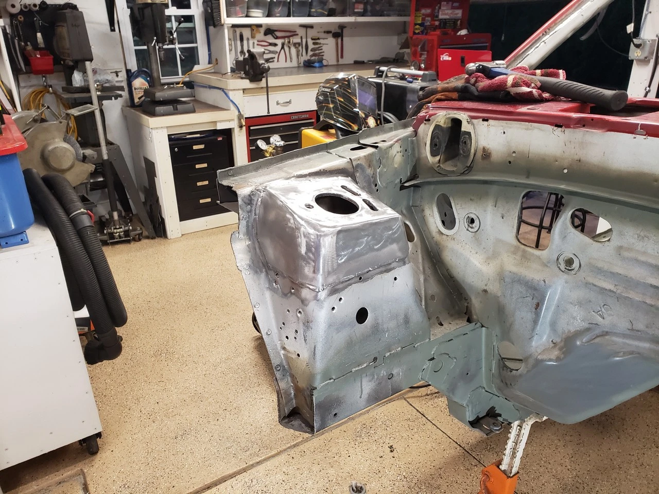

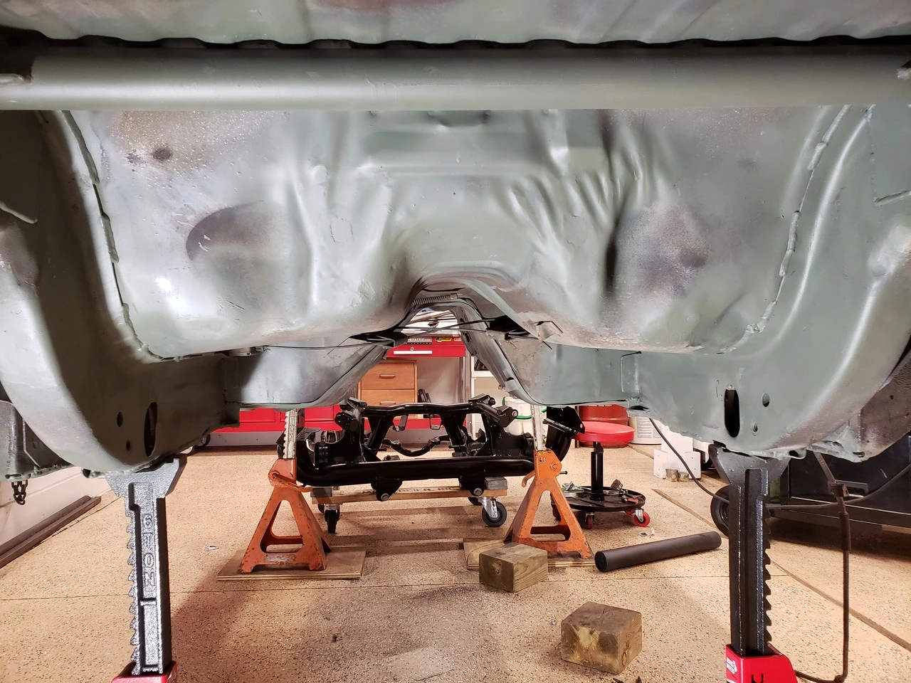

Cut the front off the car off to start prepping for the tubular front end, and to make it easier to work on the strut tower reinforcements and engine bay smoothing.

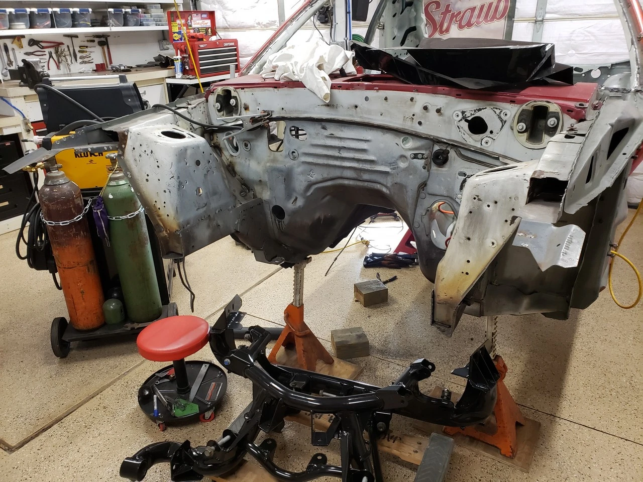

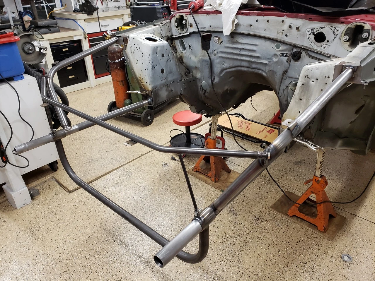

Here is the 417 Motorsports chrome moly tubular front end being mocked up. I'm not going to weld this in yet until I get everything done in the engine bay.

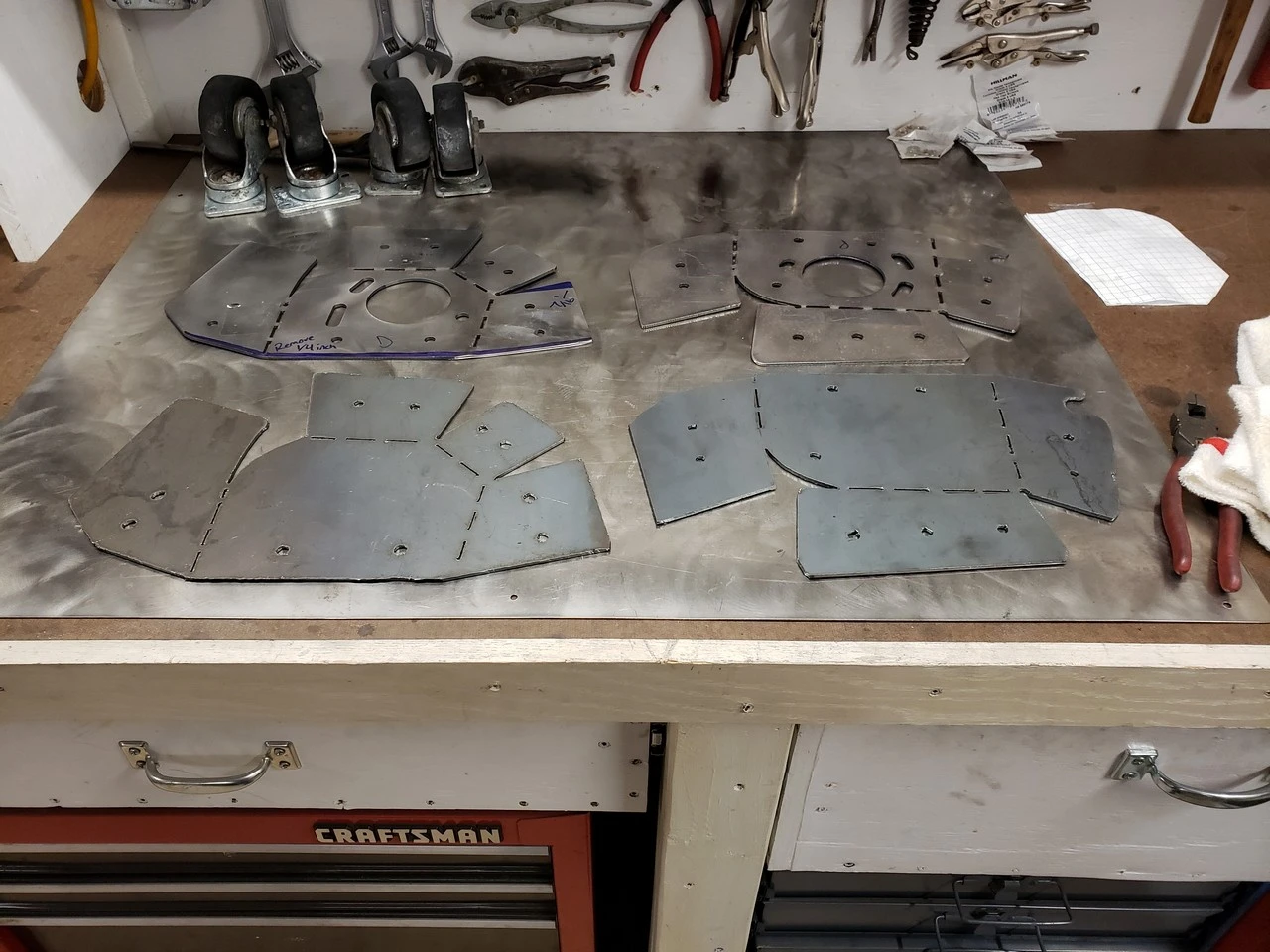

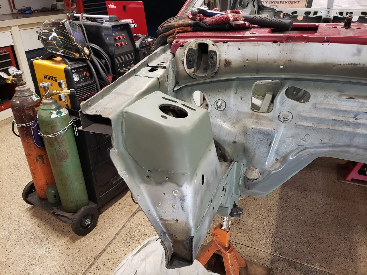

So, the guy I bought the strut tower reinforcements ended up screwing me. I waited, and waited, and waited for him to deliver the modifier strut tower reinforcements that I had worked with him on, but he never delivered. I kept getting e-mails from him basically stating that he has been busy but he should be able to get to them this week. I'd wait a couple weeks and contact again and I would receive the same story over and over again. In the end, I can't recommend getting anything from Izzy's Custom Roll Cages (Izzy's metal shop). Once you screw me over once, I won't ever deal with you again. Can you tell I'm a little salty about this?
Anyways, I ended up making the plates myself with the modifications that I recommended.
632302
Here they are getting welded on the car, smoothed, and then primered to keep the rust off.
632303
632304

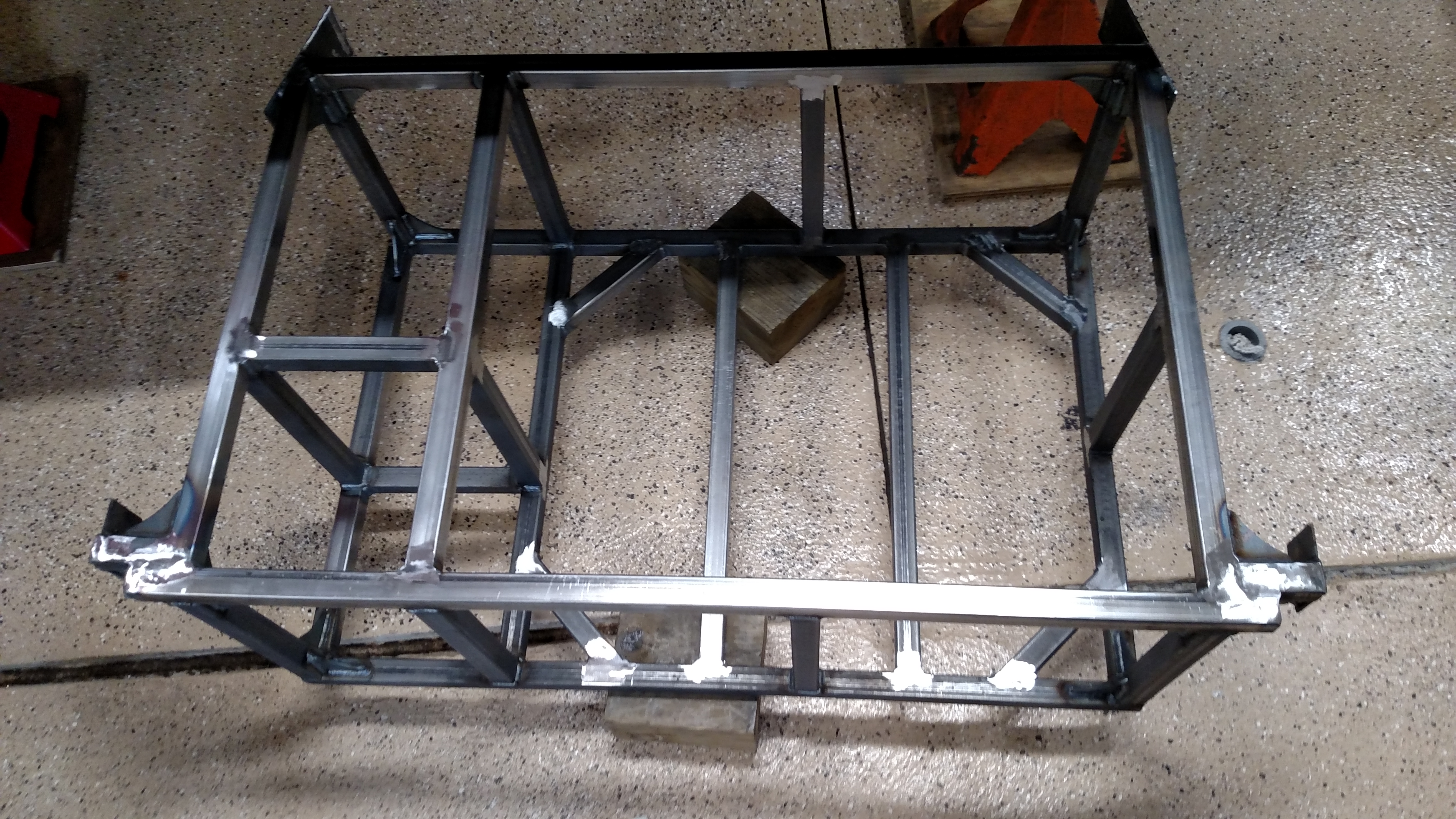

Forgot to mention I messed up on the fuel cell cage. I had commented back in Decemeber I was concerned with how deep I had to make the cage to fit the 20 gallon fuel cell. Well, that concern was legitimate. Before I started welding the fuel cage in I test fit the IRS cradle and discovered that the cage was less than a 1/4" too long for the IRS cradle to fit nicely. I've decided I am going to re-make the fuel cell cage for a 15 gallon cell instead of the 20 gallon to allow me to go a little shallower and a lot shorter to clear up some space. Was really hoping for a 20 gallon, but it's just going to cause too many issues. Anybody need an oversized fuel cell cage? :rolleyes:
