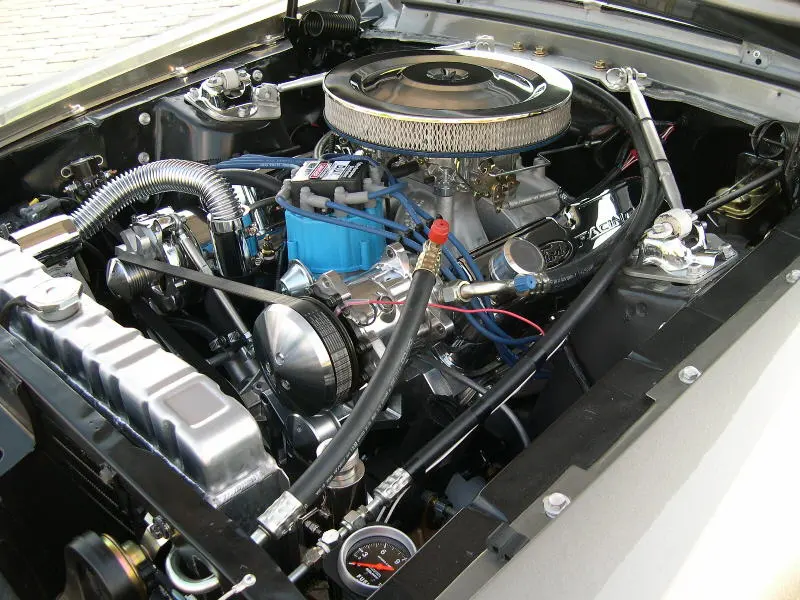

Here's my setup on a 351W...with a/c and power steering. But I do have an electric fuel pump. My pulleys and bracketry is all March.
Good luck!
Kelton

for an electric pump, you can use an inexpensive carter pump. they are reliable and work great. you dont even need a pressure regulator with the carter pump like you do with other pumps.
