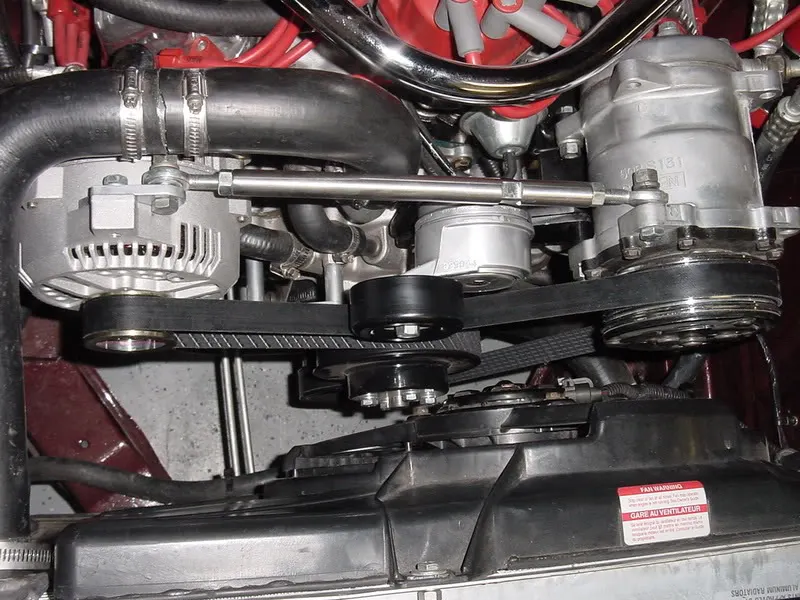

I just did a serp swap, but I have AC and no PS. It looks like the items you picked will work, but I can't say about how the PS will mount up.
What alternator are you using? I wasn't able to use the Alt pulley in the Fox kit on my 3G. I had to modify my AC bracket to line up correctly and I added the tensioner later.
What about fuel pump? If you are running a mech, clearance near the PS pump could be an issue.

Sounds like I'll probably be needing a tensioner?
Not necessarily. I added it because I upgraded to a 160Amp 3G and when the AC was on, the belt was flopping around more than I liked. I could see the belt was slipping from small bits of black rubber on the front of the Alt case. Since I added it though, no sign of slippage and no flopping.

I am going to install a serpentine belt setup on my 65 with 302 when the car is closer to running. I don't have an engine yet. My car has AC with modern compressor and no power steering.
What serp setup did you use and where did you get it? Is it just off of a Fox body 5.0 or is it a new kit? I like how it looks, clean and simple.
I don't want a March setup or any billet stuff. I need one that doesn't break the bank either.

I have the Vintage air system which originaly came set up for v-belt system, but I was able to modify the bracket to fit the rev rotation pump. Since then, I've upgraded to a new 160 Amp 3G with a 2" pulley (holds 90 amps at idle) and added a tensioner w/bracket.
