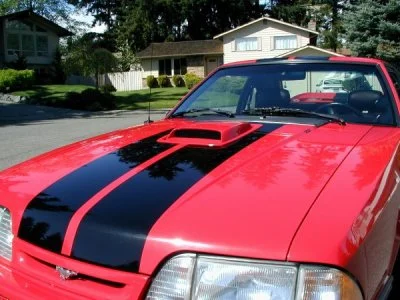

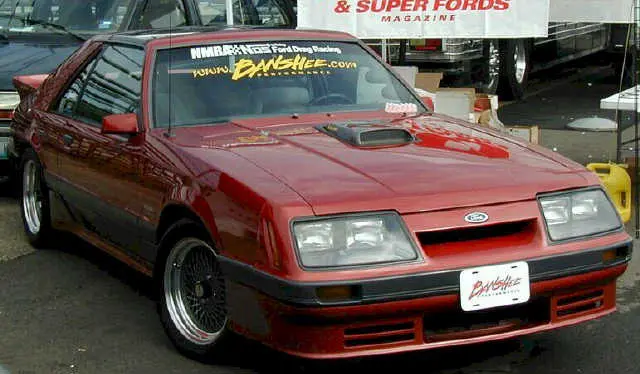

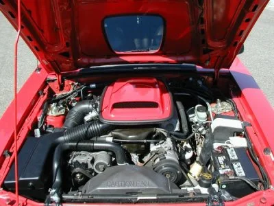

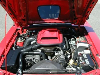

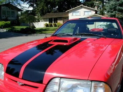

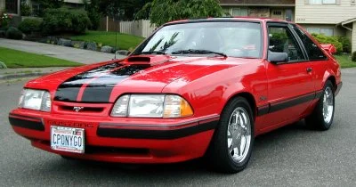

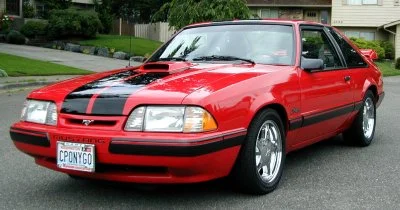

Banshee Performance used to make a kit, but the website has been down for several months - I think they went under. The kit only fit on a stock 5.0 with stock intake manifold, although you might be able to modify it to work on something else.
The only thing I would have liked to be diffferent was for it to be a copy of the old/new Mach 1 - instead it was a smaller smooth plastic scoop. But seeing that it came out way before the new Mach 1 was even a glimmer in Fords eye, there were problably legal issues with making a copy of the old Mach scoop - not to mention the cost of cast aluminum compared to molded plastic.
I had it on my 1991 when I sold it, but the guy who bought it took it off when he changed the motor. Here's what it used to look like:

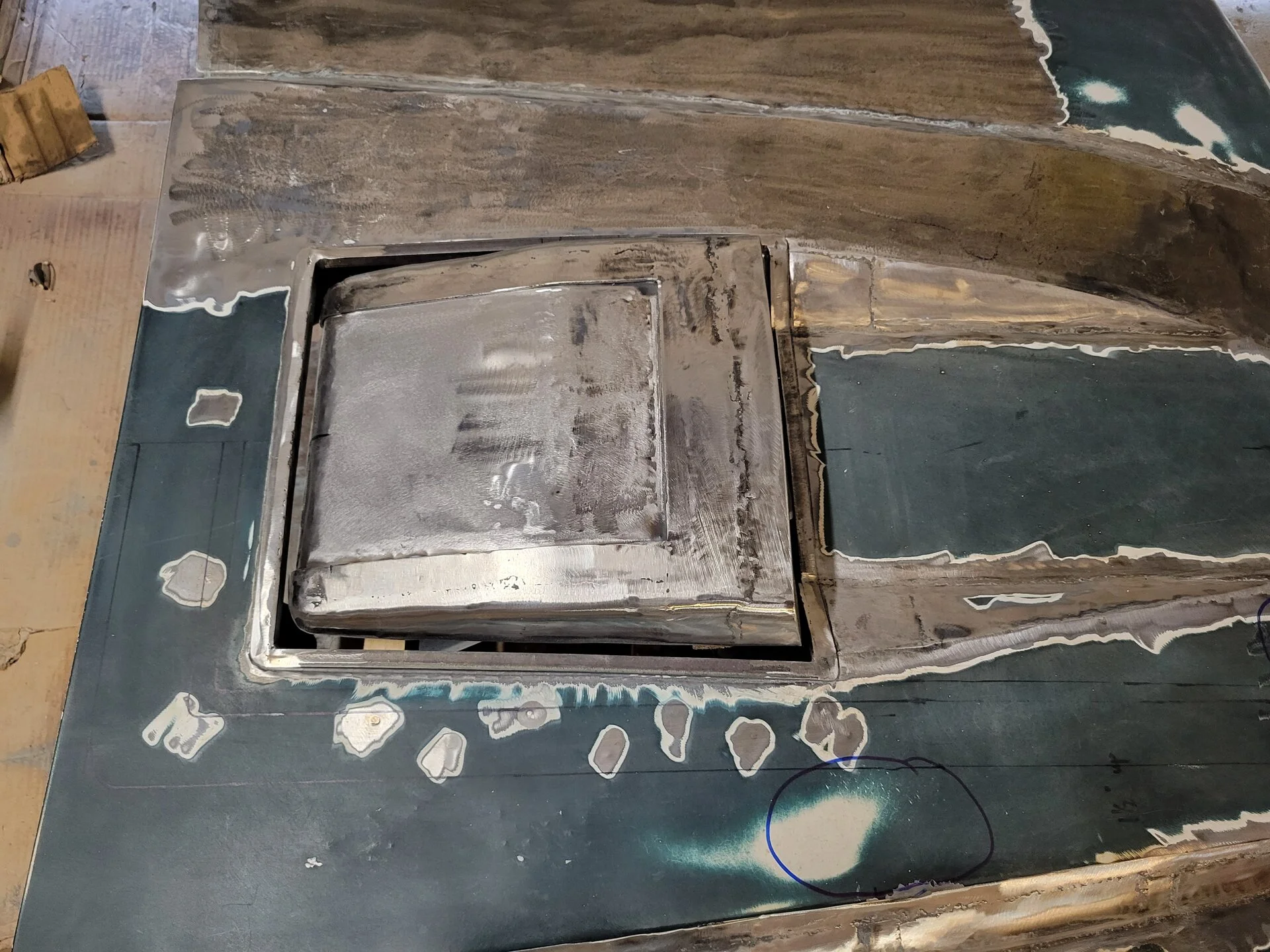

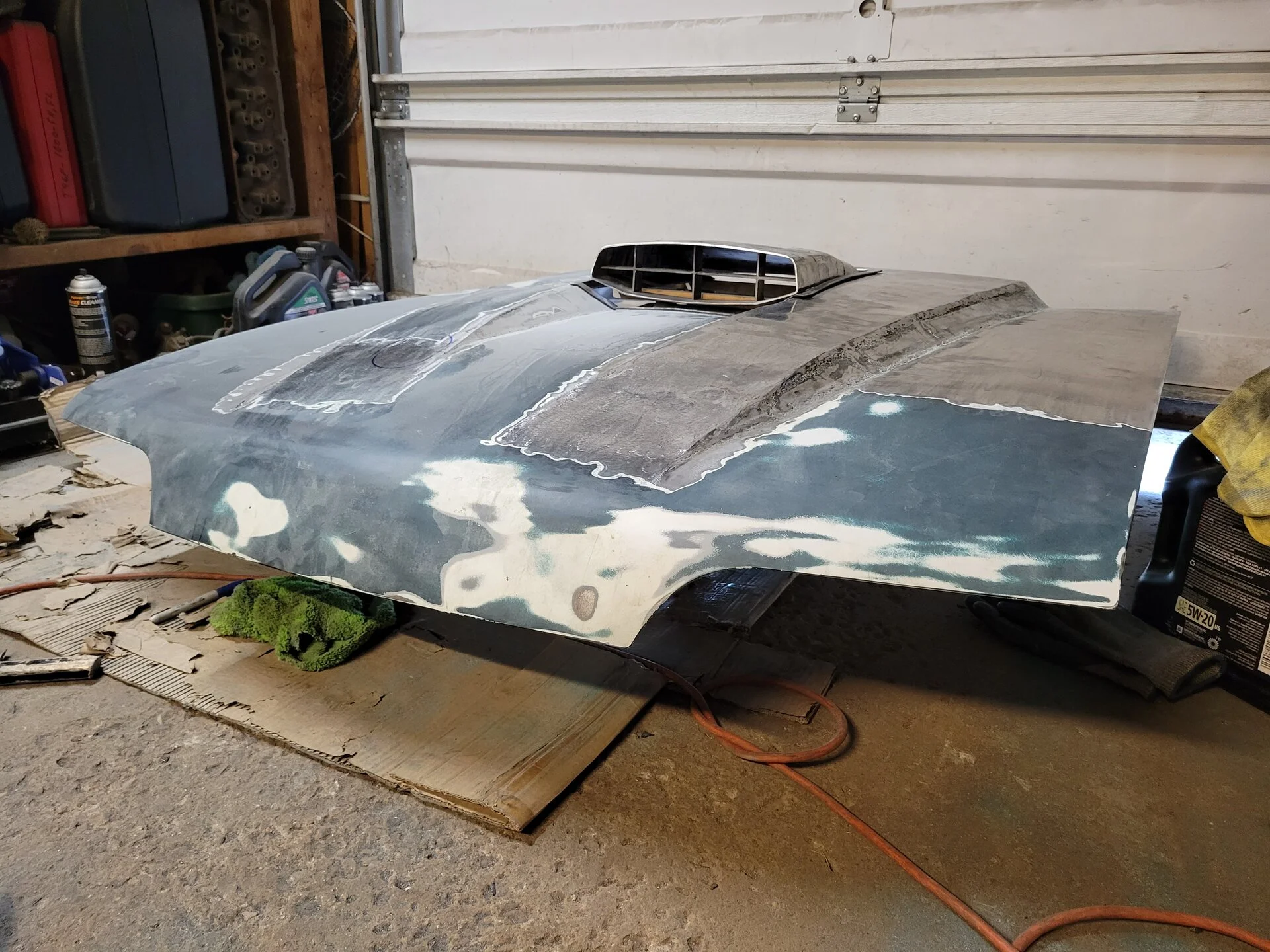

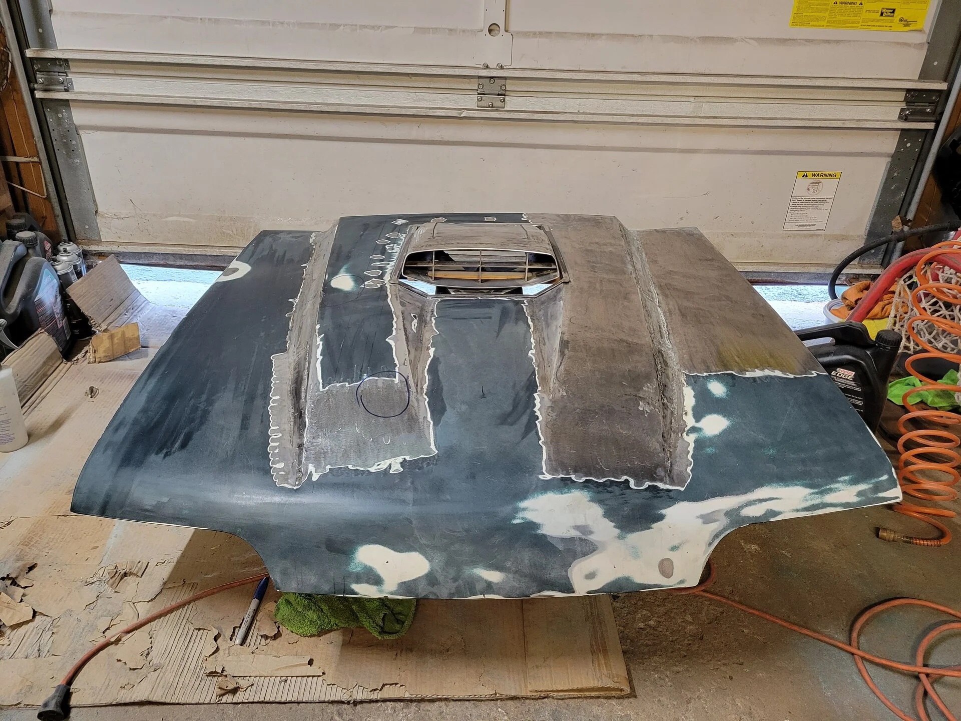

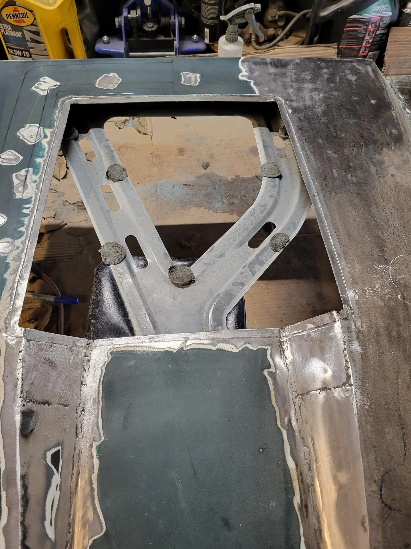

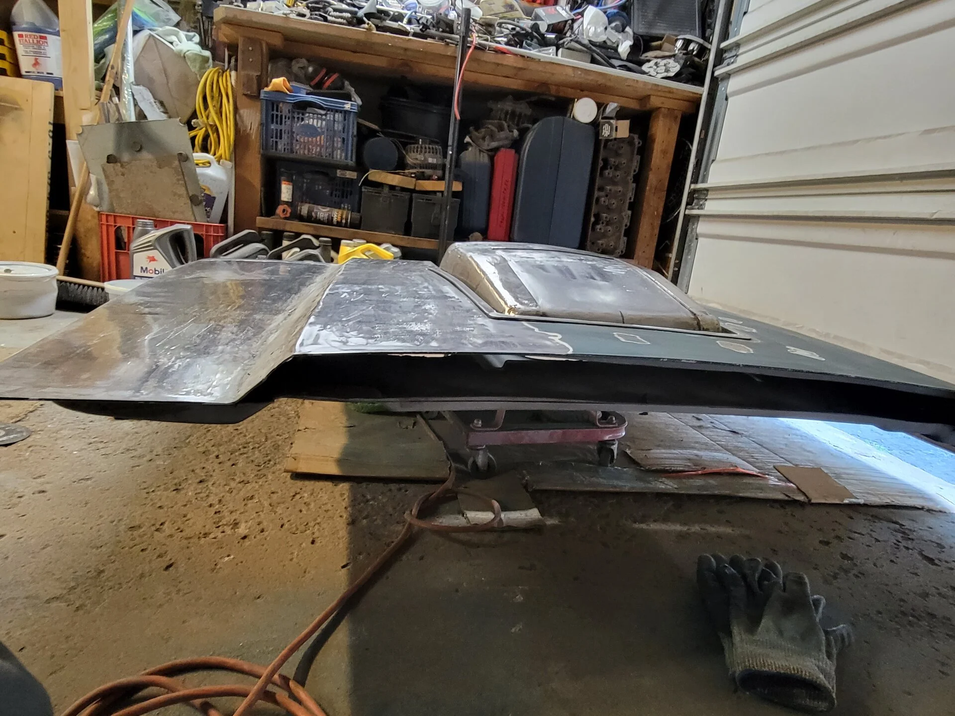

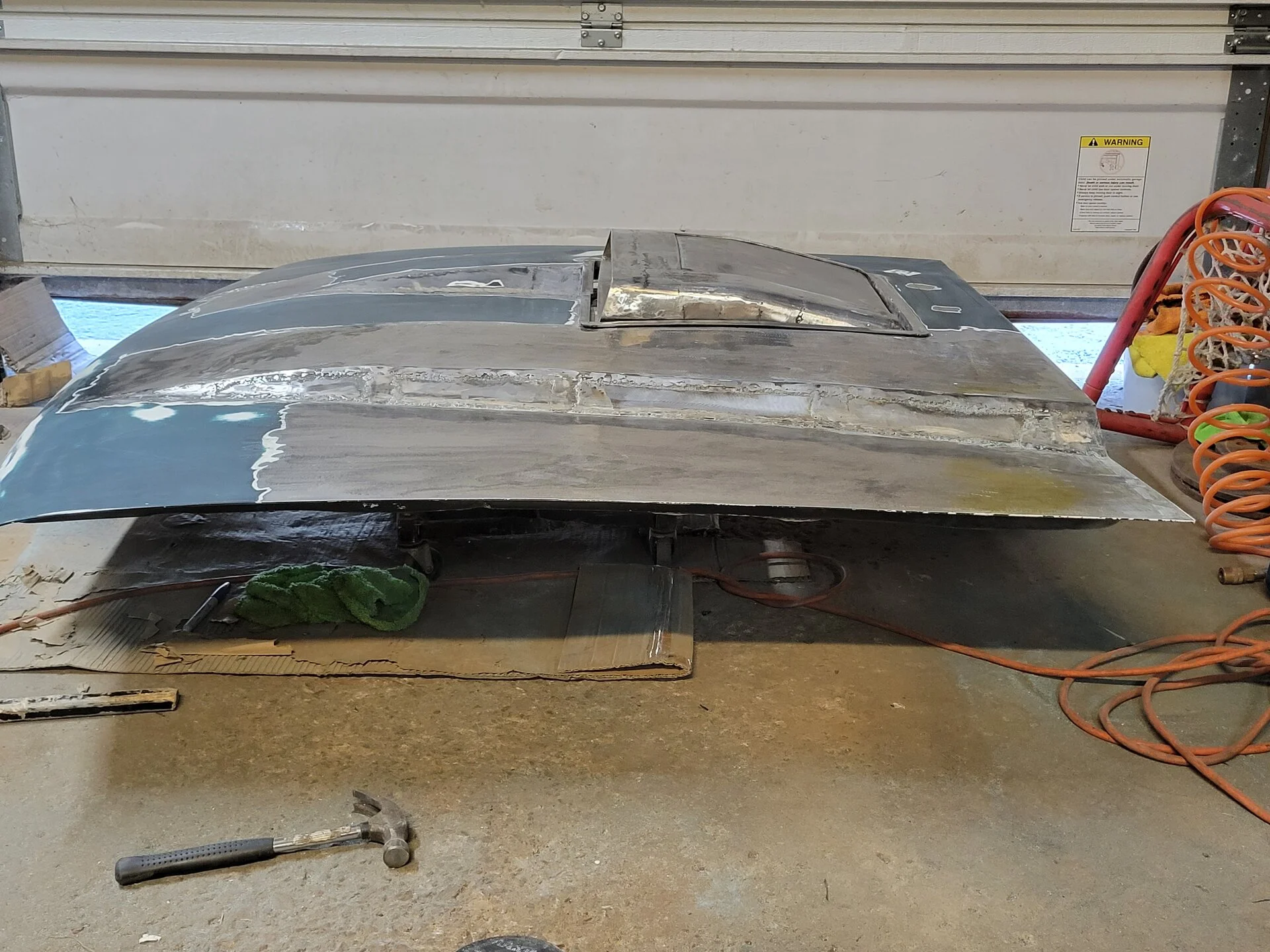

Making my own.
You can see how much of a cowl I created. The front edge of the scoop opening is touching the factory bracing. The rear raised about an inch. The bracing shown will be cut out when I go to figure out how to connect my scoop to the upper intake and plan the ducting to air box.
