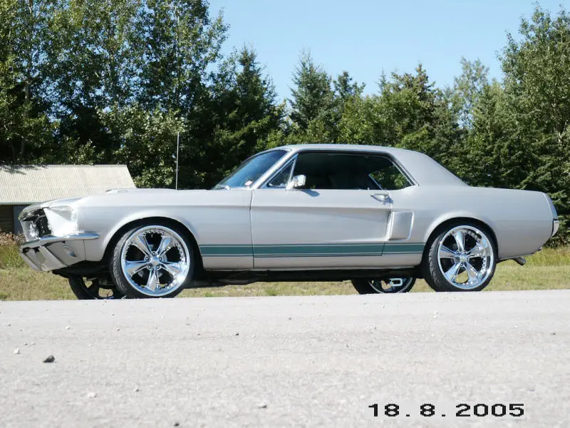

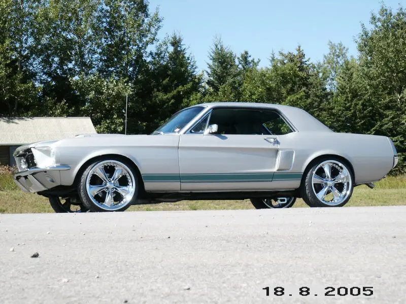

Just found out 20's work...
Thanks, Jay. I know lots of people run 17's, but I'd rather have the 16's. I think they fit the proportions of the '67-'68 better. My car is also a lot lower than the one in your pic and the tires don't rub now, even though it's close. I was just curious as to how close it would be with 16x8's before I spent the money for them.
