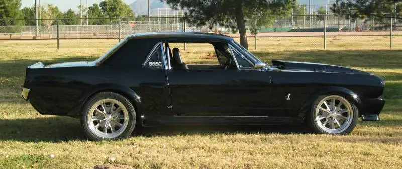

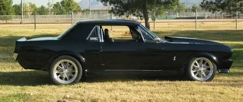

I'm all for the 17" look :nice:

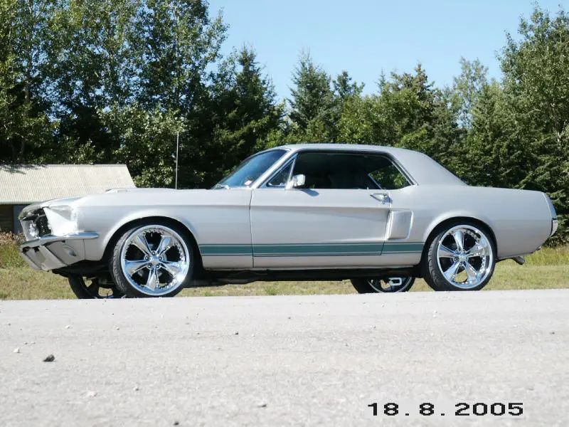

Opentracker, nice pics. I see it really isn't too much trouble to clearance the A-arm. But most 16x8's built for older Mustangs use a 4 1/2 backspace, which is only 1/8" more than my 15x7 shelby wheels. That means that there will be 7/8" more wheel to the outside than mine and I don't have that much room, so how does everyone claim to run 8's on the front that don't rub with no modifications?
mdjay said:
Come on now John! Let's not get into this debate~
This is a matter of preference!
That is a bad-ass looking car. I GIVE! - - Those wheels look killer!

Most are runnin 4.75" with TTII 17x8" and about 1 deg neg camber! Most are also rollin the fender lips...

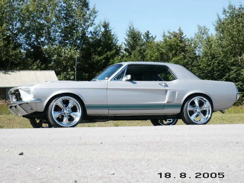

IMO It's the bling factor that can kill the look on an early model.
Ex Big-Mac did a nice job with 18's

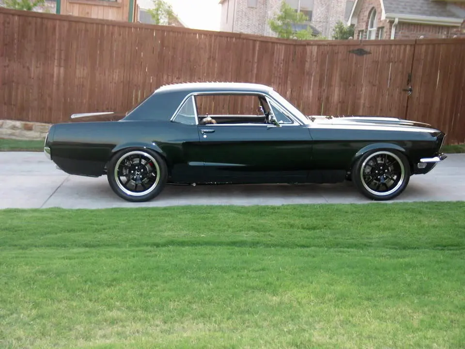

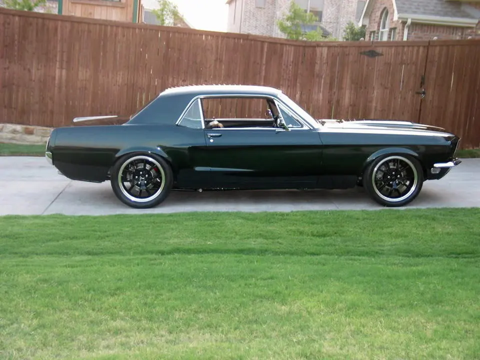

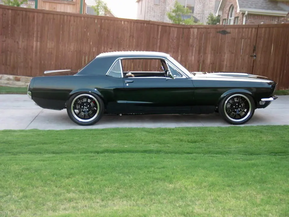

OH, you had to go and role out Big-Mac didn’t yah. That is the one and only classic mustang that I thought looked good with 18”. However, my personal limit is 17 and I really want to go 16 because I like to see some tire on the rims.

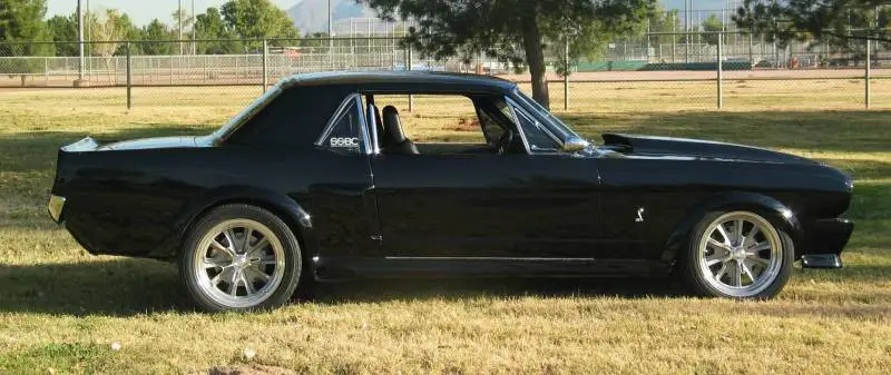

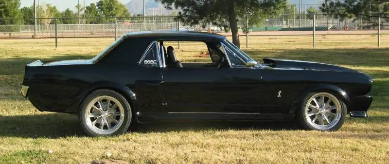

Just found out 20's work...
Looks better like this...
