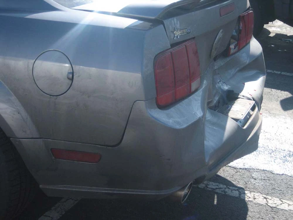

Thanks to some nice lady in town (see attached pic), I get to remodel the rear end of my 06 GT. So now the big question is, has anyone put one of the GT500 spoilers on the GT trunklid? If so, was it a direct fit or was there a different bolt pattern? I'm guessing it bolts in the same position as the GT spoiler but hopefully someone can educate me on this. Hopefully it does not need new holes drilled.
I figured this is the best time to make the switch....so any help is appreciated!
Also going to add the Shelby bumper. Just enough of a switch to make it mine but not to the point that I'm trying to clone :)
thanks, LB
