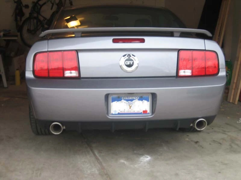

Here is an update to the car. It took about a month to get it back but I'm very happy with the results. We were actually able to get all OEM parts which is unreal in the insurance industry since it was last years model. Anyway, I've attached a picture with the shelby bumper. I wasn't able to get the spoiler on this trip because it had no damage. I will get it soon though. I am looking at a 5-lug for my 91 and also looking at a 65 stang to purchase so it will be after those items are addressed. I will post pics once I get the spoiler.
partsbill - thanks for the info. I am definitely towards the shelby spoiler based on that. I have a buddy that owns a paint shop so I'm in good shape there too. I already checked price and I can get it for around $230ish.
