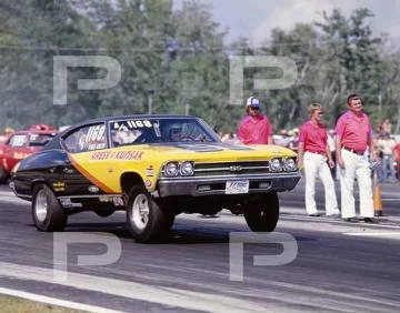

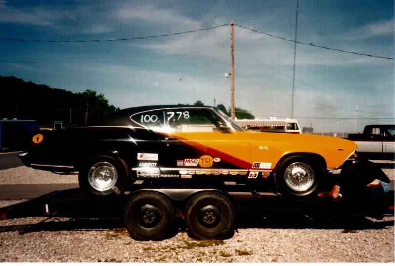

yeah i have no interest in a supercharger. i'm not looking for big numbers. i used to drag race a 650 HP Chevelle back in the 90's. i just want a good sounding exhaust on a good looking car and if i can squeeze another 10-20 HP out in the process cheaply and easily then i will but not much more than that
Today, a 650 HP car is a Daily Driver. :coff:
yep. back in the mid 90's i was running naturally aspirated. had a 454 .060 over. 12.5:1. .685/.692 lift Lunati roller with 280 and 2828 duration @.050. RPM range was 3700-8400RPM with a 4500 8" stall convertor and 4.56's. Street legal but not much fun to drive on the street
Got any images? We [love] pics (ok, I do but they do too :D ). Doesn't matter if it's not a Mustang. We still like to see :nice:
