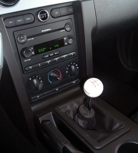

Anyway, here is a picture of the shifter in my car (Pro-5.0 Shifter and Hurst Handle/Knob)
