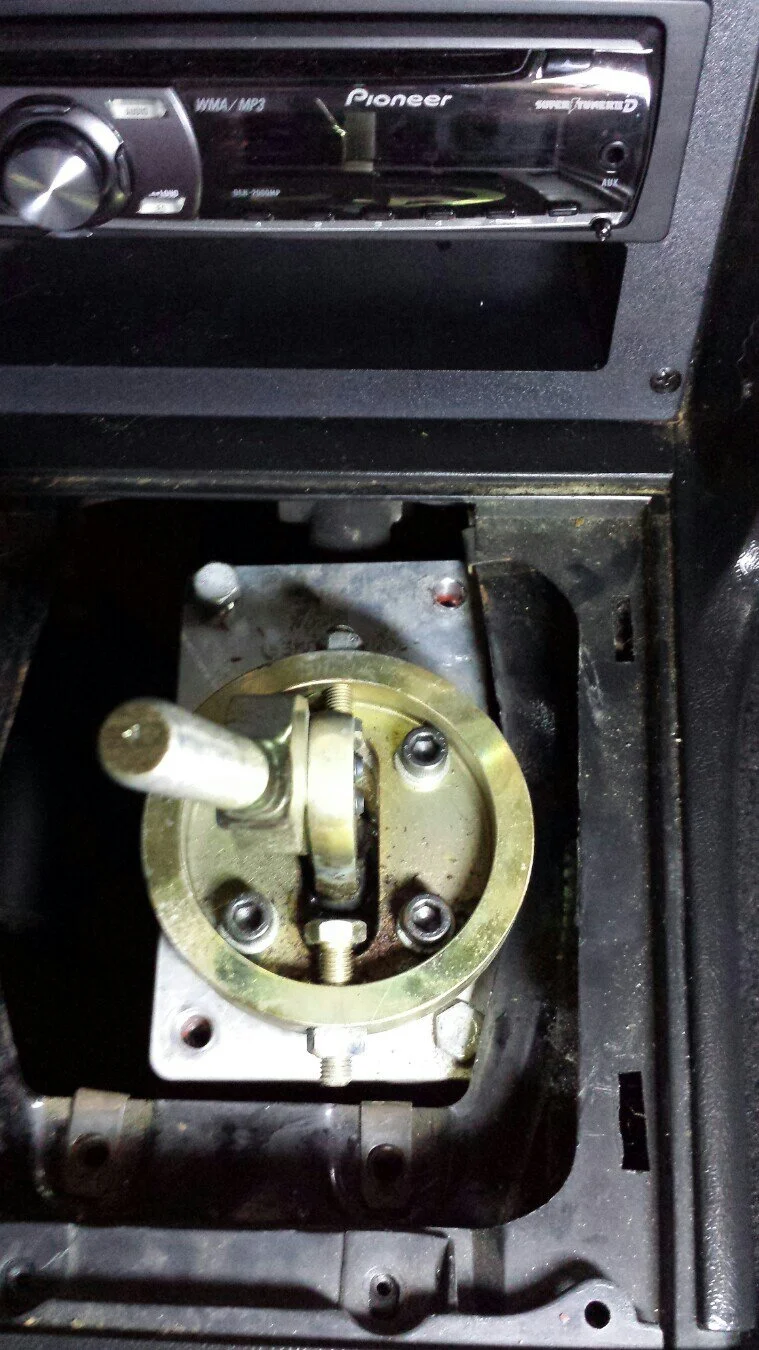

Could someone please explain how to remove the bottom right bolt of my shifter? This is the shifter to transmission bolt iirc. I installed the thing and dont remember having this problem but it is tucked under sheetmetal towards the passenger seat.

Well that sucks. I'm trying to drop the T5, I should be able to wiggle it through there as it comes down right?
take the handle itself off but leave the shifter it will come out. I have an original auto car so my trans tunnel makes the front two bolts of the shifter hidden for me and i have dropped the trans plenty of times.
