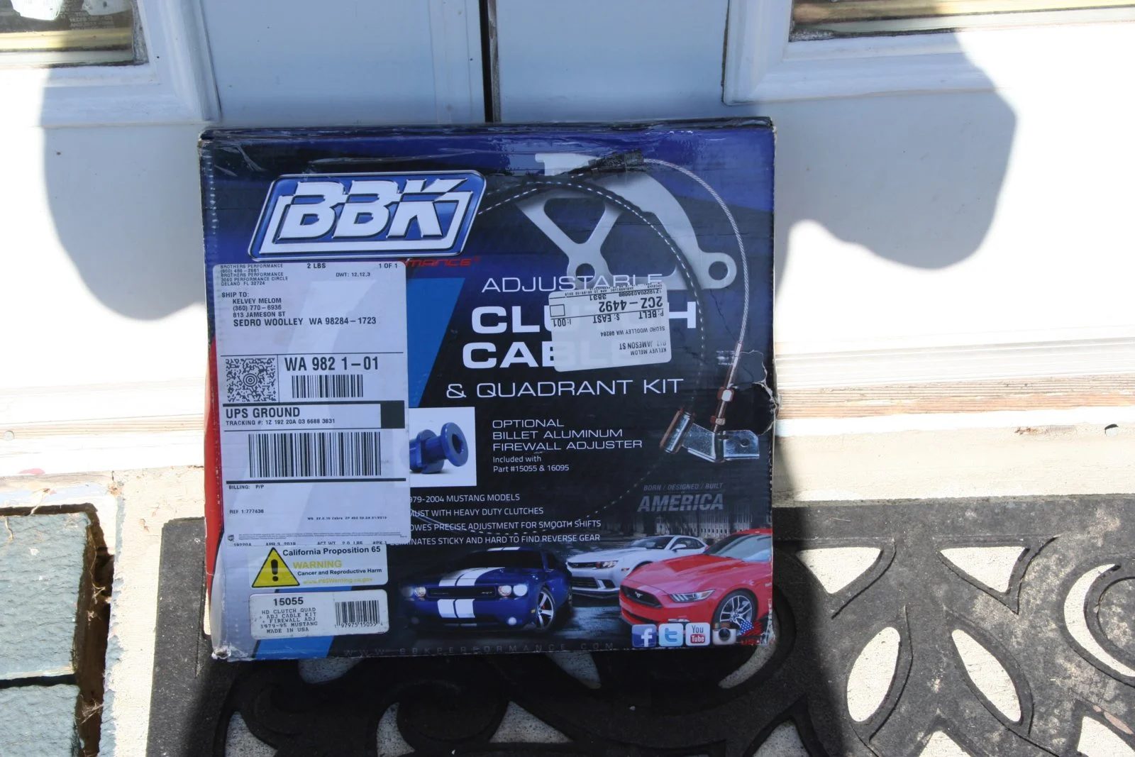

The following applies to aftermarket clutch cables and quadrants.
Adjustable cables are used when the plastic quadrant is replaced with an aftermarket metal quadrant. The downside to this setup is that you have to get under the car to adjust the clutch. Add a firewall adjuster to an adjustable cable setup and you can spare yourself from getting back under the car to make any fine adjustment that you desire.
The fancy 2 and 3 hook quadrants are for use with stock length cable and a firewall adjuster. Use the firewall adjuster and screw in and out to take the slack out of the cable and get the clutch engagement point just where you want it.

Aftermarket solutions to the problem:
The quadrant needs to be replaced if you use any type of aftermarket cable or adjuster. My preference is a Ford Racing quadrant, adjustable cable and Steeda firewall adjuster. The adjustable Ford Racing cable is just as good as the stock OEM cable. It allows a greater range of adjustment than a stock cable with a aftermarket quadrant and firewall adjuster. Combined with the Steeda adjuster, it lets you set the initial cable preload and then fine tune the clutch engagement point to your liking without getting under the car.
Using a stock OEM cable, firewall adjuster and a single hook quadrant may result in not having any free pedal travel before the clutch starts to disengage. I found this out the hard way.
